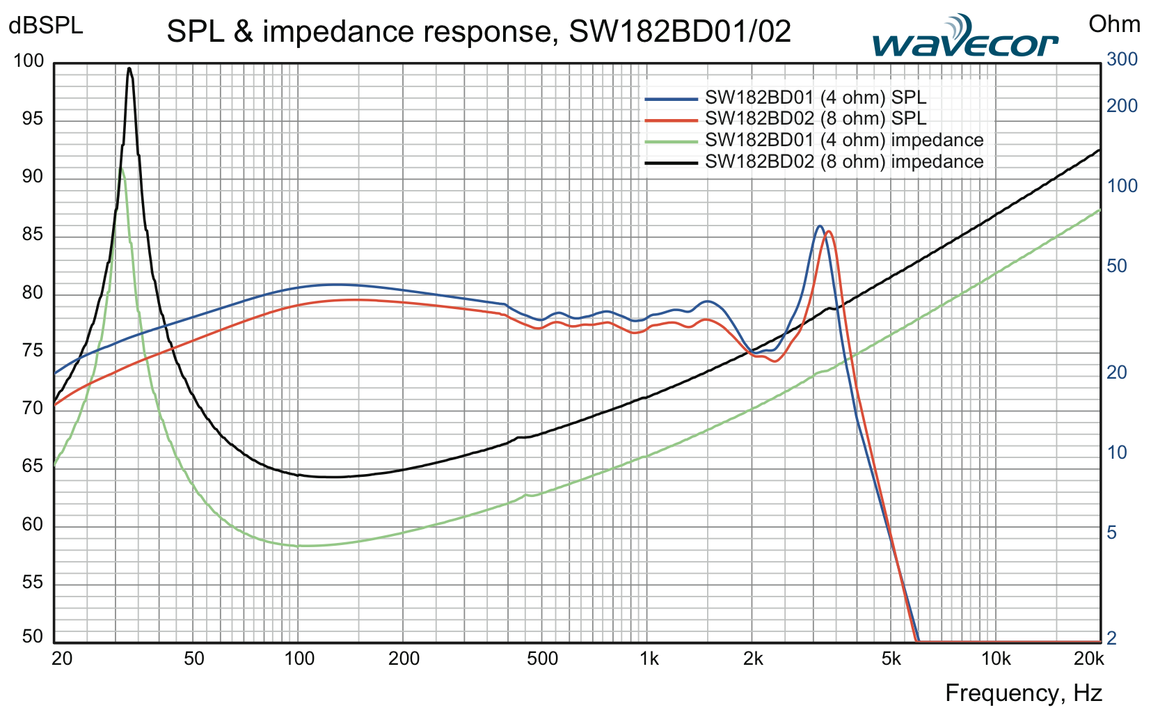

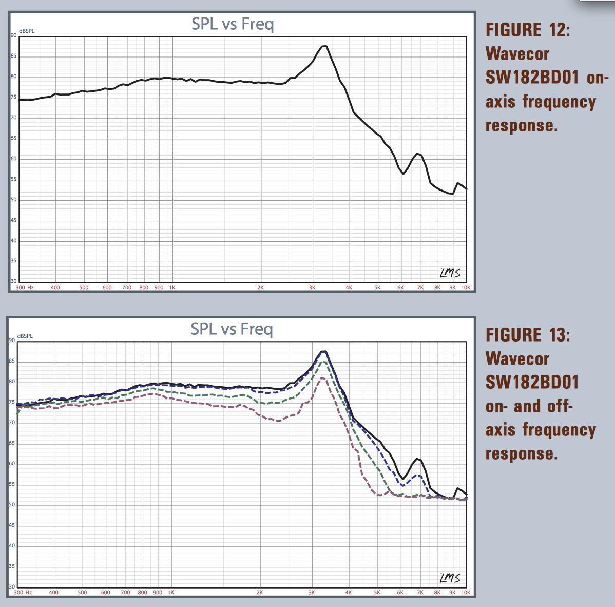

The idea seems valid, but I'd keep a back up plan - 2kHz is the highest you'd want to use that woofer. The spec shows a suspiciously benign break up at 3kHz. Did the Voice Coil review show more dramatic break up?
The DSP should work better than most other options here - a digital high order crossover would be much better than a passive low order for keeping out junk that is only half an octave out of band.
Not really. The Voice Coil FR test pretty much resembles that of the manufacturer. I have attached screenshots of both.

If that breakup peak at 3200 Hz is accurate, there will be a corresponding 3rd harmonic distortion peak when playing at just over 1000hz (actually 1067 Hz). You can use the SW182BD02 in a two-way, but best to use it as a woofer in a three-way system.

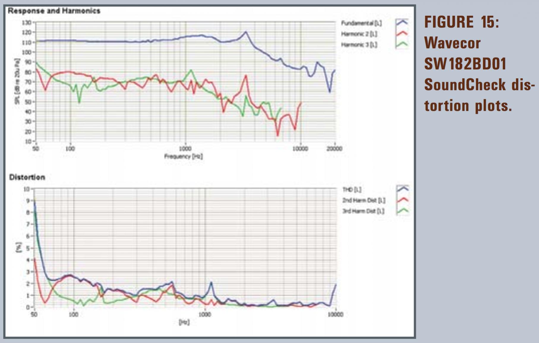

Did you see the Voice Coil Test Bench link in the first post? http://www.wavecor.com/SW182BD01_in_..._Feb._2010.pdf
I have attached a screenshot of the response and harmonics as well as distortion test. You are right, there is a small peak in 3rd harmonic distortion of approx. 2% around 1.1kHz – is that good or bad? I’m no export in interpreting distortion plots. However, I do have faith in Vance Dickason when it comes to loudspeaker design 😉 When he says that “a crossover frequency as high as 2kHz is certainly possible” would you still advice against it?
Anything near 1% would ordinarily be bad.. BUT,
VC's non-linear distortion testing is at the driver's limits.
If the driver was only being tested around 1 watt 1 meter, I'm sure the distortion would be much lower - qualifying as good or even excellent.
Most of the Wavecore driver's I've seen really only have problems below the driver's resonance where it's riding almost entirely on the spider - basically the bottom octave for any design you do. This doesn't make it a great speaker for lower freq. bass boost (..even if it represents as having good linear excursion).

Soren, the harmonic distortion plot you posted is at a fundametal sound level of 110 dB, quite loud. As Scott mentioned, a much lower level is more applicable for most home listening, in the 85 to 95 dB range. This would drop the 2% 3rd harmonic for 1100 hz, which is quite high. 0.5% (-46dB) or lower distortion is a reasonable goal for 3rd harmonic. With 3rd harmonic desired at a lower level than 2nd harmonic.
No, I had not seen the harmonic chart that you posted. What I ventured was purely predictable. Undamped rigid metal cones that have the fundamental breakup peak also have the 3rd harmonic distortion peak at 1/3 the frequency. Some people are more sensitive to this 3rd harmonic distortion peak than others.
Years ago, before all these harmonic distortion plots were available, really before SoundEasy loudspeaker testing and crossover design software was available to the public, some people had issues with where magnesium or aluminum coned woofer were crossed over. They couldn't explain their observations, just that the speaker sounded better with a lower crossover. This happened in particular with the magnesium coned Seas W18EX001, where many applications crossed it over around 2 kHz. I remember some (with golden ears?) said that it sound better crossed over no higher than 1200 or 1400 Hz. Come to find out years later when the harmonic distortion plots were published for the W18EX001, there is a big 3rd harmonic distortion peak (-42dB) for the 1700 Hz fundamental. The fundamental frequency response had the tell-tale corresponding big breakup peak at 5 kHz.
