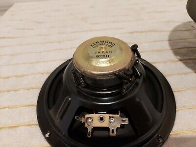

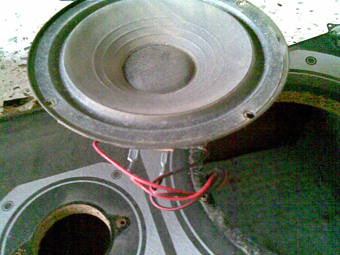

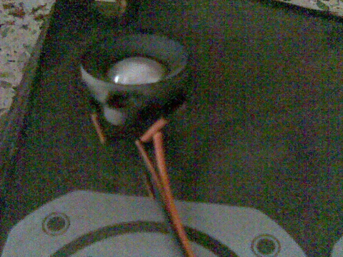

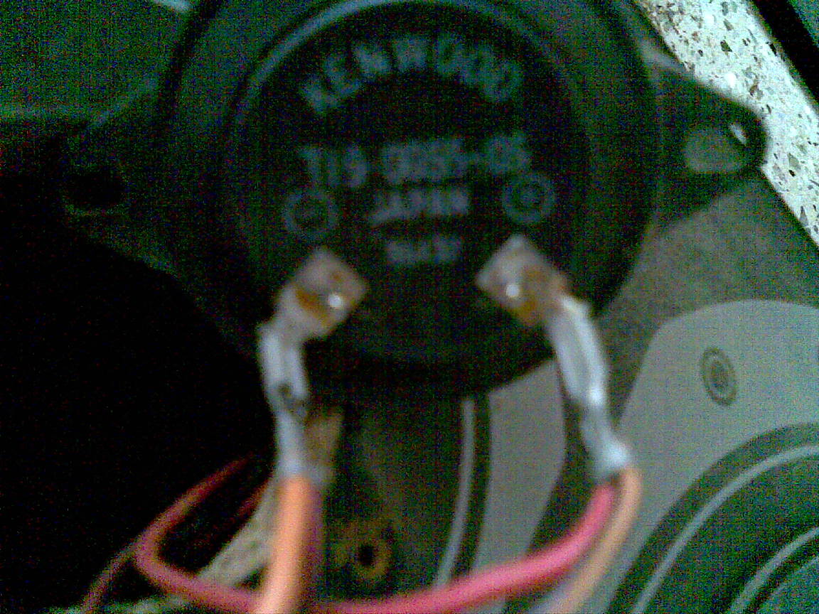

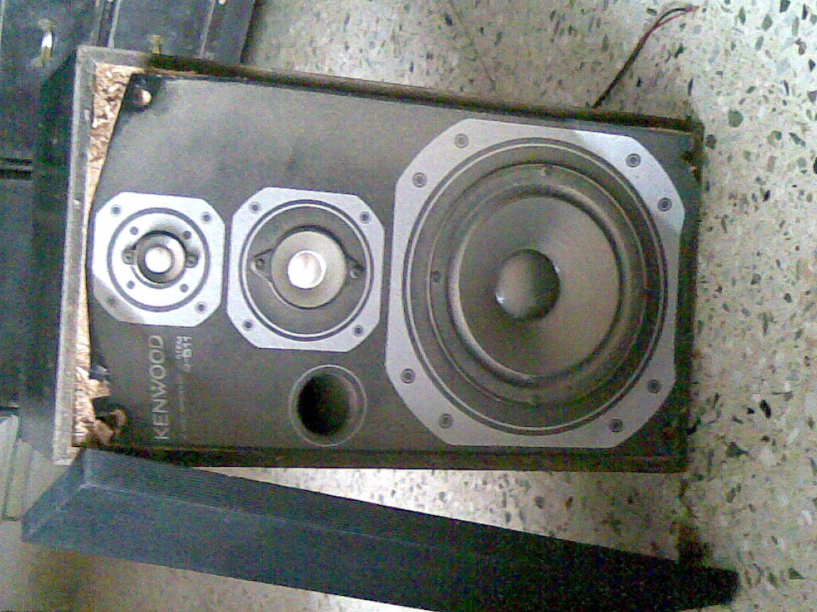

Can you take pictures? f you can do so please post pix of the drivers showing front and back. AFAIK there are no Kenwood woofers with magnets that small that could handle 70 watts so that must be a total systems rating for maximum input. There must be some XO in the old box and it may be a tiny capacitor soldered straight to the tweeters input.
No; you can't use the Peerless specs for the Kenwood woofer. For tweeters the minimum recommended is usually the Fs *2 using a 2 element circuit, at 2 octaves above resonance you can use a single capacitor, so 5000Hz + maybe.
Pictures really help tho, otherwise I am just guessing

You absolutely need a crossover, you risk to damage your amplifier when the three parallell drivers may reach very low impedance. The tweeter needs protection from bass-signals.
If you cant measure the drivers performance it will be very hard to get a good result. There are ready-made crossovers to buy but they are not made for your drivers and your box.
Maybe a new diy-build using your Peerless driver and a good tweeter would be better choice.

I can confirm that Kenwood S-511 is without a xover.
The woofer, mid and tweeter are connected in parallel.
Since, it is without a xover, I was thinking of a electronic xover. Yes max input is 70 watts.
I have attached pics of s-511.
I was wondering, if I can get program for frequency and imp. measurement from frd consortium. I am getting error from pvconsultants.com
Thanks in advance
