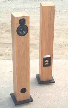

many many of the good simple 2-way high end speakers use such a crossover as well. can't name them all off the top of my head but Meadowlark and Audio Concepts comes to mind. NSM Audio as well, again with maybe just a resistor on the tweeter to match the output level to the woofer. i'm currently reviewing the Windjammer speaker by Role Audio:
http://www.roleaudio.com/windjammer.html
one resistor, one inductor, and one cap. maybe two caps actually, but the 2nd one is just a small bypass for the larger one. not sure where it's crossed over but i think around 3khz. i don't recommend a xover point much higher than 3khz with any woofer larger than 4" as you'll get into the cone breakup range. the 4.5" woven carbon fiber driver and compact 1" soft dome (really tiny neodynium magnet) in this speaker sound excellent, and they are both shielded. very nice speaker.
