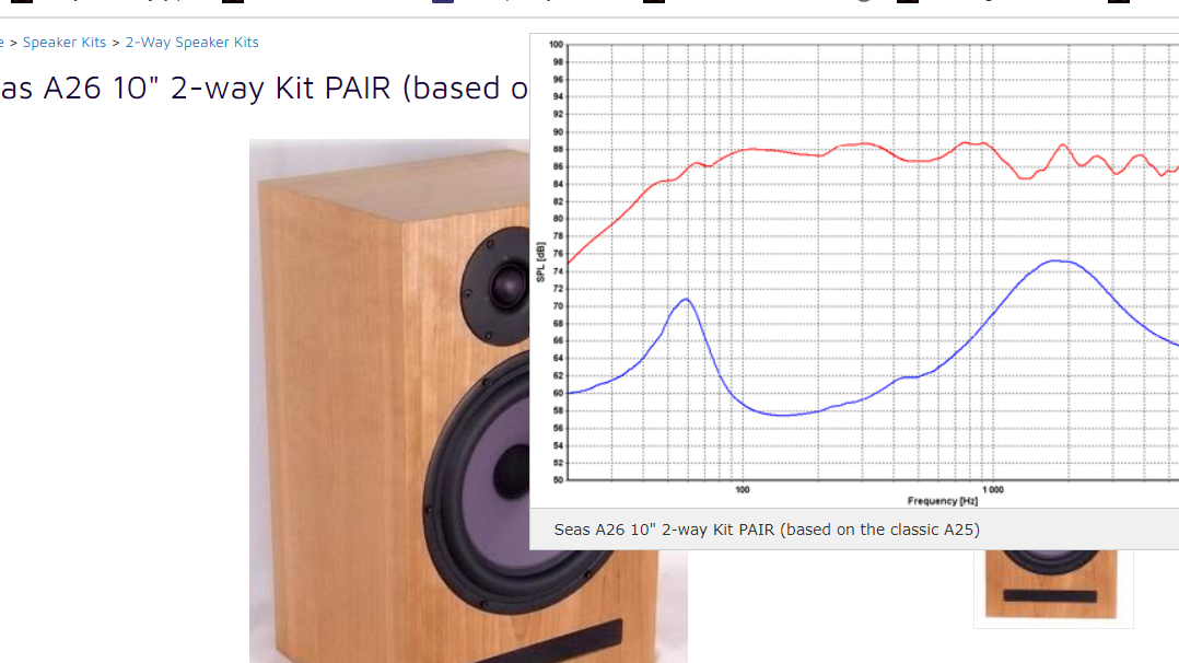

re 8" and dome HF 2 way. A really good builder I follow favors that combination. He might call eight inch two ways the magic combo. As did many speaker makers where I am from. Companies like Paradigm, who made several stand mount 8" x 1" domes, and 8" 2 ways larger floor speakers. So did sound dynamics. There are a bunch employing 8s of theres also energy. Maybe 8's are the happy medium. Although Dynaudio made 10s work with theyre all too popular 10" 2 way. I happen to be interested in the resurrection a26 over at madisound..
Off the top of my head,
Generally, a 10" mid-woofer will start beaming at 1,500 to 1,600 Hz
The bump is near 1,300 , same one the a26

10 dB spiking on an awefully smoothed plot......
Copper cap is nice, as is the created flattish z curve making easier x-over.
People love their a26 kits.....

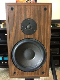

I had a pair of Yamaha NS-5 with 10" woofer and 1" dome tweeter, sealed enclosure. Liked the sound of them a lot! Good luck on your buildI was looking to build a simple 2-way speaker similar to the BR-1 kit on Parts Express, but instead of the 6.5" woofer, use the 10" DC250-8 in a sealed box. I am familiar with the 6.5" DC160-8 and while I think it is a quality woofer, I am looking for a bit more bottom end without porting (for better transient response).

NS-5 ?I had a pair of Yamaha NS-5 with 10" woofer and 1" dome tweeter, sealed enclosure. Liked the sound of them a lot! Good luck on your build

The NS-5 I speak of was the first one, in the 70's...two-way...10" woofer 1" tweeter, no midrange. Yamaha reused the model number

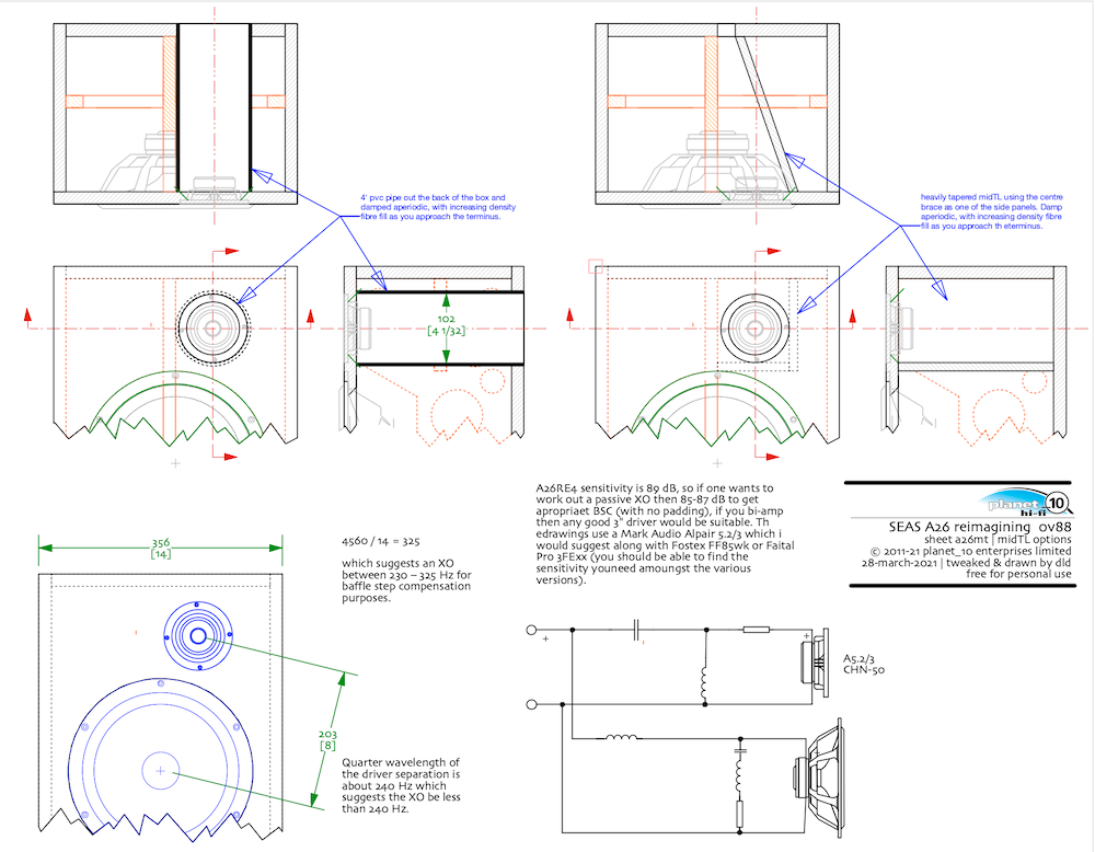

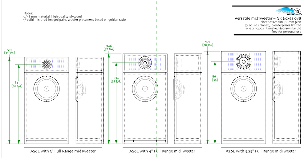

I have a partially finished drawing of an A26 variant with small FR, i'd use A5.x as the example. Looks like i got further than i thot, actually did more than 1. i need to finish these off and add them to the planset.
MidTweeters in an aperiodic TL, larger mTs if you wish to push things to higher levels.
As far as dispersion, cone shape and dustcap make a significant difference.
