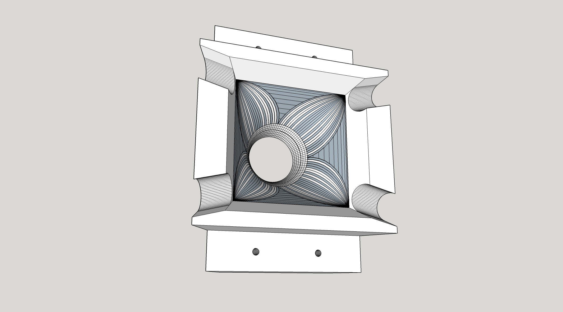

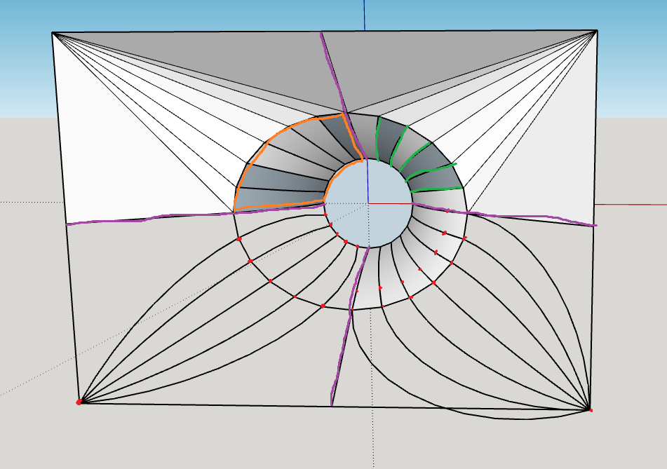

Here is an example of a throat for a 60x60 horn I've been and am still working on, in Sketchup no less. Where the CD attaches, a tangent to the front to back curve of the throat matches the internal cone of the CD. At the other end of the throat, at the mid points of the sides, the tangent is at 30 degrees, the half angle of the horn flares. From the mid points to the corners, I've drawn 3 point arcs with two points being on the throat and the 3rd pointing being in the corner itself. This is a big improvement over what I showed back in November. The primitive straightline corner fill I had then would have been a diffraction source.
The idea is to 3D print this piece and finish the rest of the 60x60 horn with plywood. This drawing has some 1/64th inch scale defects in it but they can be repaired at the makeprintable website, for example. This would cost about $100 to print so I'm looking at printers...

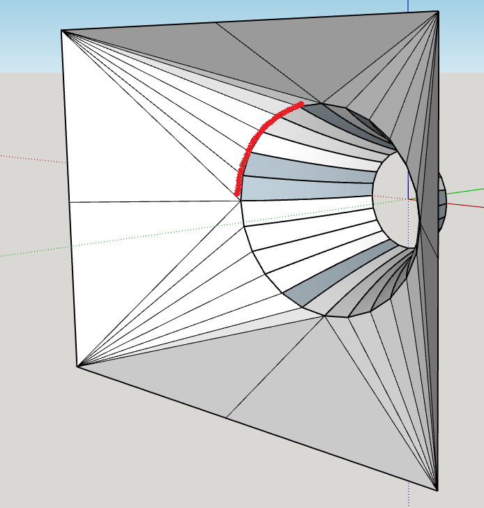

I tried the primitive round to rectangular transition first. I think difraction would occur on the red marked part...
What do you mean by "two ponts at the throat" (regarding the three point arcs).
What is the Problem with rond to square before exit angle matching?

Yes, I agree that diffraction would occur off the edges you've marked in red.
I see that in your throat, going front <> back behind that marked edge you have straight lines, ostensibly matching the exit angle of the CD. Those straight lines should be curved arcs that just come tangent to the exit cone of the CD where the CD attaches.
The other ends of four of those arcs should come tangent to the horn wall where they touch the horn walls. This occurs in 4 places - on the midpoints of the horn walls.
What do we do about the front to back arcs in between those points of contact? Extend them continuously into the closest corners.

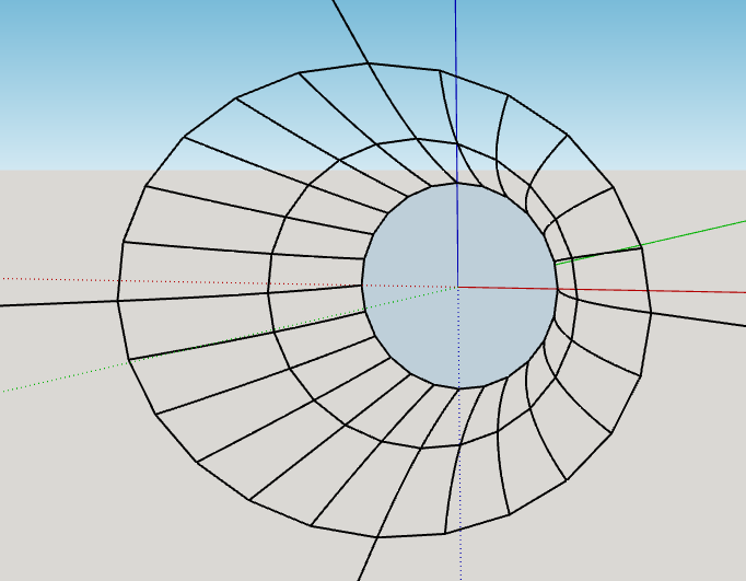

If you are using Sketchup and you zoom in you will see that Sketchup draws each arc as a series of straight line segments. Pick a segment endpoint of an arc several segments deep into the throat as the first point of your 3 point arc. Pick the endpoint closest to the throat as the second and pick the corner as the third point to use the 3 point arc tool to extend the throat into the corner. Experiment on first point choice and location of corner. If the corner is too far into the horn this method might not work.
How do you define and draw those arcs? In the last picture I showed some number of posts ago I defined it graphically/geometrically by the tangency requirements. I then took a look at the OS spreadsheet that I think you can download from BWaslo's thread and found my graphically defined curve was within a few hundredths of an inch of the spreadsheet curve, as far as it went.
Once you've drawn the curve, convert it to a surface by drawing a line between its ends and then use the follow me tool to trace it around the 1" circular CD entrance hole to create the 3D surface.
The 4 lines (PURPLE) crossing the midpoints and going to the CD exit are completly correct! (tangent to both, horn wall and cd exit angle)
To get from the ends of the green lines to the Horn is were my problems lie.
On the rigth I tried 3 point Arcs to go from the ends to the corner. (Points in RED)
On the left I tried 3 point arcs from the CD Exit to the corners. (Points in RED)
Rigth has some problems due to the horn beeing rectangular...
What should I use? (+ anything else to try)

Are you talkin about the CD exit angle matching? Because I have allready done it and it is correct... (Orange)
But how far should it go; how deep into the horn should this curved throat extend before converting to square or rectangular? I've been doing some Axidriver sims to shed some light on that. My sims show that .3cm is at least marginally better than .4cm or .2cm. Too short and the HF suffers. Too long and the on axis null gets worse. The on axis null should only be an artifact of the axisymmetric simulation. It should not be a problem with a rectangular horn. It may be a problem with square horn but less of a problem than with a round horn. So take my .3 cm recommendation with a grain of salt; it might all come from the axi symmetry.
(Does anyone know how much on axis null to expect in square horn vs round?)
My Exit angle matching is 3cm long. (you stated one 3rd of the distance to the mids)
Should it really be just 0.3cm?

I can certainly see the curvature in your sketchup model. Your front to back arcs seem to start from the CD exit and go all the way to the corner. You have a circle at the CD exit and what appears to be an ellipse out where you start to transition to the rectangular cross section. I would have put a 2nd (expanded) circle about 6 mm in from the CD exit to force the throat to stay round that long and then started my arcs up into the corner from here. You have some issues with the longest arcs, those closest to the wall midpoints. Am I correct that your that the aspect ratio of your ellipse doesn't match the aspect ratio of the horn? Should it? I would try that to see if it worked better - had fewer issues at the edges of each quadrant.
The Draw Bezier Surface from curves works most but not all places. Sometimes you need to select ruled rectangle instead of ruled triangle. Sometimes you need to break up the curves into sections and then surface individual sections as I did in the lower right quadrant. If all else fails start drawing lines to create triangles.

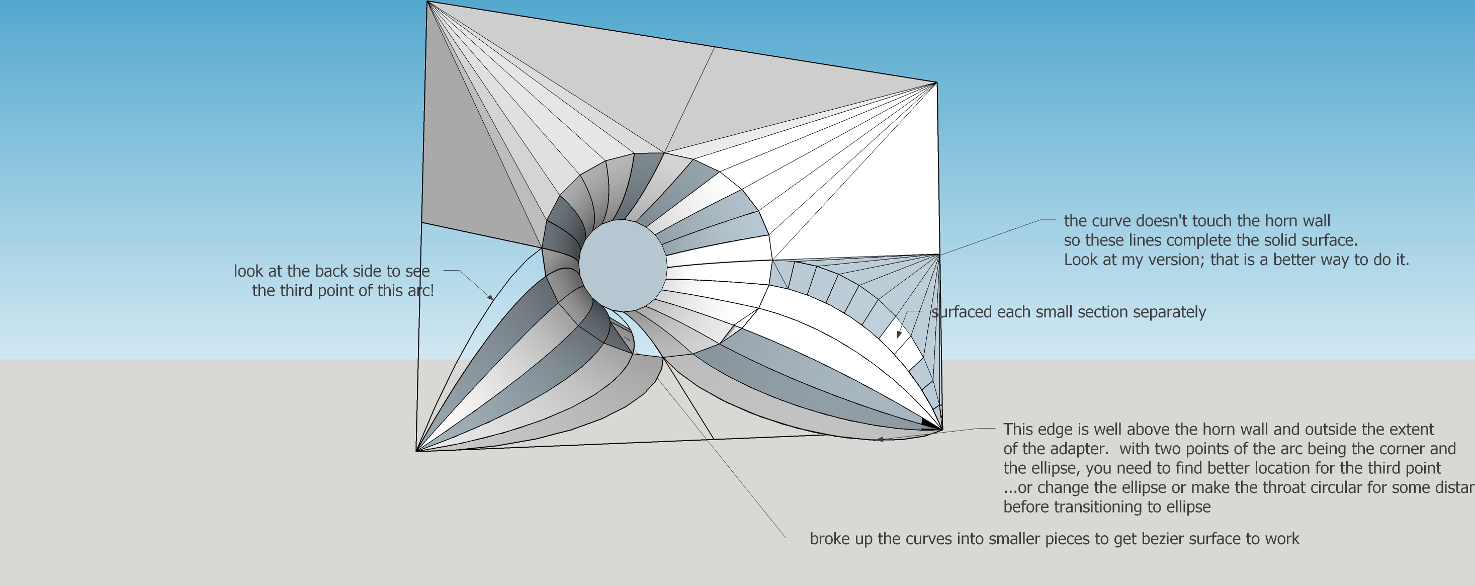

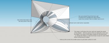

I commented your drawing and am sending it back. I hope this gives you some ideas as to how to proceed. You need to do more of what I have been doing - trying different things to get better results.
attachment.php
This "hacking" and manual surface creation takes a lot of time. You can work on just one quadrant, make a group out of that quadrant, then cut and paste and rotate into the other 3 quadrants to save time.

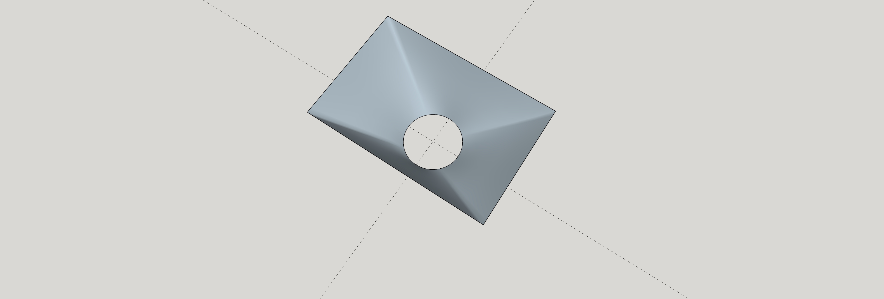

Found a lofting tool for Sketchup. It seems just what the doctor ordered for this problem
Organic modeling made simple with Curviloft | SketchUp Blog
I haven't tried it yet; still reading the tutorial. Even has ability to be guided by intermediate profiles and to respect tangency.
well half an hour to get through the installation help video then 1 minute to produce a trial loft.
attachment.php
What I need to do instead of lofting from a circle to a rectangle as I did for the trial, loft from the top of my round exit angle matched throat to the rectangular bottom of a 90x60 horn...and get it to respect tangency....but its already late here
That tool is awesome, but as you said, the tangency is a problem. I tried almost every function, but could only get a 90° orientation to the end surfaces...
