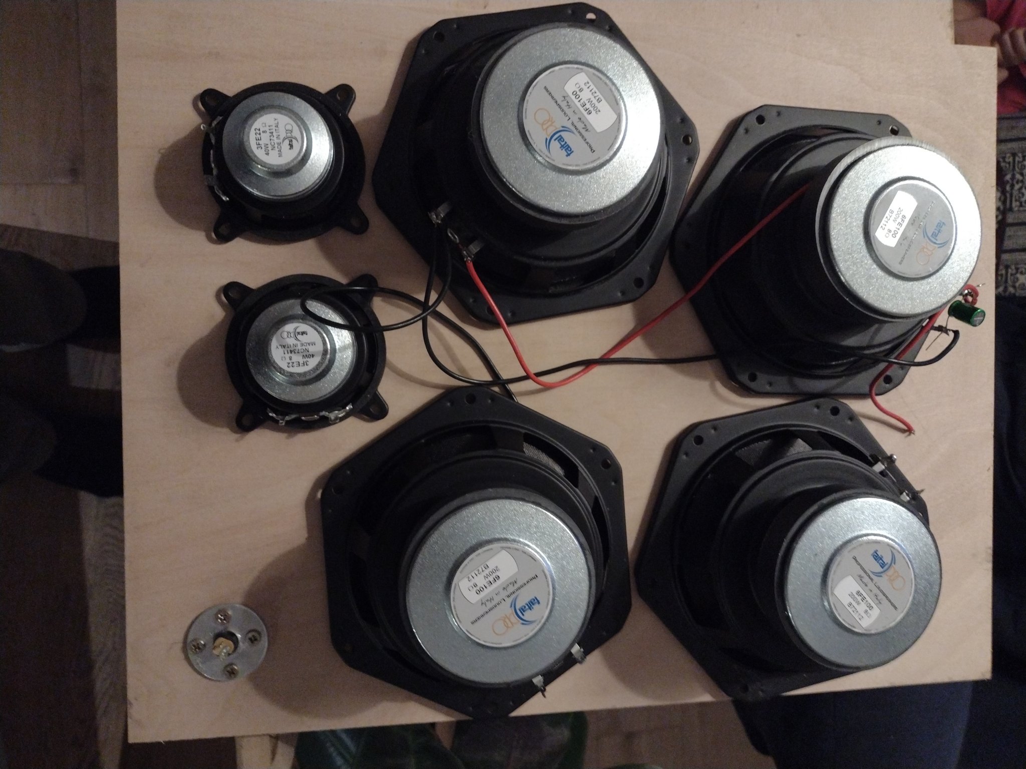

Art's (weltersys) suggestion of using the pinwheel arrangement was to keep the injection ports as centered as possible to the speaker cone, so that it wouldn't cause the cone to 'rock' at high excursion levels. Given that this is a Hi-Fi application I doubt I'll have that issue, but it was a good principle to follow 🙂
He most recently documented it here

I can take some!Interesting i like it. what are the dimensions of each box and do you have pics of the rear..?
I'll also do some pre-eq measurement this week 🙂
I'm almost finished making a similar pair of two way synergy using 3fe22 and faitalpro 6fe100.
60x40 with built in Bluetooth class D amps in.
The little faitals really shine horn loaded, I used the ferrite version during some of my testing and the neo versions do seem to go higher, over 2k. I'm experimenting with passive crossovers ATM, but I think they will ultimately benefit from a minidsp, the 3fe22 do sound great but the fr isn't all that flat, even excluding the 10+dB drop as the horn loading drops off.
Adding a compression driver of good sensitivity from ~1500hz would be a nice way to keep efficiency high.
Even with only 2 X 6 inch drivers a side I'm getting -3db in the 60s. Have the ports to add 2 more per horn if I think the £88 is worth it. The port size makes such a dramatic effect on bass extension and distortion.
