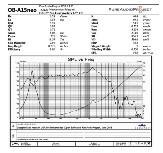

Deltalite Qts seems to be too low to be used for OB applications. Or did I miss some detail?
Well look at that!
Here's the Eminence Deltalite 15, $340 a pair : https://www.parts-express.com/pedocs/specs/290-595--eminence-deltalite-2515-spec-sheet.pdf
Here's the Pure Audio Project OB 15 Neo Cast Woofer, $570 a pair : Audiophile-grade 15" Open Baffle Woofers
The latter appears to have a shorting ring that the former lacks, along with a higher Re, QMS, QES and QTS
Basically all the changes you would make to extend the high frequencies while also modifying it to work better in an open baffle
