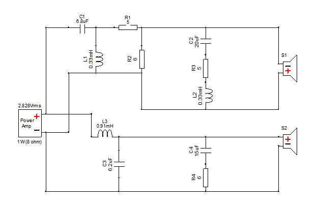

Crossover modification

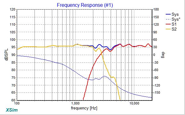

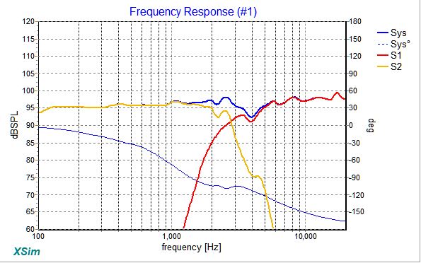

Albert (albertli), Eric (erics84), and anyone else interested, I have a crossover modification that only requires changing 3 parts for the 1.38TW: The capacitor changes from 6.2uF to 6.8uf, the inductor changes from 0.91mH to 0.33mH, the series l-pad attenuator resistor changes from 3 ohm to 5 ohm. You can try values ranging from 4 ohm to 6 ohm depending on your preference. I am using 5 ohm. I had a few people comment that the speaker is maybe a little bright for certain types of music, so the change. This modification does flatten the response compared to the original.
I have attached the crossover model for the original vs the modified version. I just moved to Florida and all my test equipment is packed up so I have not been able to do a live test, but I like the results.

Glad to hear that you are still listening to the speakers. I've been using my Altec 604s lately, but since I moved after I retired there's no room for them so I'm now using the towers again. I'm looking forward to hearing what your thoughts are about the mod. I've been meaning to do this change for quite a while.
Depending how this goes there is another approach. The woofer output above 2k is probably a bit thin, wouldn't register as much off-axis, if it did it could be notched downward and the tweeter brought in to cover it.
The parts came in today and I've made the swap with 6ohm resistors I also have 4.7 in my hands but I opted to give this a try.
I never really felt like the tweeters were harsh before, but now I hear a definite reduction. Maybe I wasn't bothered before because I worked at a shotgun range as a teenager, but the few songs I've managed to play (at lowish volume due to a newborn in the house) give markedly less fatigue. I'm definitely happy with the change so far, but I won't be able to do a true test for a little while. I'm looking forward to turning it up to 11.
Thanks Scott for following up with this design.
Your welcome, I'm glad that you are hearing a positive result. I also listened to 6 ohm a while before changing to 5 ohm. Looking forward to your impressions after you have listened further.
Congratulations on your newborn, all the best.
