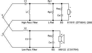

Purchased 2 way Peerless DIY bookshelf system from the web. Construction first class but find the system harsh especially in treble area/higher freq. Would like some advice on upgrading ie tweeter/crossover design etc.

Wow, it's unreal how much those speakers are equal to the pair of bookshelfs I built. There are a couple differences:
I use 2700Hz butterworth filter instead of bessel.
I use the non-ferrofluid version of the tweeter.
Either way, I thought I would help out a little by posting my crossover schematic. If your tweeter uses a simple L-pad for the attenuation, all you need to do is change 2 resistors to lower the tweeter level to something less harsh. I use 5dB of attenuation on the tweeter.
2-Way Crossover Network
Low-Pass (LP) Filter: 1 required
Type: 2nd-Order Butterworth
Desired Corner Frequency: 2700 Hz
High-Pass (HP) Filter: 1 required
C1 = 6.8 µF, Polypropylene, 0.0003 ohms
C2 = 5.1 µF, Polypropylene, 0.0002 ohms
L1 = 0.51 mH, Air Core(#16), 0.33 ohms
L2 = 0.68 mH, Air Core(#16), 0.38 ohms
Tweeter
Impedance EQ
Req = 6.8 ohms
Ce = 2.1 µF
L-Pad: 5.00 dB
Rp1 = 2.407 ohms
Rp2 = 7.067 ohms
Woofer
Impedance EQ
Req = 7.5 ohms
Ce = 22 µF
