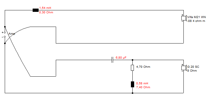

I checked the crossovers on the TM 55 and i found a fairly simple circuit: one coil acting as a first order low pass filter for the woofer and one HUGE 7uF KP capacitor used as a high pass for the tweeter. Another small coil with a 4,7 ohm resistor in series is connected in parallel to the tweeter, maybe some kind of impedance correction?
So what we have is a very simple crossover, so lets check the values of the coils and simulate the speaker using boxsim for the sake of fun and learning!
Basic Measurements
I started with stripping the crossovers apart to measure the parts values using the simple GM328 Tranistor Tester. The big coil connected to the woofer measured 1,5 mH and the small coil parallel to the tweeter 0,58 mH. So the crossover design looks like this:

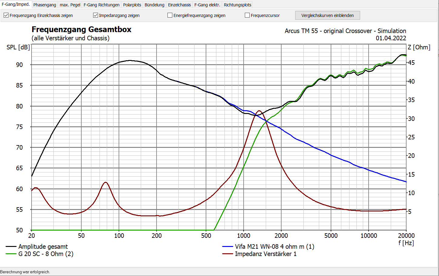

I searched the internet for TSP and SPL graphs for the Vifa M21 WN-02 chassis and the Seas H174 1“ dome tweeter. I used REW to measure the impedance vs. Frequency of the chassis . With Vituix CAD i converted the graphs to asci text to make it usable for boxsim. With this data I created a first, approximate model of my 2-way speakers:
First Simulation Results (Original Crossover Design)
The frequency response graph of the first simulation showed me why this speakers sounded quite recessed in the midrange. The graph shows a bass peak between 50 and 200 Hz combined with a huge dip between 300 and 3000 Hz. The highs above 4 kHz are obviously too loud compared to the rest of the frequency spectrum.
The crossover point seems to be at approximate 1500 Hz – one third of the claimed value in the datasheet. This results look quite disappointing regarding that Arcus was a big name in the German Hi-Fi market in the 1980s.
