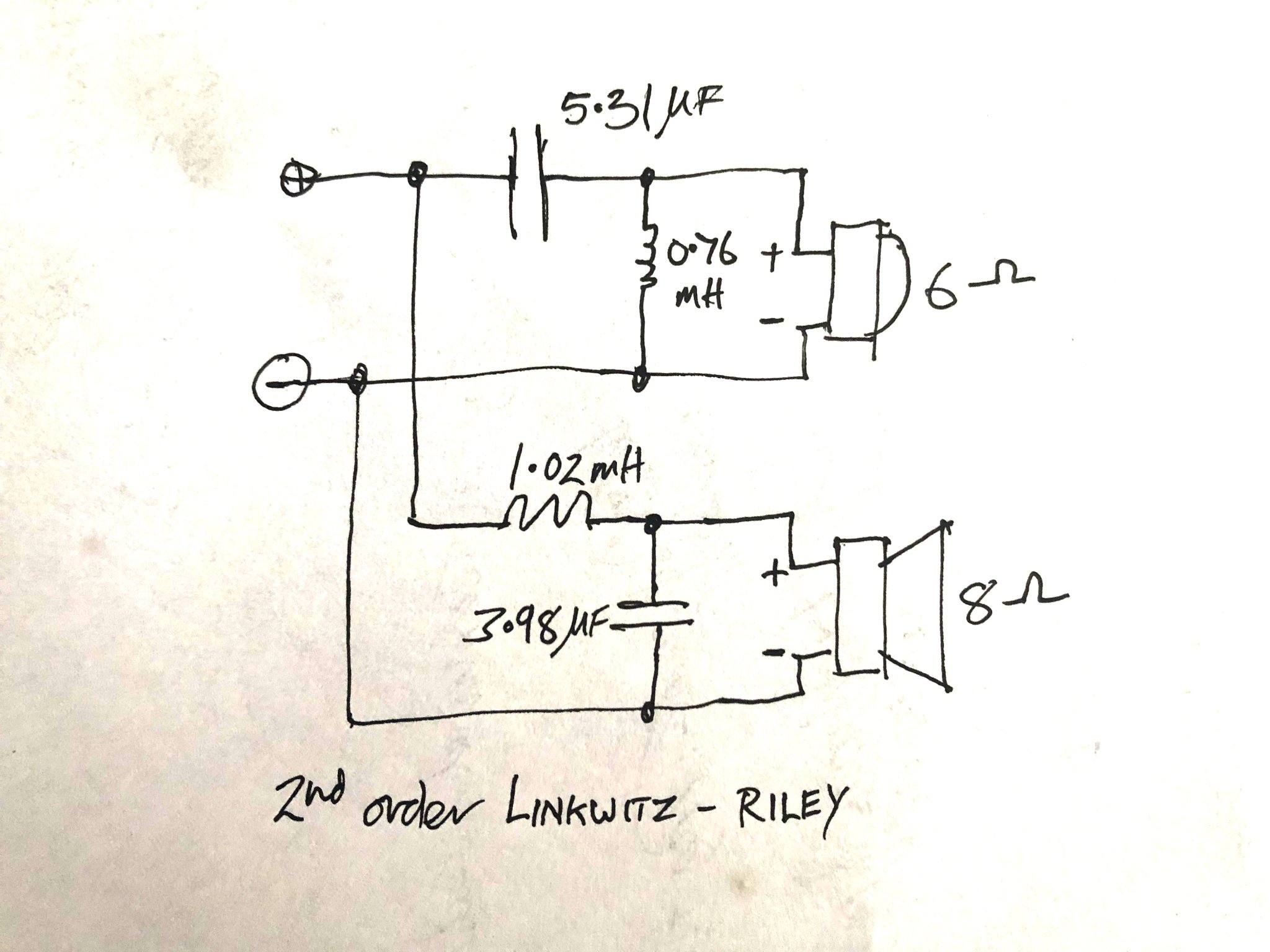

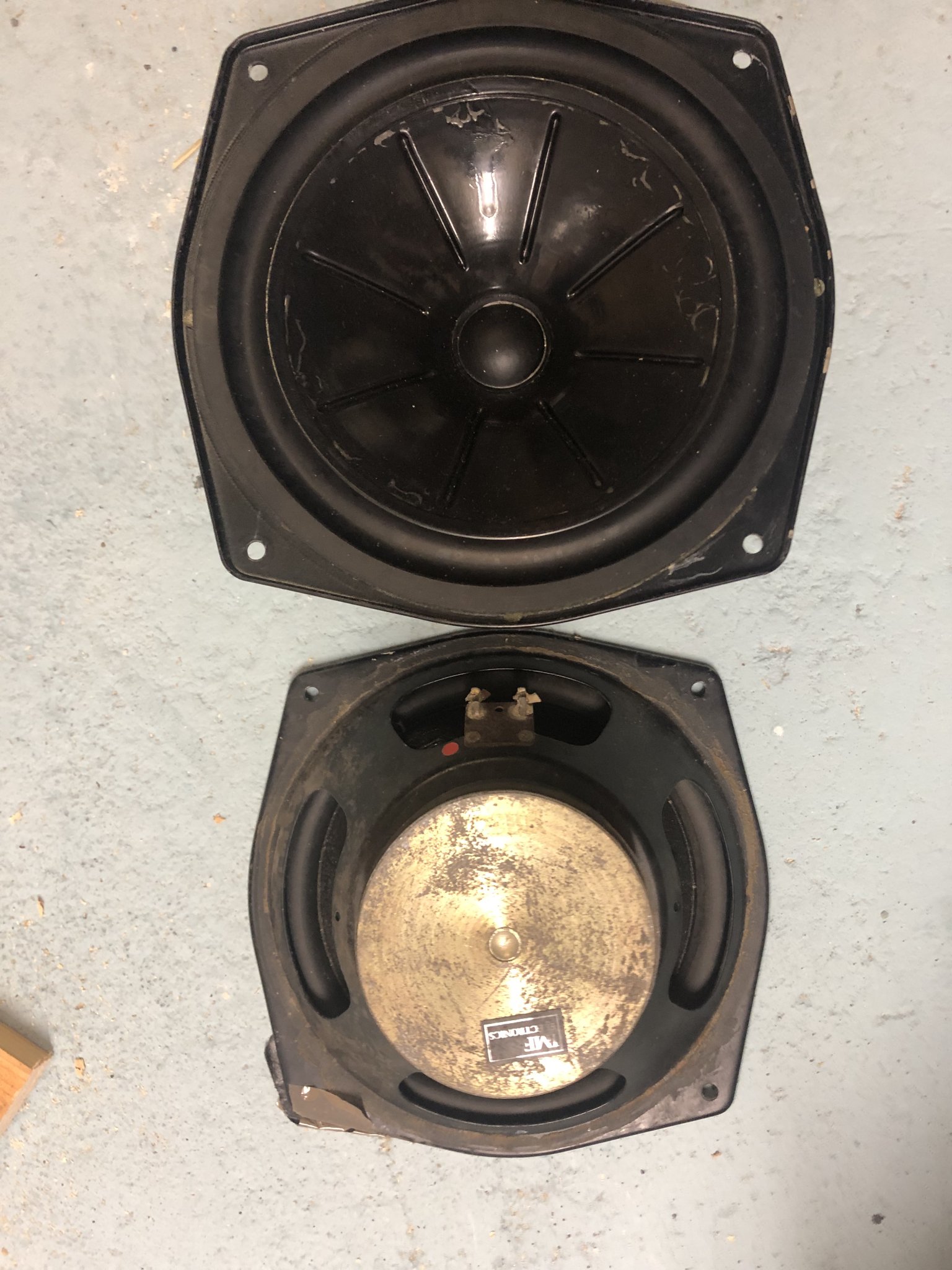

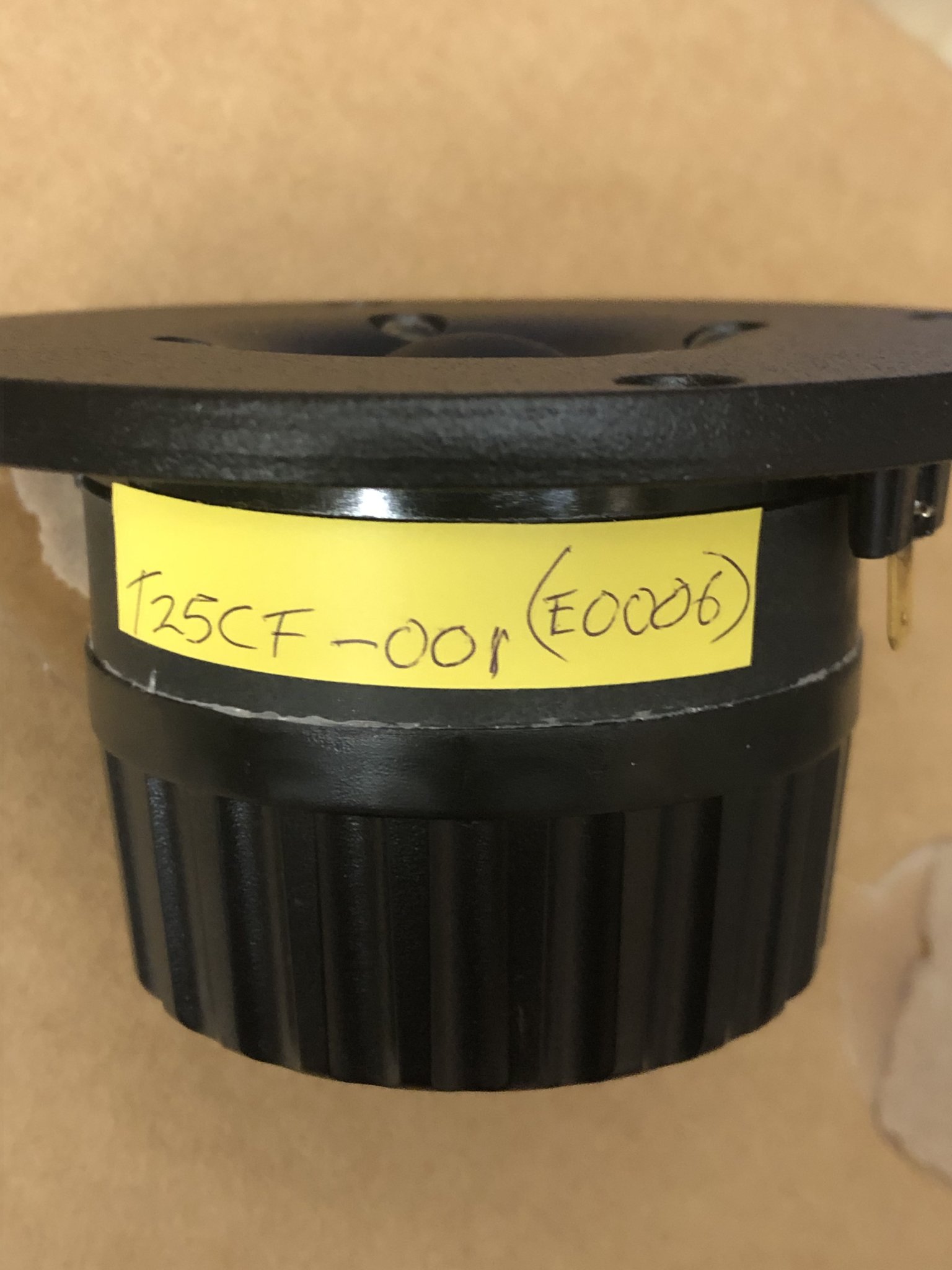

I am in the process of designing a 2 way speaker using a couple of pairs of drivers I have , considering a transmission line format.

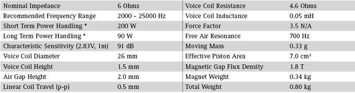

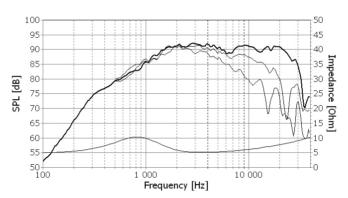

The speakers are two SEAS T25CF-001 and two old IMF mid /bass units which have a 7in cone inc rubber surround. The SES is 6 ohm and the IMF is 8 ohm looking at a crossover of 3000hz, 2nd order Linkwitz. Dont have any specs for the IMF
have attached a crossover diagram as a starting point.
would appreciate any feedback, t
