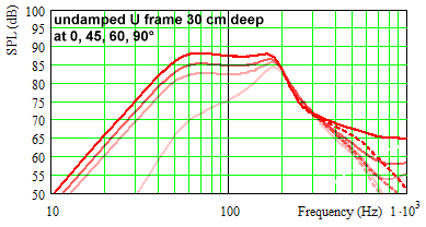

When undamped U frames reach their resonance frequency, they have turned from a dipole pattern to an omni pattern. You need to damp U frames to avoid that. A U frame with 30 cm depth has its resonance at just below 200 Hz. Perhaps you would be better off with less depth - maybe 20 cm. But this might already give stability problems with stacked SLS12 drivers. Thats one of the reasons why I prefer H-frames with 15 cm depth to either side .

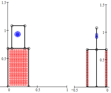

1.

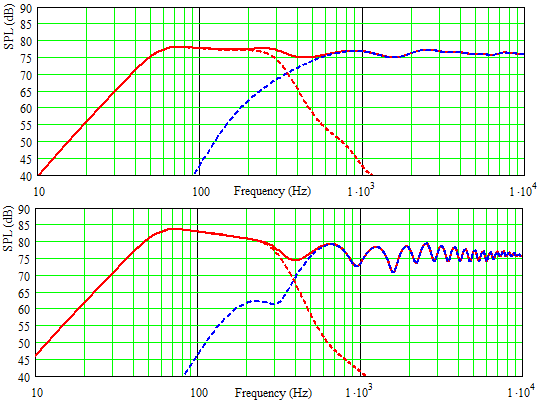

You can give up a bit of the power of two SLS12 by putting them on a very slim open baffle. This allows to move the crossover up to 500 Hz to meet the CHR-70. When the CHR-70 has no duty below 500 Hz, you can have a smaller baffle for that driver with less pronounced dipole peek and dip.
Below are simulations for free air and for floor mounting. Note how the high crossover perfectly avoids any deep floor bounce cancellation (Allison approach). Crossover values would be 8.2 mH and 100 µF for the low pass and 3.9 mH plus 22 µF for the high pass.
Simulations are for 3 m distance to get a valid floor bounce situation.

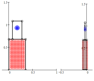

You can use a single SLS 12 in a H frame. I will come along with a simulation of that later today. Don't expect any coil >12mH.
This is the single SLS 12 in a H frame.
Again simulations are presented for free air and floor based situations. The crossover point is lower, but still no deep floor bounce cancellation. Crossover values are 12 mH and 150 µF for the low pass and 5.6 mH plus 47 µF for the high pass.
Simulations are again for 3 m distance to get a valid floor bounce situation.
In the low pass we had 8.2 mH for the parallel drivers and now have 12 mH for the single driver. The drivers in series would need ~20 mH. The values are somewhat inversely proportional to the Re values of the combined drivers.
