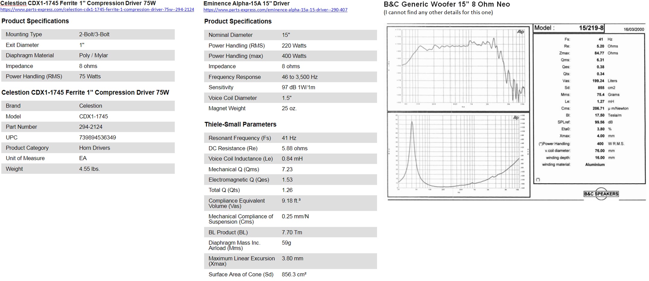

I'm new to speaker builds etc., however, found a compression driver at a sale i.e.: Celestion CDX1-1745.
I'm planning on building a small PA system for guitars, keys, bass and vocals etc. I was wondering what would be a suitable woofer to mate with it. One that came to mind was the Eminence Alpha 15A and the other was a generic B&C. Any advice would be of great help.

Celestion CDX1-1745 Ferrite 1" Compression Driver 75W
Eminence Alpha-15A 15" Driver
B&C Generic Woofer 15” 8 Ohm Neo
(See attachment)
Attached are some details for the drivers.
Thanks in advance for all the help.

- Great sound quality (least distortion etc.) and dynamics
- Freq range from 40-20k at least
- Two way speaker only
The following questions come to mind:
- Should I be indifferent between the woofers listed below?
- Would both woofers be capable of an open and closed baffle design?
- Are there better woofers at the $100 price point?
- What would be the best crossover point 2.5k or 2k for either of them?
- Can a crossover be eliminated completely, by using a low/high pass filters using capacitors and resistors only?

Off axis response of the 15" will be crap at 2k. Better go 3 way or 2 way with a smaller woofer and a separate sub-woofer.
Cross your woofer lower and you should be good. Read Wayne Parham of Pi speakers. It's done very satisfactorily with a 15 and horn/cd.
I don't like to be the bearer of bad news, but you've a lot of reading and learning to do.
First up, go and learn to use WinISD Pro. That'll let you get an idea of the cabinets that might meet your targets.
It'll probably tell you that the Eminence Alpha 15A isn't suitable for much in the PA world, and the B&C driver will probably want a very large enclosure to get to 40Hz with authority. Even then, it won't have much output due to the limited Xmax.
You're going to need to use ported boxes. Sealed boxes are rarely enough for a PA situation - I used 4x Beyma 15P1200Nd in sealed boxes, and they were just about enough for smaller gigs. Ported boxes give the driver much more help.
Open baffles actually throw away low-frequency output, so you'll need a lot of cones to come close to a single good ported driver.
Generally, the larger the cone, the worse the midrange performance, as well as the narrower the dispersion. I'd be hesitant to run a 12" driver up to 2kHz, and would much rather keep it to 1kHz. A 15" driver running that high is going to sound bad in front of the speakers, and will lose a lot of midrange as soon as you take two steps to the side. When you want the entire audience to get a good clear sound, a 15" cone crossing to a small compression driver simply isn't going to cut it.

I can see two ways for you to proceed here:
1 - 2x10" 2.5-way with that compression driver, and maybe stretch to a 2kHz crossover point.
2 - 15" two-way cabinet, with a decent 15" unit and a large-format compression driver with a <1kHz crossover point.
3 - Buy an active PA speaker and have done with it. All the work is done for you, including driver protection etc etc.
If you wanted a one-box two-way full-range solution, #2 is the answer. Smaller drivers compromise low-frequency extension, but are easier to manage in the midrange.

1) The +10dB spike at 2kHz in the Alpha 8 is difficult to eliminate with passive components.Folks,
[1]Should I be indifferent between the woofers listed below?
[2]Would both woofers be capable of an open and closed baffle design?
[3]Are there better woofers at the $100 price point?
[4]What would be the best crossover point 2.5k or 2k for either of them?
[5]Can a crossover be eliminated completely, by using a low/high pass filters using capacitors and resistors only?
2) Yes, but you will want ported enclosures to achieve usable bass output with those drivers.
3) Not much, if any.
4) Around 1500 Hz would be "tops" for a 15", around 800 Hz better, but requires a larger diaphragm HF driver to "keep up".
5) A crossover can't be eliminated.
Passive line-level crossovers (PLLXO) can be made using capacitors and resistors. Input impedance of the power amplifier and insertion loss need to be factored in.
With the price of active crossovers and digital processors so low, little money could be saved by the time all the components for a PLLXO are sourced, and still don't address the EQ needed to make a system sound decent.
Passive crossovers in the speaker cabinets are difficult to design properly, and use rather expensive capacitors, inductors and resistors, but do save an amp channel.
Have fun, good luck!

- Ported enclosure may be my best bet.
- Crossover should be lower than 1.5k, at a minimum (dependent on woofer size, I presume).
- Smaller woofer size will help tremendously especially with the mid range, two 10" woofers may be a better option than one 15" (though 15" may go lower).
