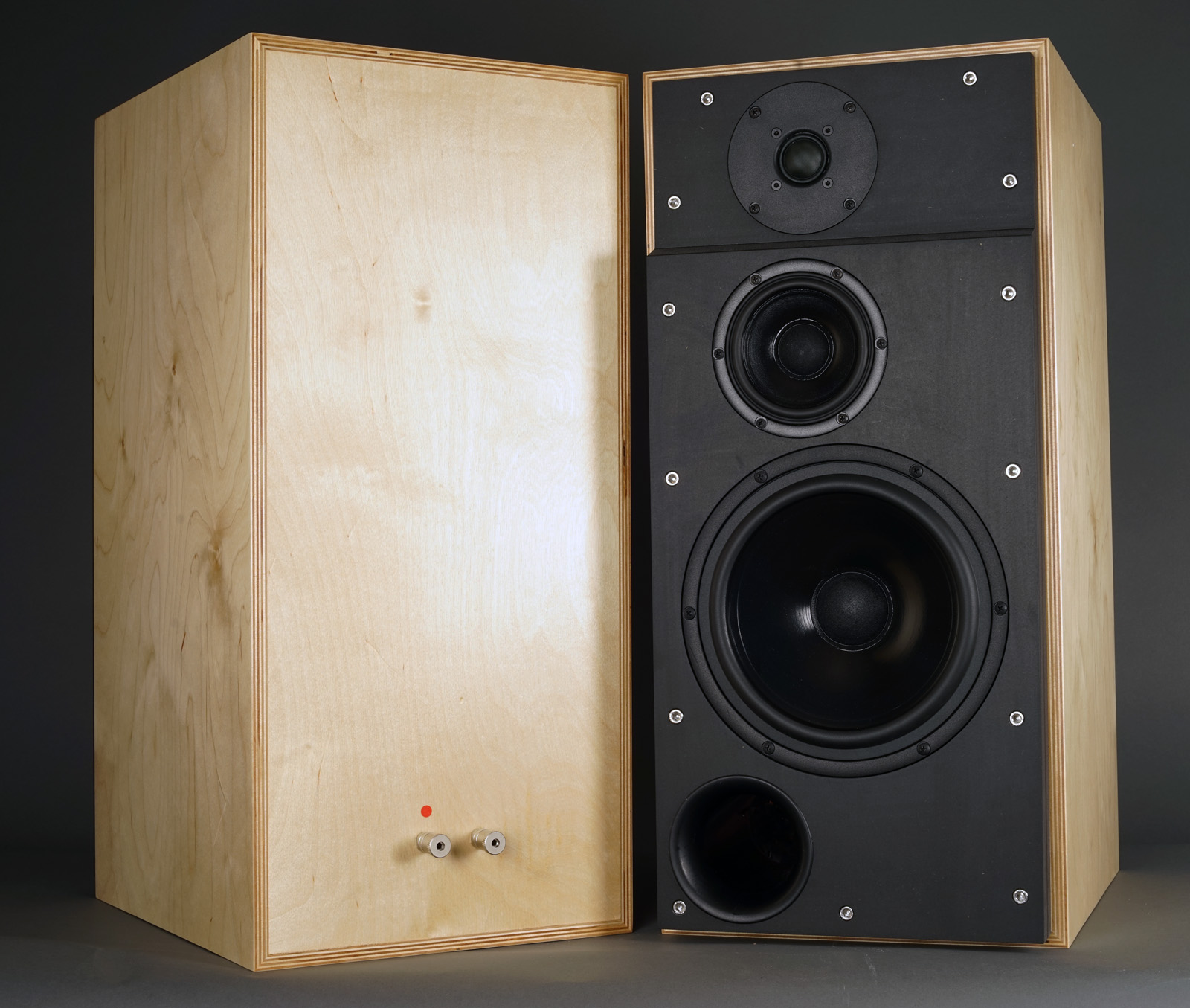

2 way or 3 way build
i just purchased some drivers for a speaker build,a pr of 9" atc bass drivers,my question is can i make a 2 way stand mount speaker with these?? is it possible or impossible,if yes which tweeter? or am i best to do a 3 way,and same question which tweeter,i do have a new pr of vifa xt25's,but which mids do i use,cant really afford the atc mids,crazy money,thanks for reading..🙂

TRADITIONAL THREE WAY:
1" dome + 4" midrange + 234mm bass driver
--need ATC T/S parameters to select the best 4" midrange
Controlled Directivity TWO WAY:
EconoWave: SEOS12 plastic waveguide plus a 1" compression driver. Several example designs and Xovers to study. Visit
Home page DIY Sound Group
Easy TWO WAY:
3" full range with 400Hz Xover

i know that these drivers are ATC PA275-234,thats all i know,all this diy thing is totally new to me,my dad was going to use them,he's no longer here,i used to help him build his speaker cabinets,and was going to finish what he'd started.does that model no. help any..

They are probably PA75-234 of some sort and you haven't checked
the ATC link provided, to sort out which one, which you need to do.
Seems to me you are way out of your depth.

Do you want to build a PA speaker or a home audio speaker?
right i have this info,they are stamped ATC PA275-234 STD PD, But re-coned with the later STD
kit so they retained a more usable range and they where removed from some opus cabinets originally.
Unless you know the specs of the driver or can measure them
we really don't know. ATC don't make PA275 drivers but you
seem to imply they are now ATC PA75-234 STD drivers.
They are PA drivers, designed to be used as lower mids.
If they do say PA275-234 STD PD I've no idea what they
are or what the later reconing did but would hazard they
are still not suitable for a hifi 2 way or 3 way.
Your best bet would be to move them on, unless ATC
can provide definitive specs, and they are hifi sutable.
rgds, sreten.
