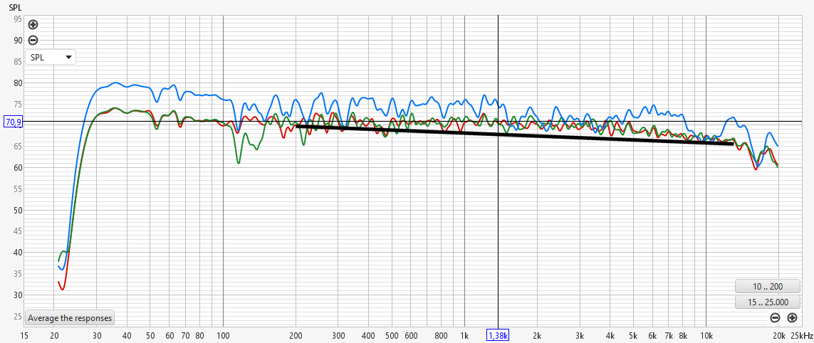

my 2 way faital 15pr400 and hf108 measure nearly perfect after dsp equalization (camilla dsp).
Pic shows mesaured them individually and both the same time.
The response is worse, when measured both the same time (blue line). Does it make sense to equalize it to flaten the response?
What`s the reason for the blue response? The mic was placed in the middle when measured (runtime difference was zero from left vs. right).

Not shure, if I understand what you mean.
All three measurements had been done at the listening position. All with the DSP engaged. If both speakers are measured the same time, I get the blue graph. If measured separate, I get red and green lines.
Some regions cancel each other in the blue line.
Could this be reflections from the room, that lead to phase cancelations between left and right?

These are the norm when measuring left and right speakers at once if the test signals are correlated. The speakers and microphone would have to be perfectly positioned for this not to happen. Your biggest deviations are in the higher frequencies where wavelengths are small enough that it's almost impossible to position things well enough to avoid issues.

It looks like floor and ceiling reflection are also EQ'd away, which likely makes power response bit silly, as AllenB tipped out.
I speculate that if you move mic say 1m closer to speakers the first reflections shift in time and have bit different spectra and the response gets worse than without EQ.
Be really cautious correcting room effects to one spot, as it gets worse everywhere else, including the other rooms the sound gets to. This is why speakers are usually tuned by anechoic response, and then touched a bit in the room, mainly balancing the spectum in broad strokes, and perhaps knock down some modal peaks, relatively minor stuff, leaving the response at listening spot bit wonky looking but likely sounding quite fine throughout the house.

If you draw a straight line between your 200 Hz and ~15 kHz points, then equalize to that, it might help. Your current response seems a couple dB hot through most of the midrange given the rest of the curve. In the end, your ears tell you what's right and not. A flat in-room response may not be to your liking, and that's OK.

In case it wasn't clear, the black bar here is the kind of target I meant in my 200 Hz to 15 kHz comment. Many listeners prefer a gradually downward sloping in-room response, and this tuning would more closely resemble that. How much tilt you like is personal preference, and a hotter presentation has become more accepted recently. If you don't like that, you just don't though. A more forward presentation can give new speakers wow factor because they sound highly detailed and dynamic, but it can also be fatiguing over time to some (or instantly on the wrong song).
