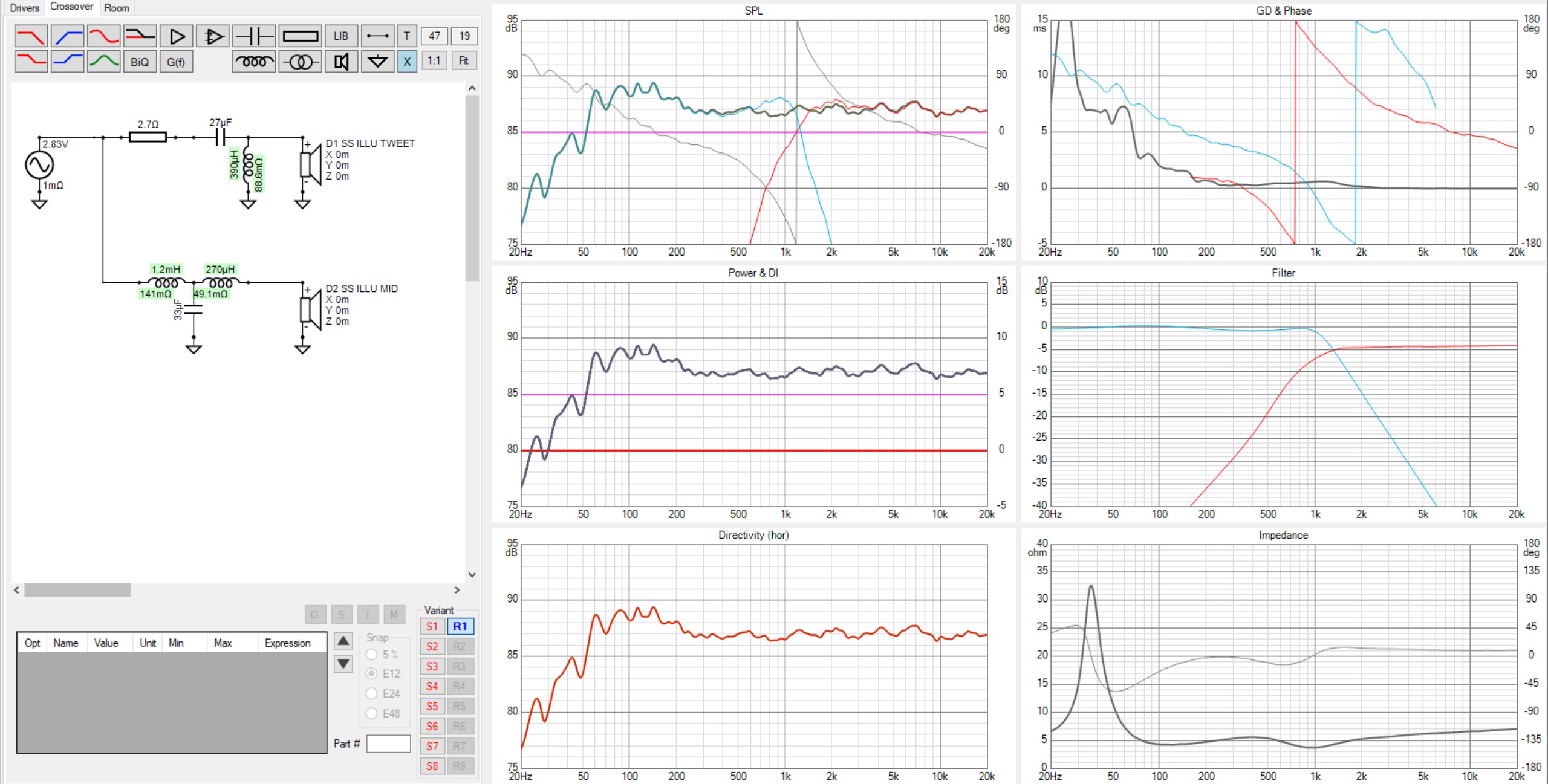

This is my first foray into the DIY World. I'm trying to design a 2 way similar to the Zaph ZRT but with illuminator drivers instead of revelators. Looking for feedback on the steps involved in designing a speaker.
Primary objective: An impedance not lower than 4 ohms minimum to play well with a wide range of amplifiers.
1) I've picked the drivers: D3004/66200 and 18WU/4741TOO.
2) Gotten close to a flat FR in vituixCAD with crossover design. I don't like the tweeter playing down so low but have not been able to design steeper filter that works for me. Couldn't get rid of the 2 dB bump around 200 hz so I gave up thinking baffle step might help me with that.
3) Tried using the enclosure tool within VituixCAD. Bass reflex 2.5 cu ft. or 70 liters, I've attached the screenshot.
Problem is I designed the crossover with the 87.5 dB/w sensitivity rating of the mid range and brought down the tweeter a few dB, but the enclosure is now giving me and average SPL of 91 dB for the mid-range. Should I bump up the tweeter again? Or there is some other solution behind this?
Also Is this driver really going to give me a -3 dB of 25 hz? Seems too good to be true. I'm pretty confused so please point me in the right direction.

70l for single 18WU is too much. 30l is optimal
100Hz bump is what I also measured, do not bother with it, 18WU has one of the best bass sound and extension in that woofer size.
Crossover is wrong, phase tracking is wrong. Check projects of Troels for inspiration.

Ah yes that is a big error on my part. I mistakenly used external dimensions for calculating internal volume. Thanks for pointing it out.
