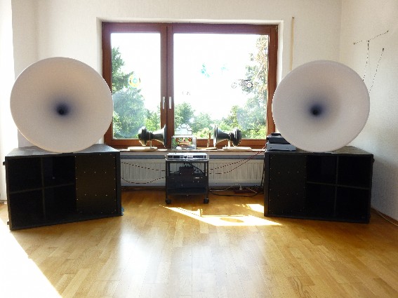

1) German StereoLab Tractrix ideas. Simple horn and folded horn ideas.

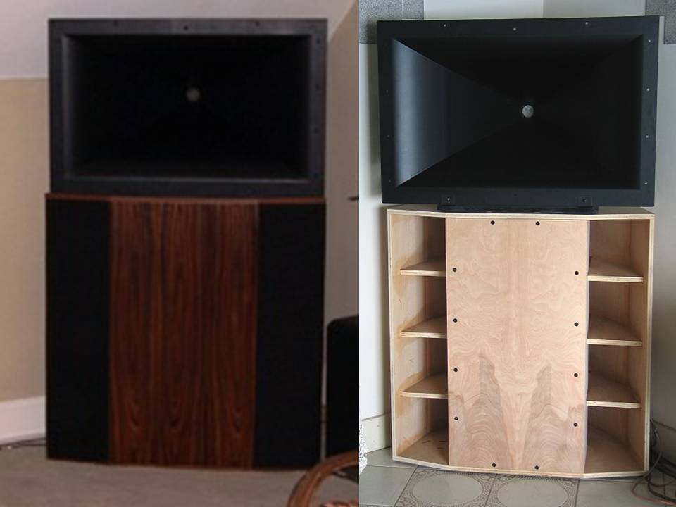

2) Klipsch 15" Jamboree 3" center stretch of 12" Jubilee

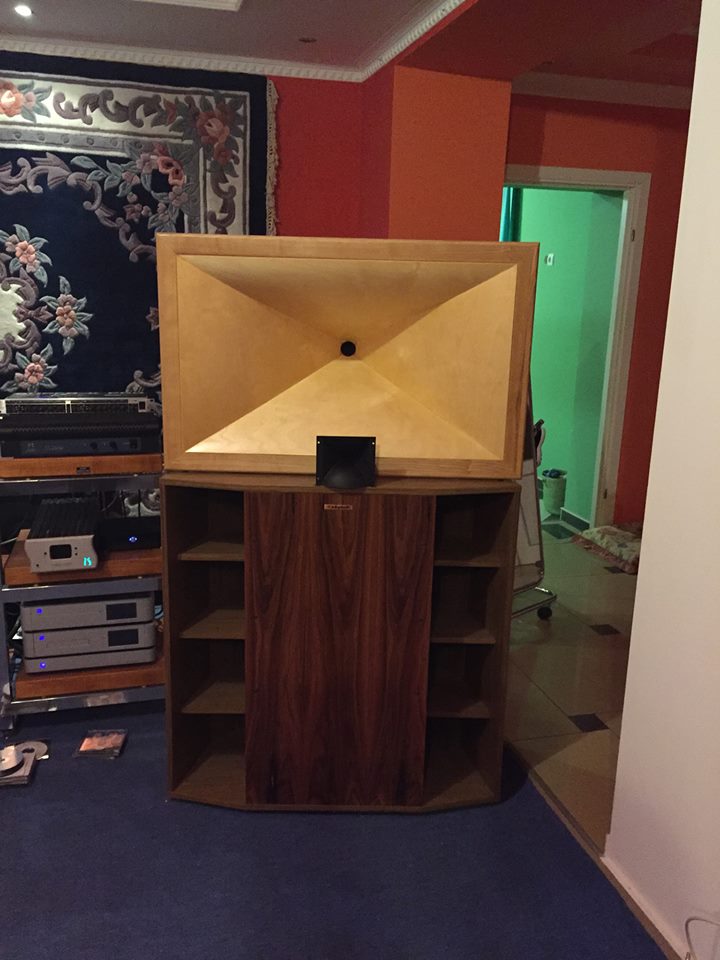

3) Folks with crazy wood skills build K-402
