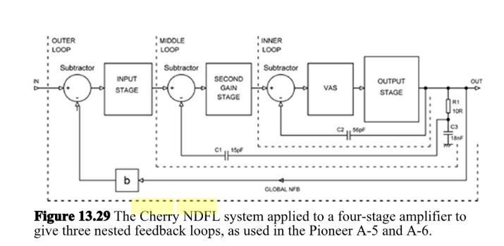

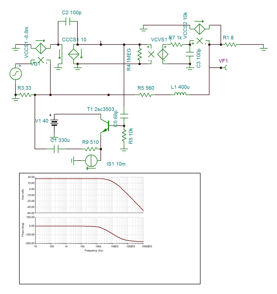

In 3 stage amplifiers the secondary pole of the output limits the possible NFB . It needs to be eliminated from the feedback loop , how?. In 77 Cherry patented a method that Pioneer used unsuccessfully in two models early 80's with the following description in the service manual.
attachment.php
In this method , the high frequencies from the output are suppressed from the feedback , the low pass adds an extra pole to provoke oscillation , a forth stage is added to add an extra pole to stabilize . It replaces a low secondary parasite pole of the output with a higher one in the forth stage, but as it needs the second pole on the feedback it inverses on the overall loop and the frequency response becomes high pass. Pioneer who produces hifi amps re feedbacks withe less NFB to flatten the response. The author published his version where he equalizes the response by claiming it is delay time compensation, that on other amplifiers can also be applied.

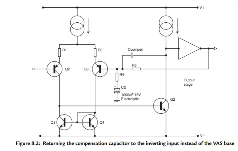

Another method is an error of application after the idea of John Lensley Hood .
attachment.php
This is related by Douglas Self in his book . The initial idea of JLH is to resolve the problem of slew saturation. Self did try it out in vain despite direct contact with the author. The indirect result , the feedback from the output if it gets its second unwilling pole hence decreaisng its level lower than the VAS , the VAS, with it's collector -base Miller capacitor making it low impedance , it can take the relay via the capacitor and continue to fill the feedback with a cleaner single pole. Of course it would be miracle that the transition frequencies are adjusted by chance. Our friend LKA he did this type of feedback , again for different reason , but unlike Self he made it work . By analyzing his circuit that I came up to the following conclusion.
attachment.php

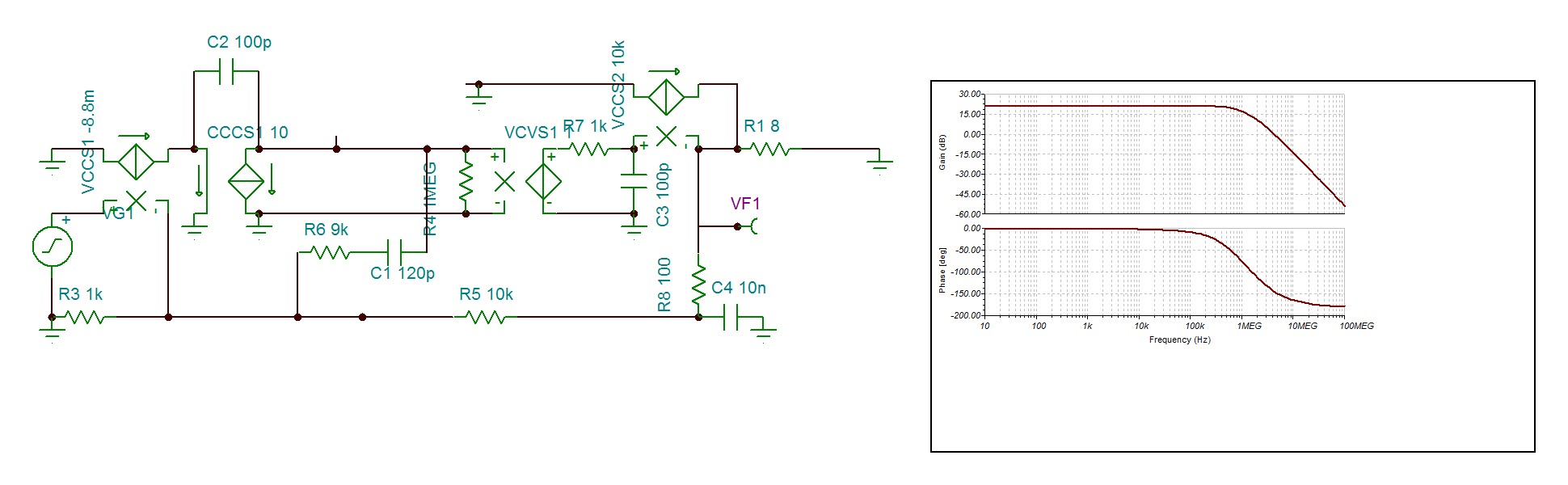

This is a standard model amp just look at the bode plot.
attachment.php

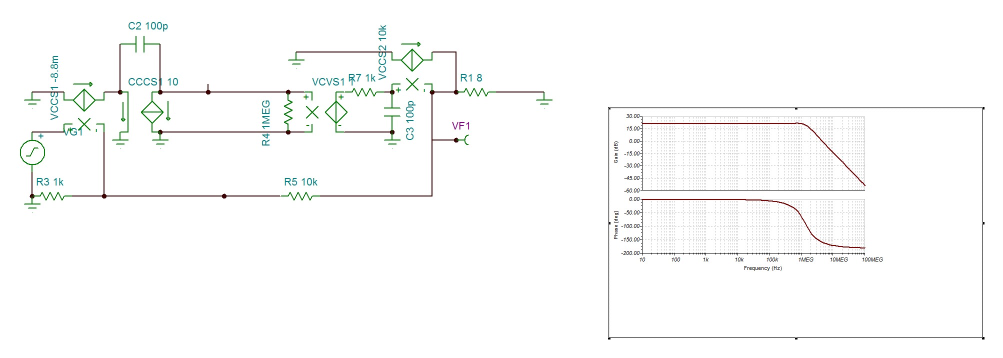

This what happens if a low pass filter suppresses the high frequencies from feedbacking.
attachment.php

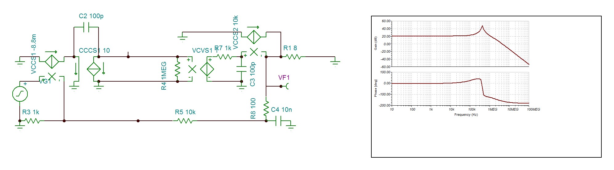

This is the result by adding the VAS high frequencies to the feedback .
I call it 2 way as speakers and not two pole , because there is one pole on the output and one zero on the VAS exactly at the same frequency canceling each other. Isn't it nice hē , isn't it?

I didn't apply any Lead compensation. The amount of compensation depends upon the closed loop gain, lower it is less effective is the lead compensation. By this it gave just a little bit of extra NFB. Here instead of increasing a little bit the second pole from the output stage , is to cancel it totaly.
The effectiveness of the feedback depends on the ratio of open loop gain to closed loop gain, mostly around the output stage. You have to look at how the loop gain around the output stage changes with different compensation schemes. When the loop is bypassed at the VAS stage to improve phase margin, some of the desirable loop gain is reduced. It’s more subtle than it looks.
The output starts going open loop at the transition frequency, Cherry, by using the Zobel 8 ohm 100nf fixes it at 200khz. As the output impedance of the VAS now lowered by the feedback, the output stage works in open loop but hard driven. I would fix the transition frequency to that of the output LR.

Re Fig 8.2 post 1
This form of compensation network can put some bends or peaking in a Tian plot. RC networks connecting the mirror transistor collectors to the negative rail could be used to help straighten this out.

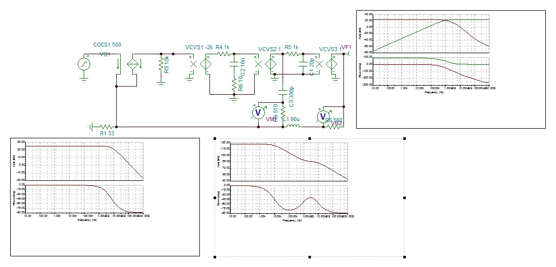

attachment.php
In this model, the crossover takes place at 1Mhz. The second OS pole is fixed at 8Mhz. The VAS stops integrating at 1Mhz to go flat . By this the closed loop response becomes first order with maximum PM, see 90° phase shift instead of 180° habitually. The frequencies bellow 1Mhz get feed backed via L1 issue from the output but above, the driver stage pours through C3 uncompensated feedback. Notice the total absence of the second pole 8 Mhz despite 100db NFB.
