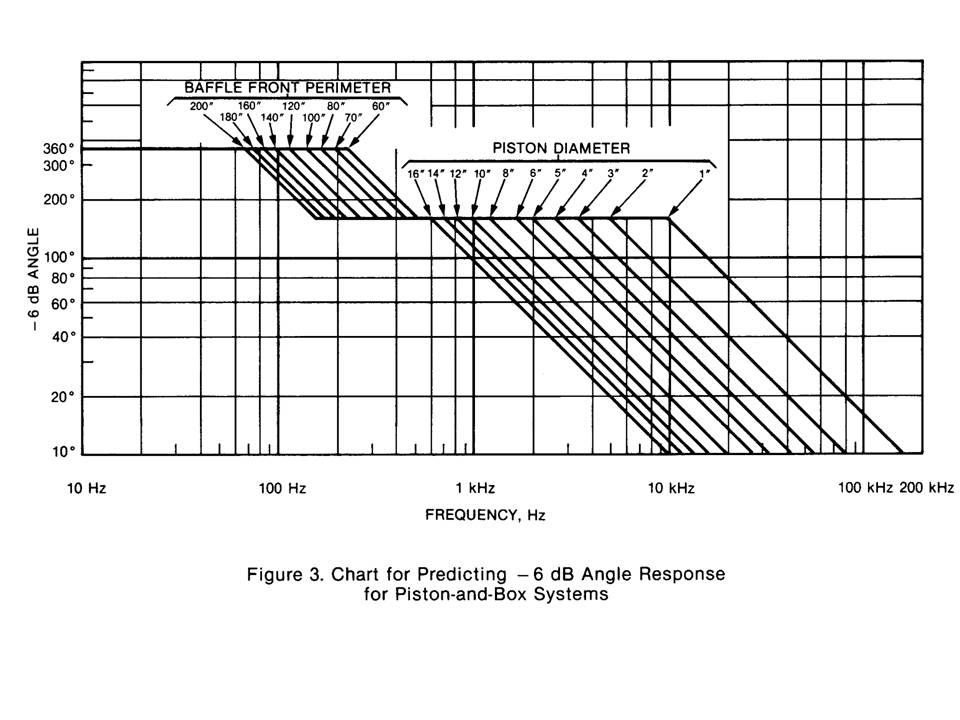

But the 10" will be a better match with the horn at a higher XO point then you outlined.
If looking to cross lower you'd want to use a 14-16" driver normally.
What XO freq would be better for a 10" driver?
