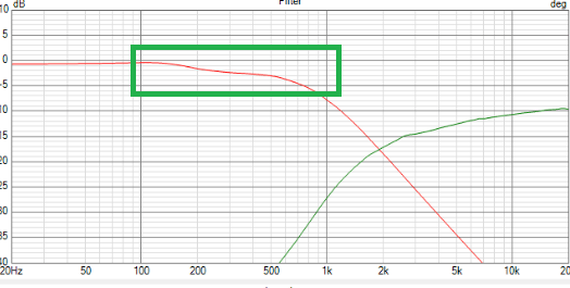

Hi!
Im happy to share with you this 2way project
Regarding
L1 ... looks too small for a woofer? cant find a aircore inductor on 0.0039mH
D1 Cap..... also the value seems odd
sure must be something really wrong or truly right.
Need some light from you experienced folks
All the best Everyone

Check the impedance, L1 and C1 don't have much influence on the driver output, they just lower the impedance, practically mute your whole speaker and kill your amp.
Also, remove the parallel resistor from your woofer network.

this situation is theoretical or its happening with the circuit right now?L1 and C1 don't have much influence on the driver output, they just lower the impedance, practically mute your whole speaker and kill your amp.
could you help me understand its role in this situation? in the case of the simulation it is helping to tame 2k range area. but i don't understand the reason it is a bad choice (noob here)remove the parallel resistor from your woofer network

Because as it is now they do not have any effect except lowering the impedance to almost zero.as soon i mess with more usual values on L1 and C1 the slope starts to become a messy ugly
Just delete C1 and short L1 and check the result.

But in short: the parallel resistor just eats up half of the woofer energy and maybe equalizes the woofer impedance (but it's a terrible method, you would need a 50 or higher wattage resistor).

Ditch L1 and C1 - they are bogus value elements. Your lead series inductor will be in the range of 0.8mH - 1.5mH for a 4 ohm nominal woofer or 1.6mH - 3mH for an 8 ohm nominal woofer, depending on baffle step. You seem to have this correctly handled, so I'm thinking the 1mH value you have is about right:
Beta 12CX is a co-ax.z-offset but no y-offset
Assuming this is a 2 way design with separate drivers (i.e. TM)Your offsets are incorrect. You have a z-offset but no y-offset, but it should be the other way around. You should have a negative y-offset on the woofer, assuming it is below the tweeter.
Well - the Z offset being positive will push the woofer voice coil behind the tweeter and that is correct.
I believe a negative Y locates the woofer down / below the tweeter (unless you 've applied a Baffle diffraction sim to allow for Y rolloff already -but unlikely)
So in this case the poster is likely to need both Positive Z and negative Y
