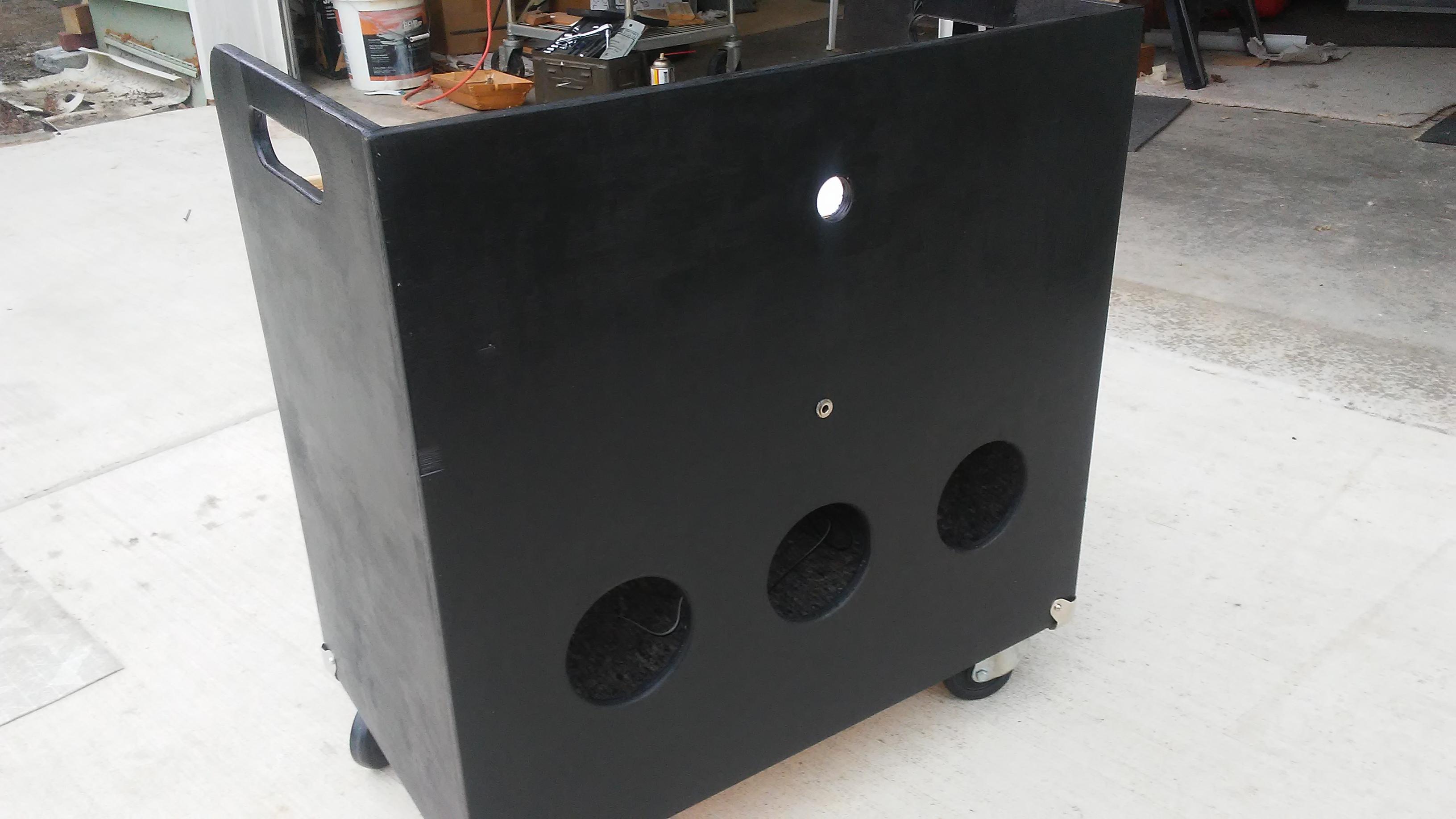

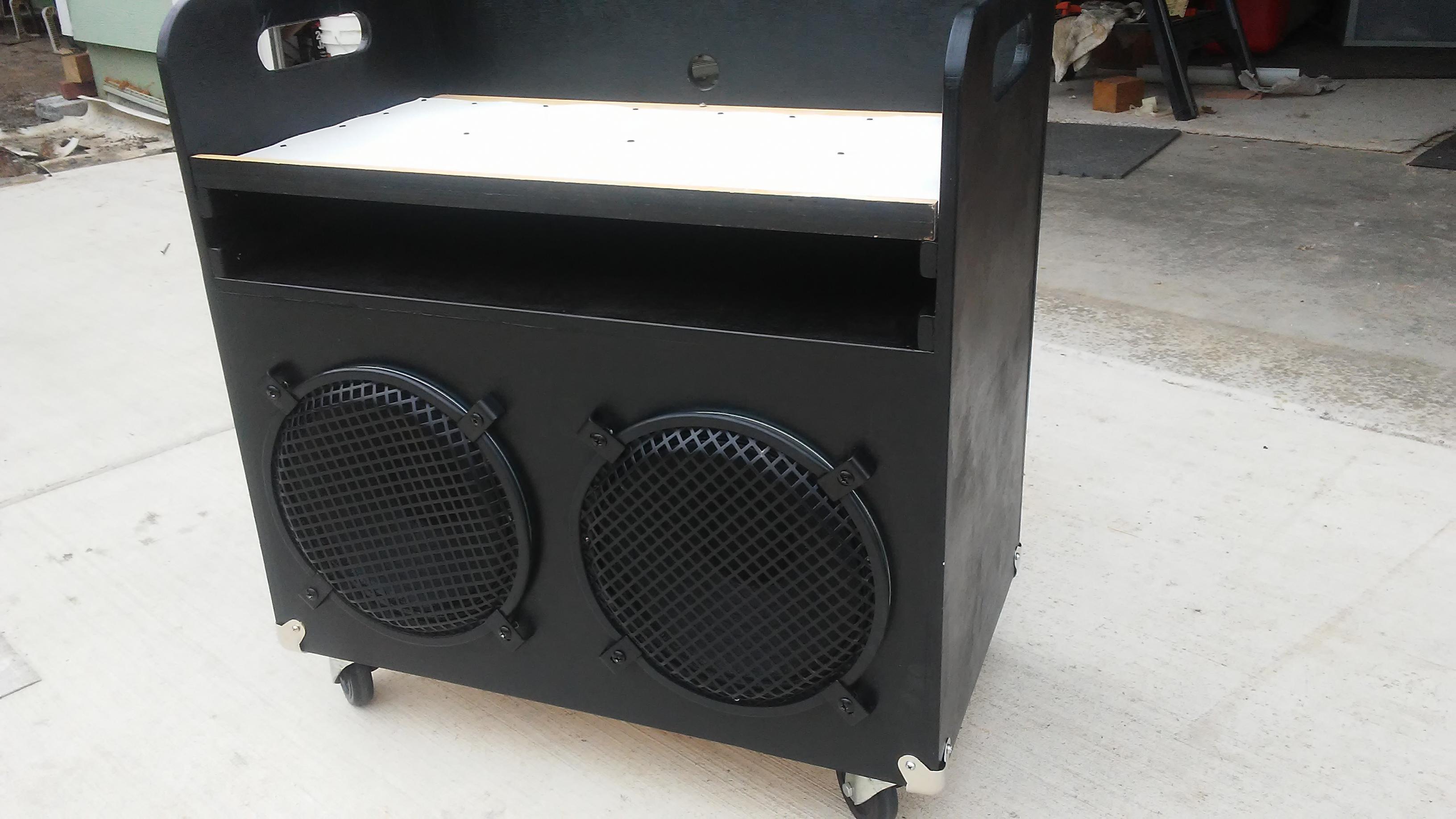

My whole reason for making the 2 x10" cab was to cut down on size and weight. Nowadays, you don't need big cabs. If you need more loud, you stick a mic in front of the speakers. Its more about the tone that comes out of the cab. I guess I need to rethink this some. Maybe cutting the back off will open up the high end...

That's a nice, well executed cab design, David.
However, as has been said, those beautifully sculpted openings in the back panel will give unpredictable results at low frequencies.
Another row of those may solve your problem.

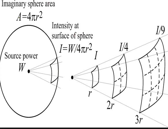

This is a Roy Allison WMTTMW home speaker. It just warms my heart. What it does is break the inverse square law:
687020d1529098544-passive-passe-spherical-waves-jpg
In PA, line arrays show their strengths. Put 4X 12" drivers in a vertical array and each one is working at 1/16 power with all the benefits of low distortion. But adds up to the same overall power for the audience. 😎
And when you venture outside the venue, it sounds WAY quieter. WIN-WIN IMO.

I get what your saying about the 3 holes in the back."those beautifully sculpted openings in the back panel will give unpredictable results at low frequencies." my original thought for having these was in kind of copying a design by BagEnd cabinets. Which had 2 circle holes in their sealed enclosure. They had 2x12" drivers in them. Fantastic sound and lots of punch! but then again, they probably had just the right tuning inside that for the specified speakers chosen. see my photo of theirs....
