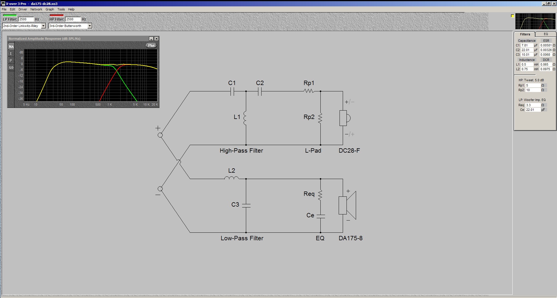

Last, here's a link to XSim, a free tool to help you. You can import the Dayton data and at least start learning about what's needed. Once you measure your actual drivers in place you will import the measured data and replace that for most accurate results.

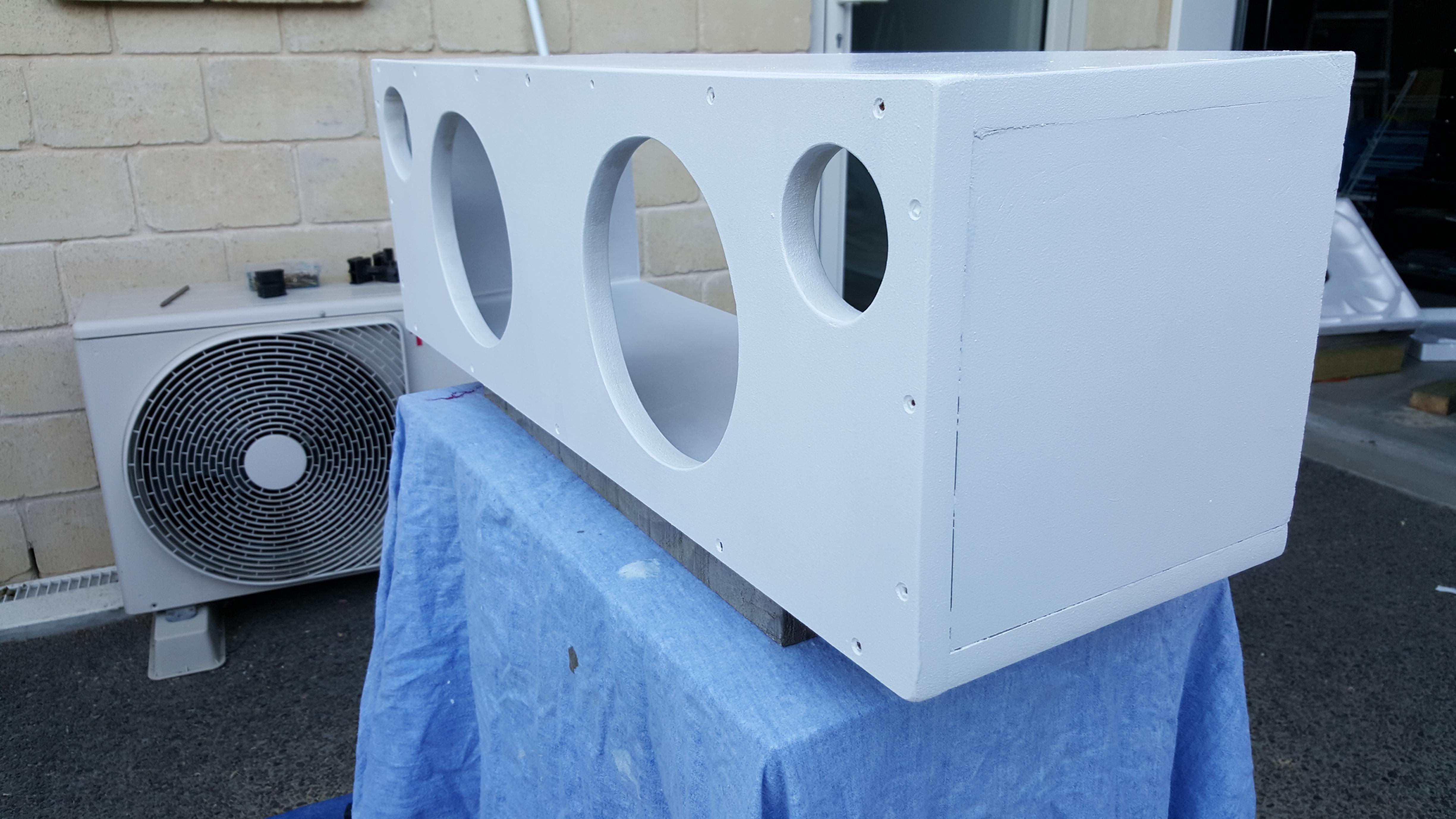

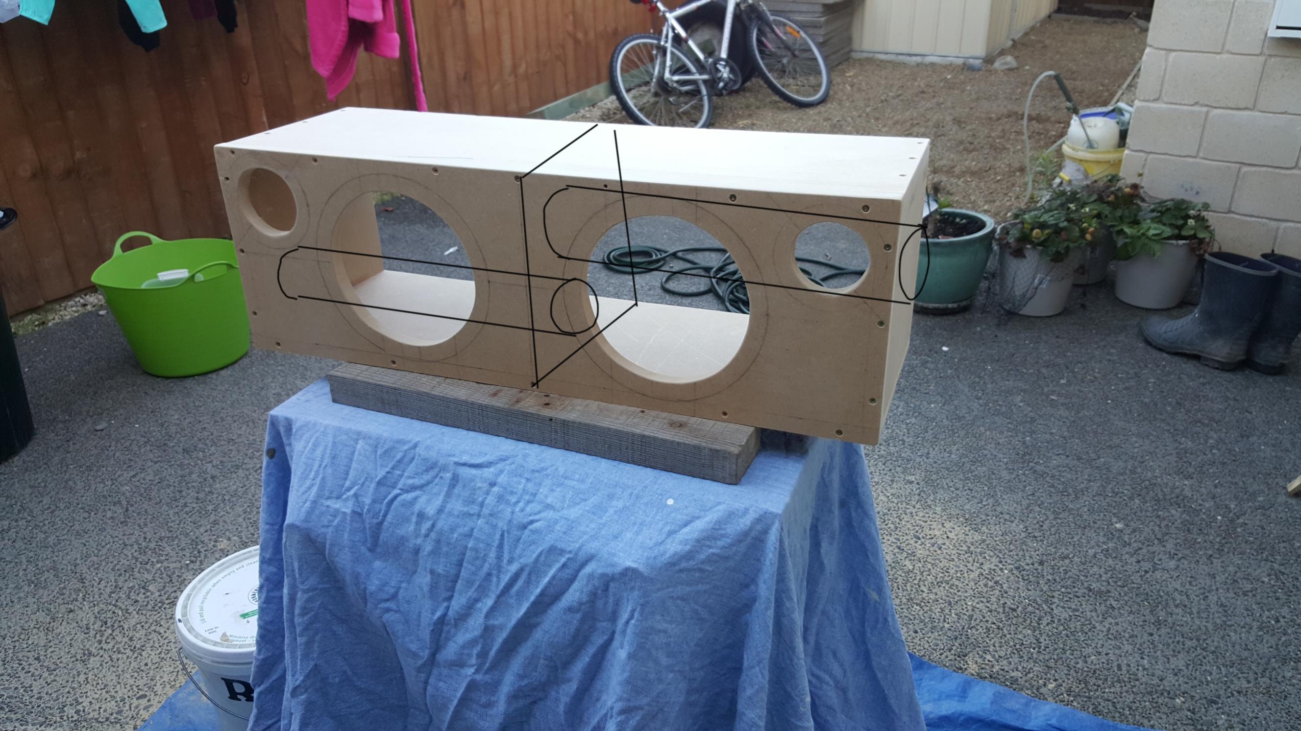

I was thinking about doing so with them both sharing the same port at the back of the box would this work or should I have have two separate ports, one for each woofer.
Also Should I put the tweeters in their own enclosures too?

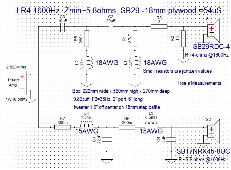

Parts Express has the FRD(frequency) and ZMA(impedance) data files for Dayton drivers which you can download. These are BIG BAFFLE measurements.
-You can download BoxSim + manual. A complete free toolset. Box + Crossover tool. BoxSim will modify FRD/ZMA/Phase based upon the box diffraction and crossover components.
-Download Passive Crossover Design Calculator 2.03 to calc early RLC values.
-Find a few example 2-way crossovers.... probably LR4 to avoid 2Khz woofer cone breakup, but also sim LR2 slope for low parts count(tweeter flips polarity).
-build-measure-tune-measure-celebrate.
BoxSim frustrates everyone for about four 2-hour sessions. Short manual plus trial and error. There are BoxSim threads on diyAudio, and a forum. A library with about 50 speaker projects(Google search). BoxSim startup has a 2-way example that allows you to easily experiment with making changes to the box size, driver position on the baffle, and crossover circuit. You have the T/S parameters + FRD + ZMA for the two Dayton drivers, and can add them to your BoxSim database to start your design. BoxSim will generate Xover circuits based upon the ZMA file data(BW3, LR2, BW2, etc..), the Passive Crossover spreadsheet is just an alternative tool and some good notch filters.
The Dayton DC28f-8 datasheet on PartsExpress has a 834Hz resonance, with a recommended crossover above 1800Hz. BUT your midrange starts major breakup around 2Khz, so a steep LR4 slope at 1600Hz is a good first experiment. You should also experiment with 1800Hz and listen for woofer grunge.
I attached an example LR4 topology for SB Acoustic drivers I had on hand, and an example crossover for the DC28f-8 from Google search.

Sweet is good all the info about my speakers are out there and easy to find. Il download that program this weekend and have a look. What do you think about a divider between left and right channels and high and low?
No no no haha not like that I mean left channels port goes out the right side of the box like the photo. I was wondering if it would be ok to have the left channels port coming out the right and the right channels port coming out the left 🙂
Are your ports actually that long ???? Just to be sure, did you actually run the numbers and get a port requirement that big?
Normally if you really needed a port that long (based on cabinet calculations) you'd fold them. You could do it as you show, with a little loss to any vibrations transmitted by the ports to the opposite drivers, but it's passable.
