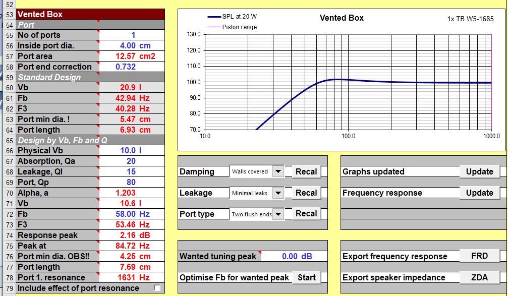

Below is what I'm thinking of in terms of the ported 80Hz boost. That's 10L per driver now tuned to 58Hz. You'll have to tell me if that's too significant of a size increase.

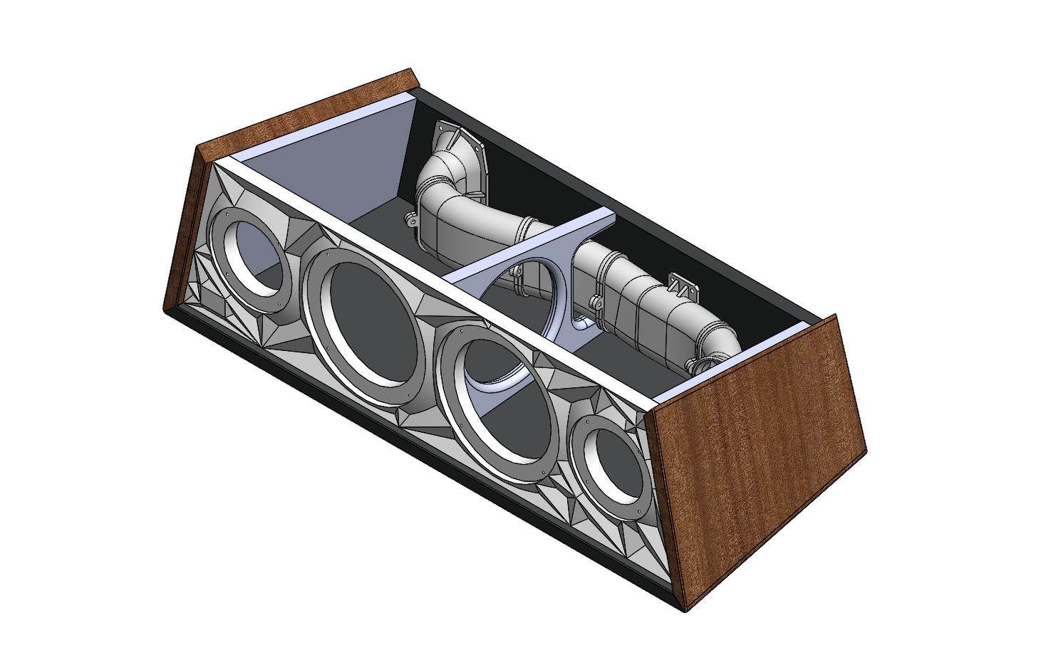

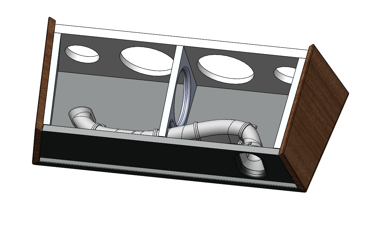

I've included a couple attachments showing the internals of the design thus far. I have already 3D printed the BRP but I might have been jumping the gun there from the looks of things. Realistically I couldn't see the internals being much more than 16,000cm^3 maybe 18 at a push. After that moving the thing around from room to room becomes difficult. Doesn't stuffing the unit with some kind of filler help in these regards though?

Again, cool design. You've obviously put a lot of time and effort into this already so I don't want to rain on your parade. And I haven't personally built anything like this so I may not be the best person for advice for some details. Nevertheless, a couple of problems spring to mind.
I would fully partition the 2 drivers. Left and right will have different signals going to each so if 1 is getting bass and the other is not, the other driver may act as a passive radiator and that will screw up the box tuning. In theory anyways. In practice, I don't really know how detrimental that may be. If you do partition, you will of course need 2 ports.
If the plan is for the speaker to be placed up against a wall, having the port feeding out the back is less than optimum. But with that gorgeous design on the front baffle, I guess the sides would be the only alternative.
Slot ports may be a good alternative way to go when space is tight because by using some of the existing cabinet walls for the ports, they may take up a little less internal volume. You'd have to do the calculations to be sure though.
I'm not sure if the angled sides (on 2 planes I think?) are for function or form, but in terms of the footprint that the speaker will occupy, it is kind of a waste of space. Might be ok though if the driver you choose doesn't need a larger box.
I might add 2 small vertical braces right about in the middle of those 2 top sub-panels to help prevent resonances. Those will be the worst offenders.

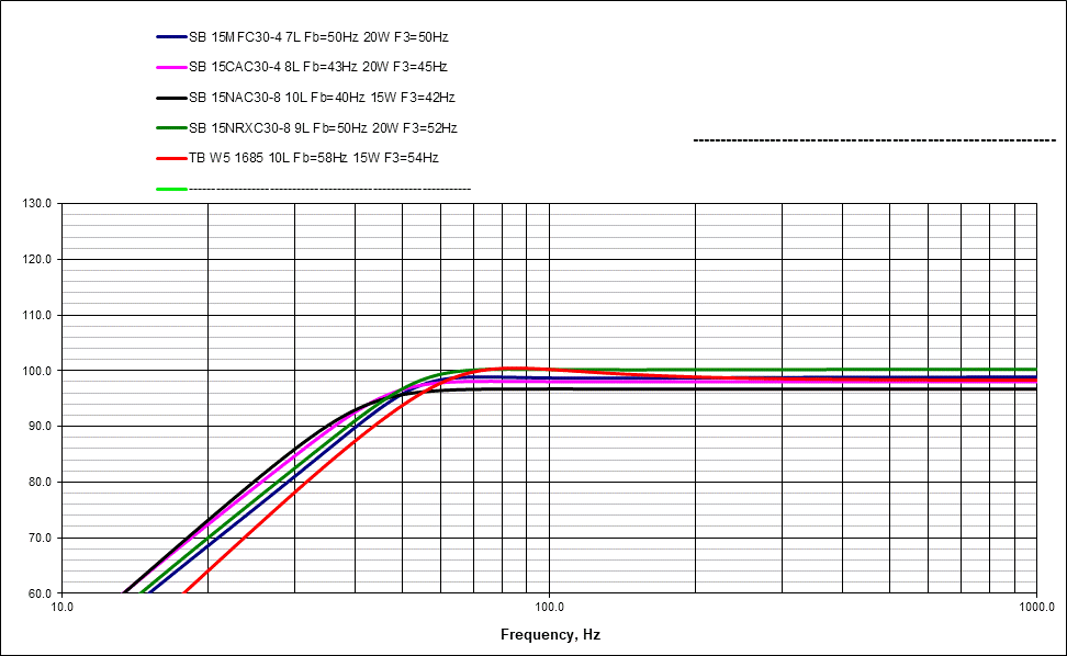

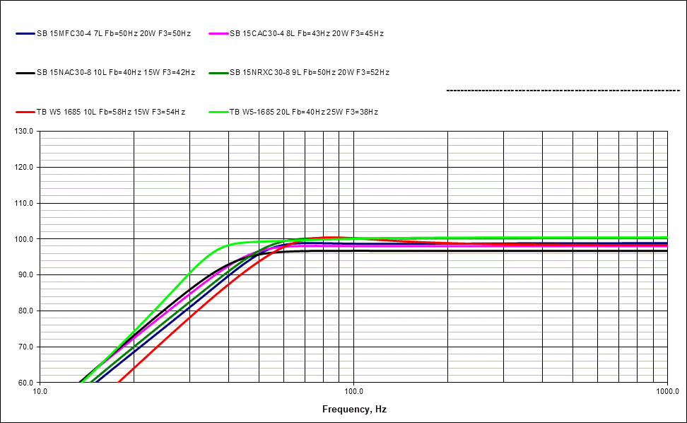

Attached is a comparison of some of SB Acoustic 150mm drivers. I have them all set up at their maximum cone excursions for content down to 40Hz so you can see their max SPL's and how many watts it takes to get there.
Quality is at least as good as the TB W5. The CAC ceramic and the NAC aluminum drivers go the lowest. The others will play a little louder. The poly cone MFC gets it done in the smallest box. Some of those responses can be modified to give similar to the TB W5 in even slightly smaller boxes.
The TB is there too for comparison purposes. A little messy because of overlap but there you go.

Thanks for the simulations, very useful. In your simulation I see it's at 10L and you're getting a pretty good response from the TBs whilst in range of my amps capability (much better than my simulation). What port are you using? Also how does this change in your sims with 20L and two of them? I am using WinISD for mine and this has a big effect.

TB W5 in 10L needs a 4cm x 7.7cm port. That's right about at max speed before chuffing is a problem. In 20L it does a whole lot better. The port contributes more to the LF response so it can play louder now before xmax is reached with about 25W. Port needs to be bigger though, 5cm x 13.8cm. F3 is now 38Hz.
Each example is for 1 driver only. For 2 drivers together in 40L, you need 2 of the same ports or 1 port about 7.5cm x 14cm. That's according to Unibox anyways and using TB's specs.
