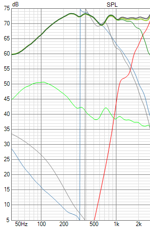

On the second picture you have L-pad and 2 tweeter notch filters: are they both necessary? Looked at the tweeter datasheet - it looks reasonably flat. For what frequencies they are?

The first notch filter is for tweeter's resonance frequency, the second is for small bump up around 5k (I don't know if it would be present in reality, but vituixCAD gives me one). It may be some "impurities" in frequency response or some fault because of measuring speaker response on baffle whit lack of knowledge what I'm doing. L-pad is just to resolve differences in speaker sensitivity.On the second picture you have L-pad and 2 tweeter notch filters: are they both necessary? Looked at the tweeter datasheet - it looks reasonably flat. For what frequencies they are?

@PovisS , I have a feeling, that you are little obsessed with the problem(s) that don't exist:
1. That tweeter has resonance freq of 600Hz, which one of the lowest of all the tweeters available. With the values of 2nd order 410uH 6.4uF my wild guess the crossover freq is ~2200-2500Hz depending on sensitivity (you wrote 3100, so even higher) and If you cross it at such freq - there is not much signal at the 600Hz, probably ~-40dB to -60dB, below audibility level, so I am very doubtful you need notch there. And if you build asymmetric filters, most likely you will do 3rd or 4th on tweeter, so the slope will be even higher. That bump on 5kHz could be controlled with smart L-pad selection and woofer slope. This is also my wild guess.
2. I do not think that you are solving a problem that exists: option one is to put acoustic centers as close as possible, maybe little lower crossover and forget that, especially if your tweeter physical dimensions kinda allows that, or there are threads about some magic spacing of 1.2-1.4 wavelengths on tweeter freq, you will find threads about that from our Finnish friends.
@svp , thanks for your opinion - you may be right about that second notch filter, that small issue around 5k or so, could be arranged in other ways. But for the resonance frequency notch, I'm think on keeping it as part of design just to be safe, because I heard that some people has the ringing problem even when resonance freq. is that low. What goes for speaker spacing it's already determined and enclosure panels are machined, so the solution is dependent on crossover. I researched about that Finnish sorcery you mentioned and those guys may have some legit points, and conveniently for me with speaker spacing I have, XO point between 3kHz and 3.3kHz would be precisely on the point for 1.2-1.4 wavelengths.

There is only psychoacoustics (read: audiophoolery) when we are talking about such cases. If you have crossover at lets say 2500Hz and it is 3rd order crossover tweeter - at 600Hz it will be -50dB from signal that is 300 times less the signal of lets say at 3000Hz and 100-200 times the signal of crossover freq. YOU CANNOT hear this while listening to music. Period. By some other calculations, the difference is in 100 000 times range. Forget about doing something for 600Hz range. Unnecessary parts will impact more negatively than positively. Here is typical example:
It is ~55-60dB below signal on 3rd order tweeter.
Also tweeter is 1.5dB more sensitive, so you have additional reserve not to burn your tweeter. And it has ~2/3 W power to your woofer, which is plenty.
Another thing: that woofer you use is better be used up to 2.2-2.5kHz, as it is typical 6 inch driver, with pretty big classic non-inverted surround, which may suggest it is not very suitable for quality high freq reproduction. Your tweeter is Fs 600Hz, if you cross it at lets say 2400Hz with 3rd order - that is 2 full octaves from its resonant freq, which is MORE than enough, with 4th order crossover you can cross even lower 2000Hz or even lower than that.
p.s. manufacturer states, that woofer is suitable up to 6kHz, which I doubt, and tweeter from 3kHz, which I also doubt. There are no recommended crossovers in data sheets still.
