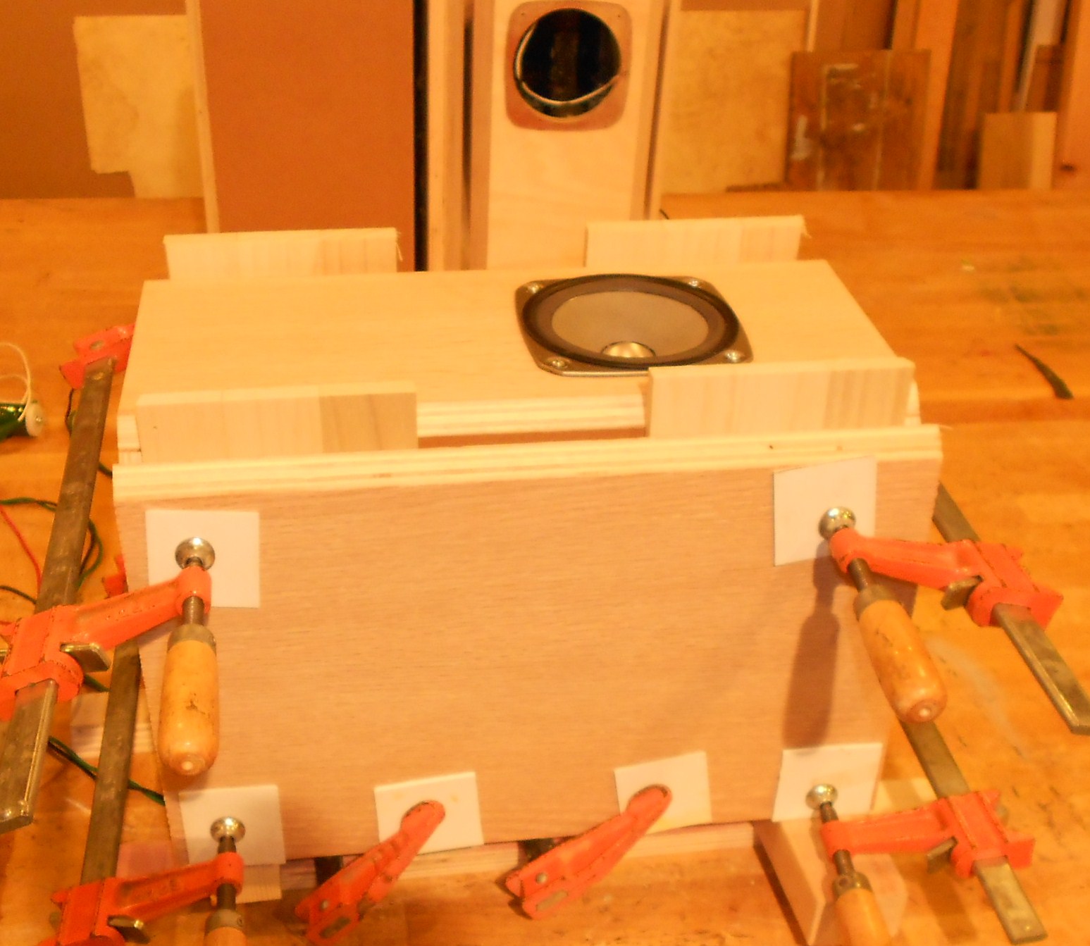

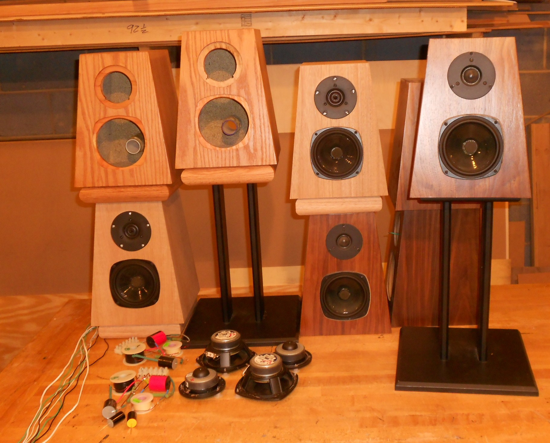

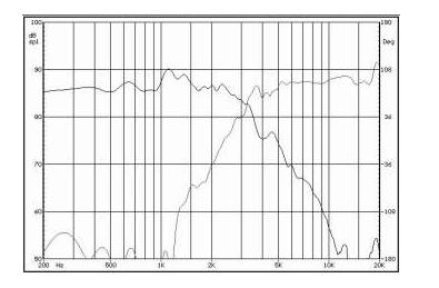

I had not thought of making them shallower, but had thought about making them shorter. Just worked up passive BSC and 2nd order crossover to add the XT25's. I think the BSC will balance the mid base much better and I won't have to adjust the size. I hope the second order helps on the breakup.
What got this started is the box tuning was to high, to lower the tuning the slot/ports would have been the size of straws........:-/
In that respect - mission accomplished; "low" tuning with huge ports. This should be be good; can't wait to finish up.

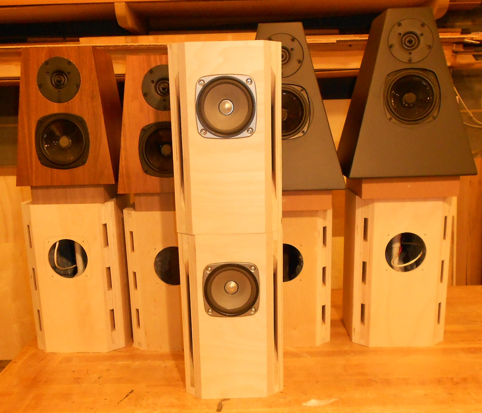

Another pair right behind....Aye Carumba!!

You the nail on the head a couple of times, the full range boxes do chuff a bit, not so much you can hear it over the music.
They are sounding nice, light and quick. I did pull out huge pieces of damping material (since the last time I had them together) and I like them better than before.

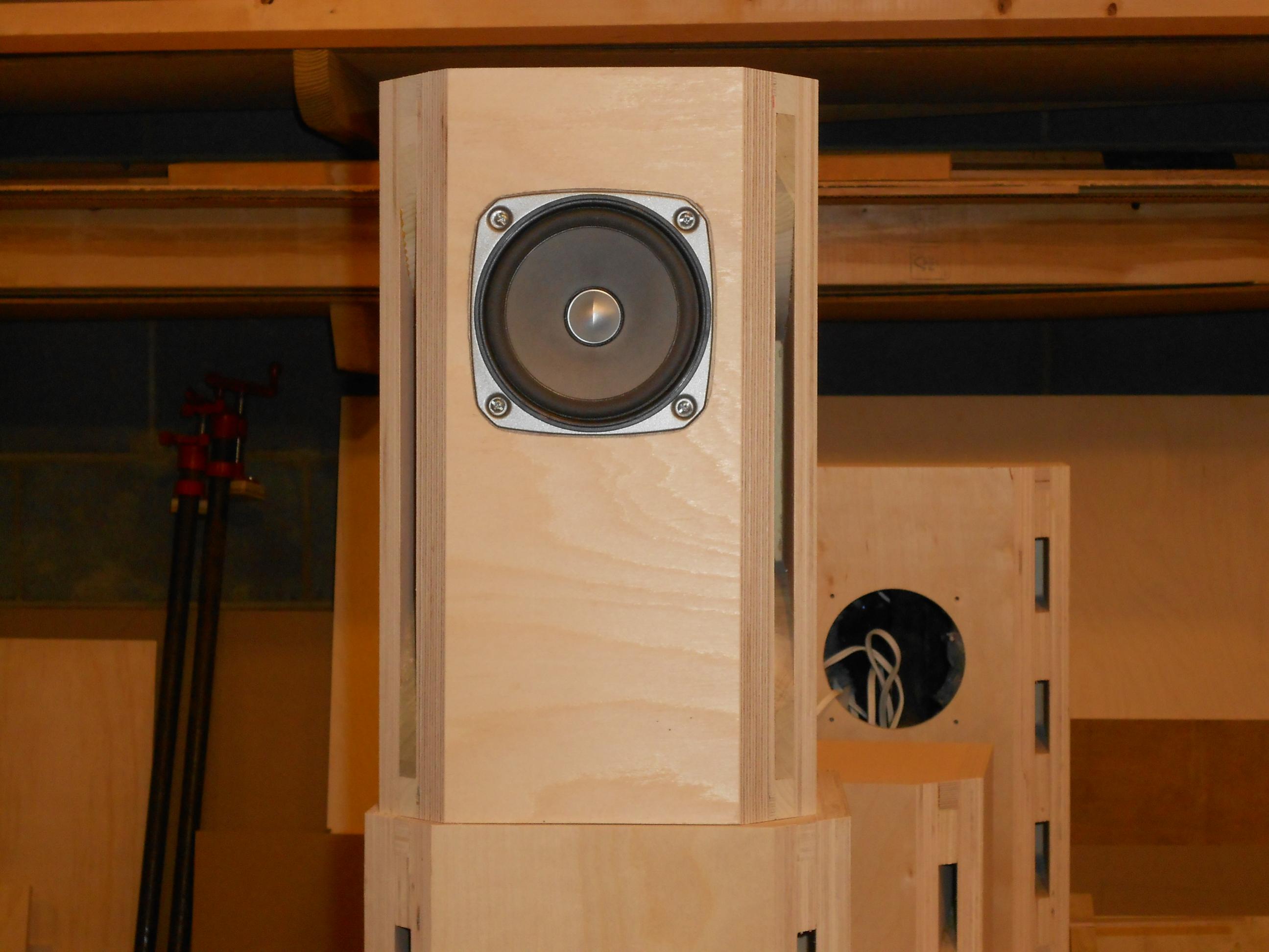

Chuff - Chuff Eliminated!
Well the chuffing is gone now....built new boxes with 1/16" WIDER slots, also rounded over the inter panels (inside) with round-over bit.
Going to tune by ear A/B, comparing with the other boxes;it's tuned right around Fostex specs (57hz) with the untrimmed filler pieces. I need to be carful not to trim them too much; or will be gluing up more.

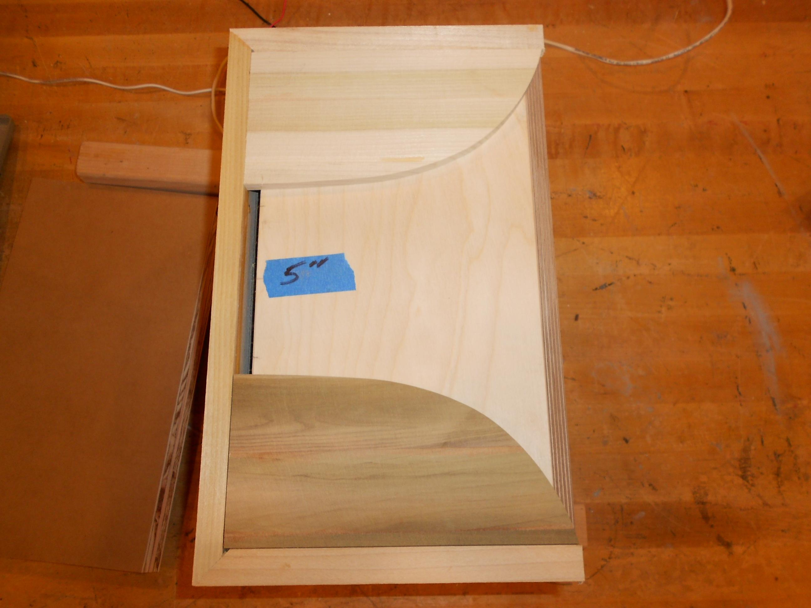

I would be concerned with the above picture that you will get wind noises by the relative small opening on the box end compared to the mass of air in the port.
The slot port reminds me of those pedestal room fans with the narrow ring slot but no blades. It seems like an opportunity to optimise the flow which was done with an aerofoil at the opening. The small conventional fan in the base of these with its narrow diameter can be quite noisy.
I think I'm going to try a few shapes for the "strips" - 1st is going to be flares at front and back, something like: ) (
With the 4 rectangle strips - (2 center openings) strips the bass is stating to sound throaty. So far no wind noise with these thicker strips.

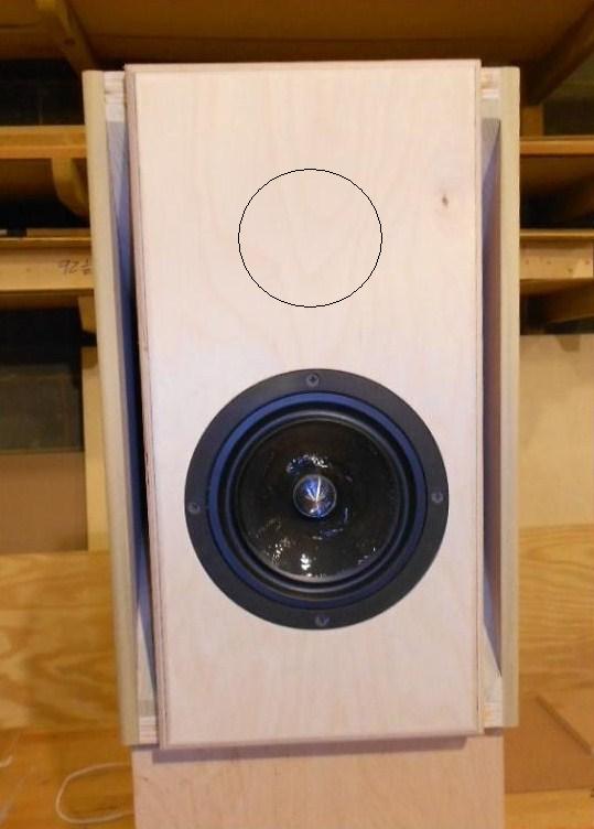

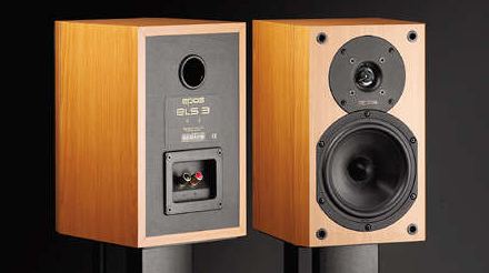

Looking for a tweeter for this box
We had a little listening get together yesterday. The small dark wood covered boxes (pic in post #1) were holding their own. Lots of solid bass, imaging is very good (which I always thought) but it was good to hear it from somebody else. We tried several pairs of speakers; this was the runner up
So the second part of this post. Looking for a tweeter for this box, it sounds pretty good for a full range, lacking top end crack, e.g. can't hear wood hitting cymbals. The imaging is impressive, just no high end
I was thinking about a small tweeter to handle 4,000 >
Vifa XT25SC90-04 1" Dual Ring Radiator Tweeter 264-1014
This is the woofer in the box:
Tang Band W5-1611SAF 5" Full Range Speaker 264-918

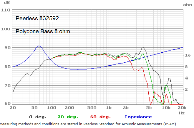

Did you ever find a PDF with frequency response for the Peerless 832591 4 ohm driver, ODougbo?
Reason I ask is the Peerless 832592 8 ohm version is just crying out for a notch filter at 4kHz. 🙂
15uF and about 0.1 mH and 1.5 ohm in series on the bass shunt for a 4 ohm speaker...😎
It's just nagging away at me. Haven't calculated the coil exactly, but it's in the right ballpark. 😱
Never found the PDF - there must be one out there. I'll email Madisound; this was a popular woofer years ago, there must be documentation.
My speaker buddy is set up with ARTA, I'll see if I can twist his arm and see if he'll measure them.
