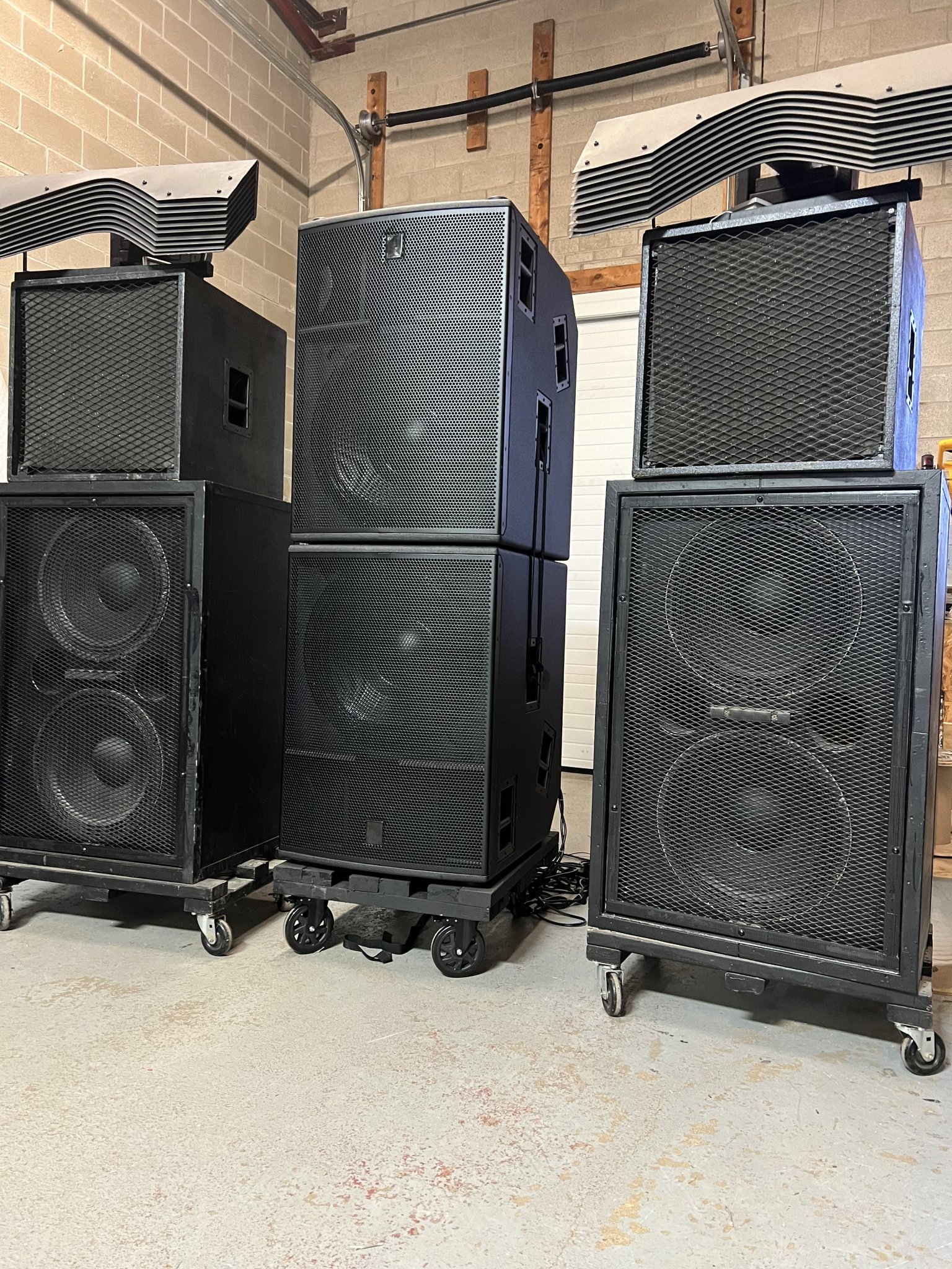

It’s not whistle while you work at our place, not when you want a little reggae. We also have 4 way 7 foot high old school JBL in our other shop - 2 pairs of them with 21 inch subs, 2 x 18 inch woofers, 12 inch mids with bullet tweeters in the mid cabinets, and the yard wide lens with 26 pound Alnico midrange drivers - nice, but you can’t mount 1800 pounds of them in the ceiling.

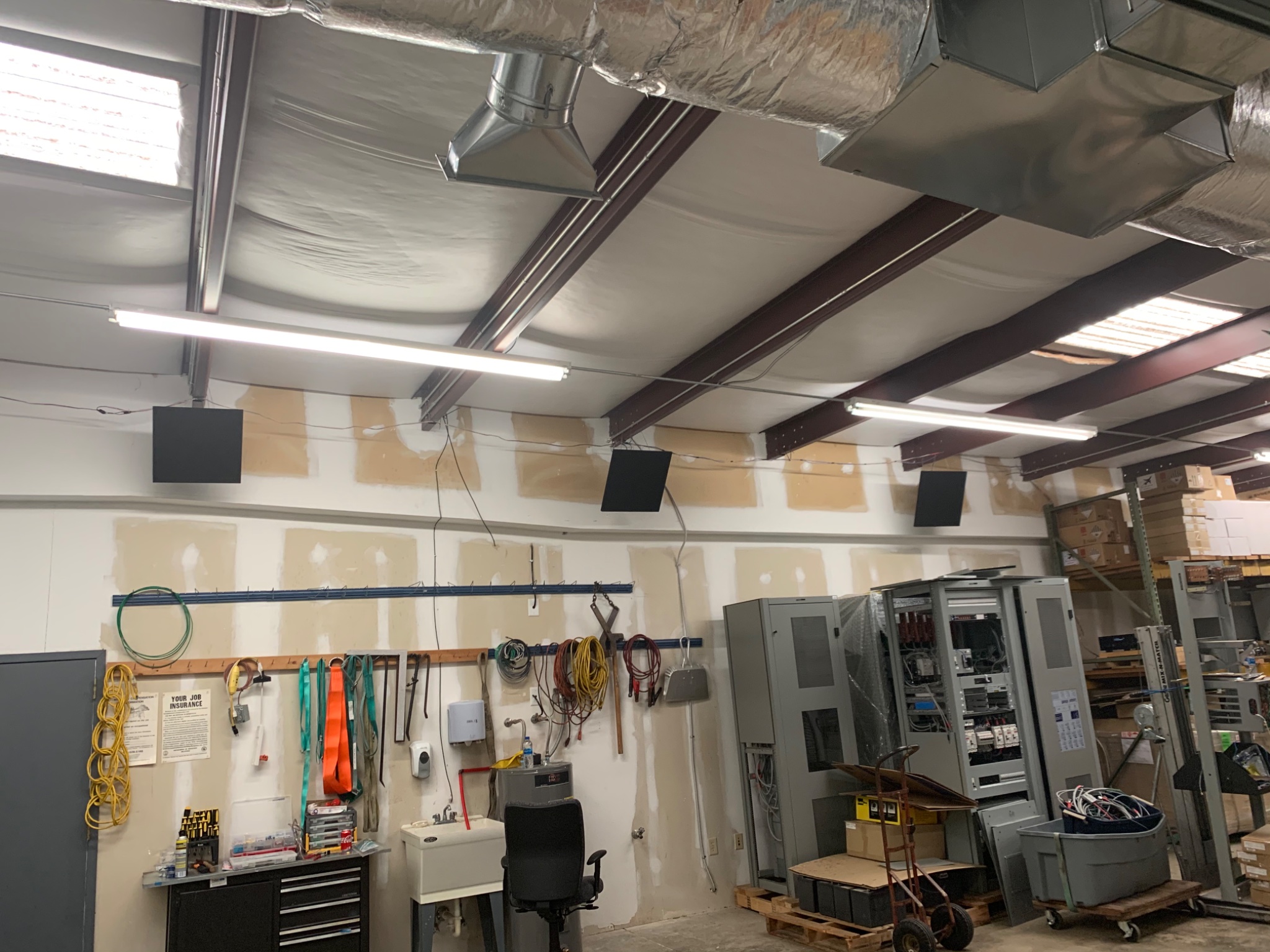

Here’s 3 of the JBLs on open baffles, not that you would mount yours that way, but to show they can be used without a box. There are floor mounted 18 inch subs ( and more of the 2142’s on open baffles ).
It doesn’t seem like it would work until you hear it.
The system with 24 of the 2142 are all on the same open baffle mounting - and more subs

you won’t use passive radiators, not many around and they only work with boxes - your budget won’t cover what you first had in mind.. Just mount coaxial drivers ( maybe car drivers if you can’t get good used industrial ones) in the ceiling with no box and no radiator, maybe experiment with some fiberglass around the back of the drivers to increase bass a litlle and reduce reflection. You won’t get deep bass without separate bass drivers - forget passive radiators . The 24 JBL coaxial drivers on open baffles with subs are being installed in a 1,600 sq. foot workshop in Birmingham, Alabama, with about 2 Kw to drive them. We high pass filter them at 115 hz with a big polypropelene capacitor so we don’t overdrive them in the bass region without a box. We got a very good deal - paid $110 a driver plus shipping for used 2142s. If you're ever out that way let me know.
