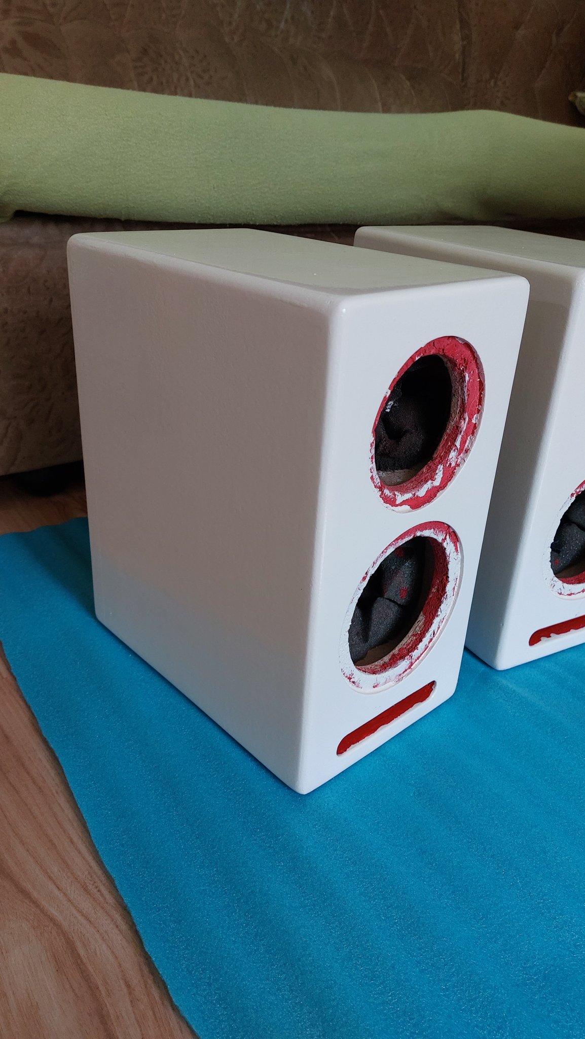

@abstract Already bought the drivers, yes the tcp wasn't the best choice here, a 5.25" would be better, but I thought it's high excursion would help bass a lot, they are ok. I didn't want to build huge cabinets.
I have mixed a song to mono, duplicated it and sent it to both channels , one to left one to right, and applied high pass and low pass in audacity, woofer on L and mid-high on R, the ps95 can work happy down to even 150hz, weird thing, free air they sound best with 250hz on the ps95's and 600-800 on the woofers, maybe because it's free air and the ps95's lack those frequencies ? need to test them in box.
Also tried in FL Studio , I can do it real time (high pass, low pass) polarity, I observed how it changes based on frequencies, and how they are out of phase on certain frequency range, fun stuff!.

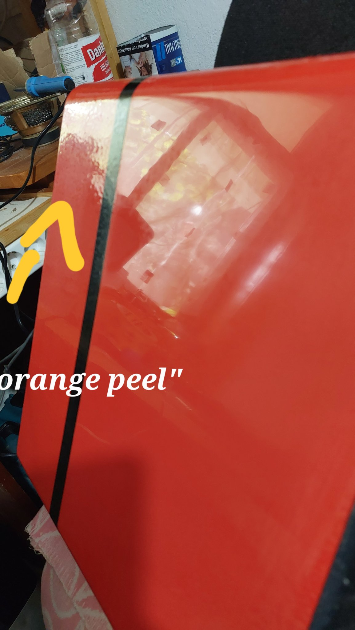

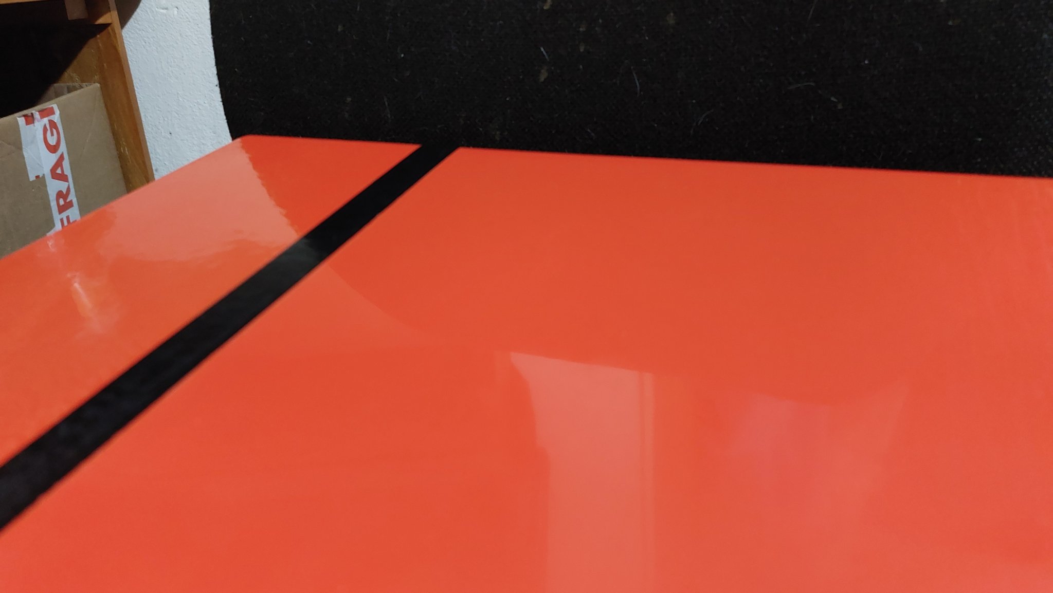

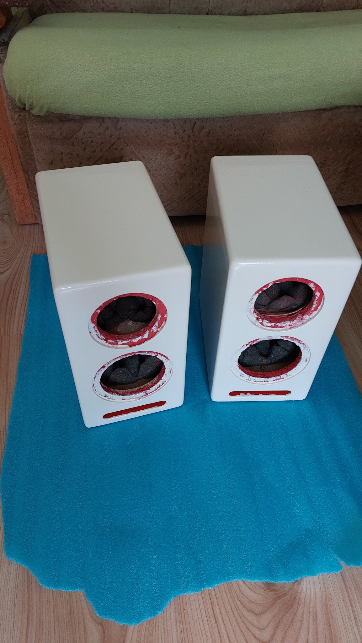

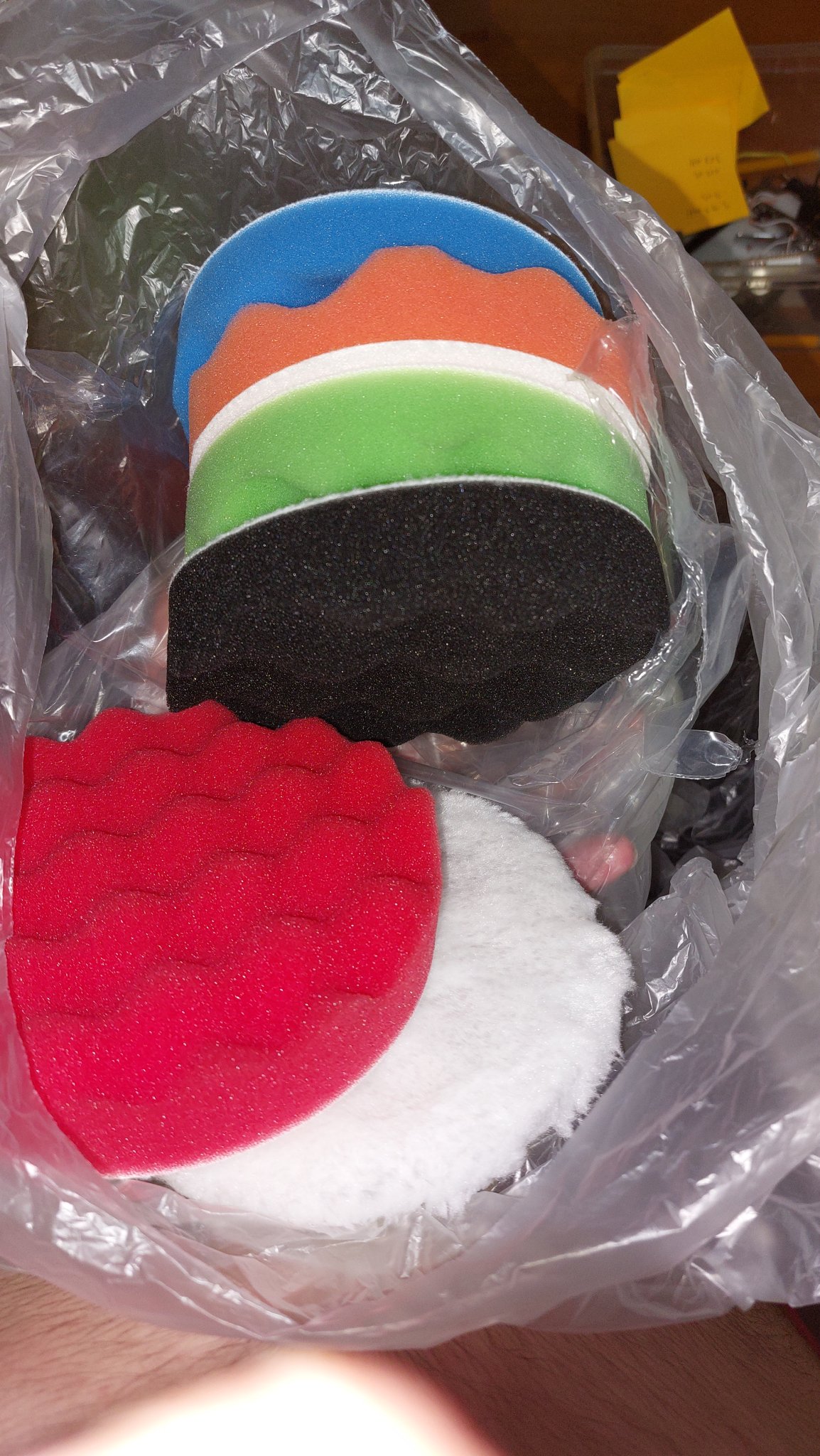

Not finished yet, I need the paint to fully cure , sand , and paint again then wet sand and polish them .
Already tried on a subwoofer box I painted red a while back, sanded (400 to 3000 grit )a
and polished to see how it works( by hand with a cloth on the red box) Got a kit for polishing, haven't tried it yet but I think it would work wonders if the results from " hand polishing" were good enough.

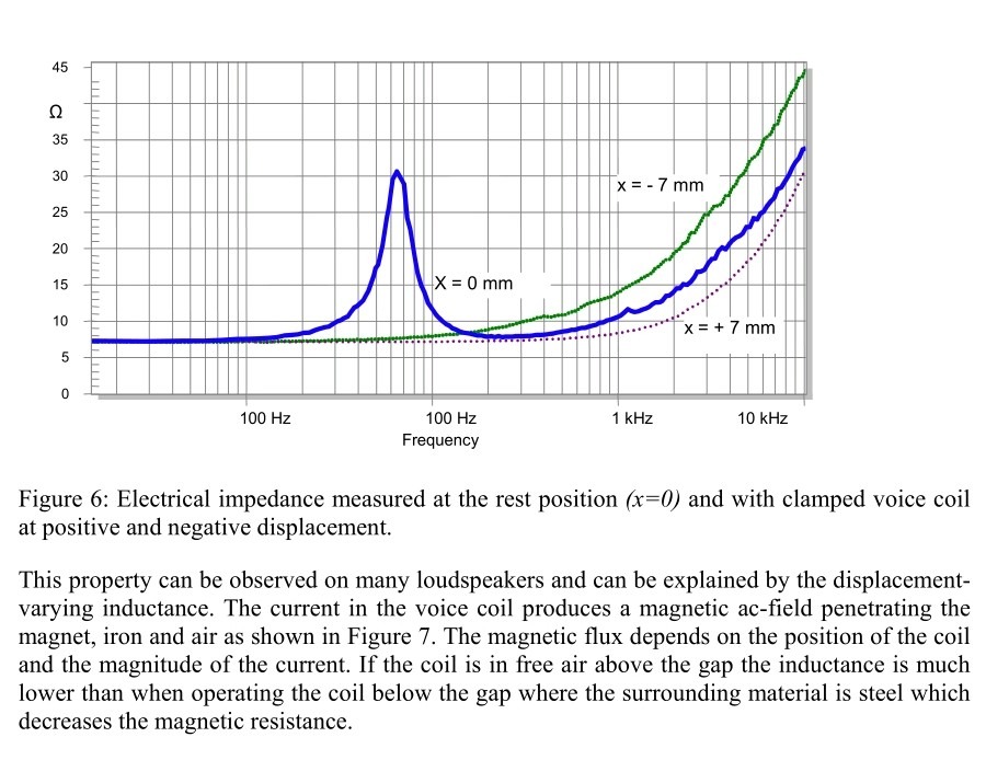

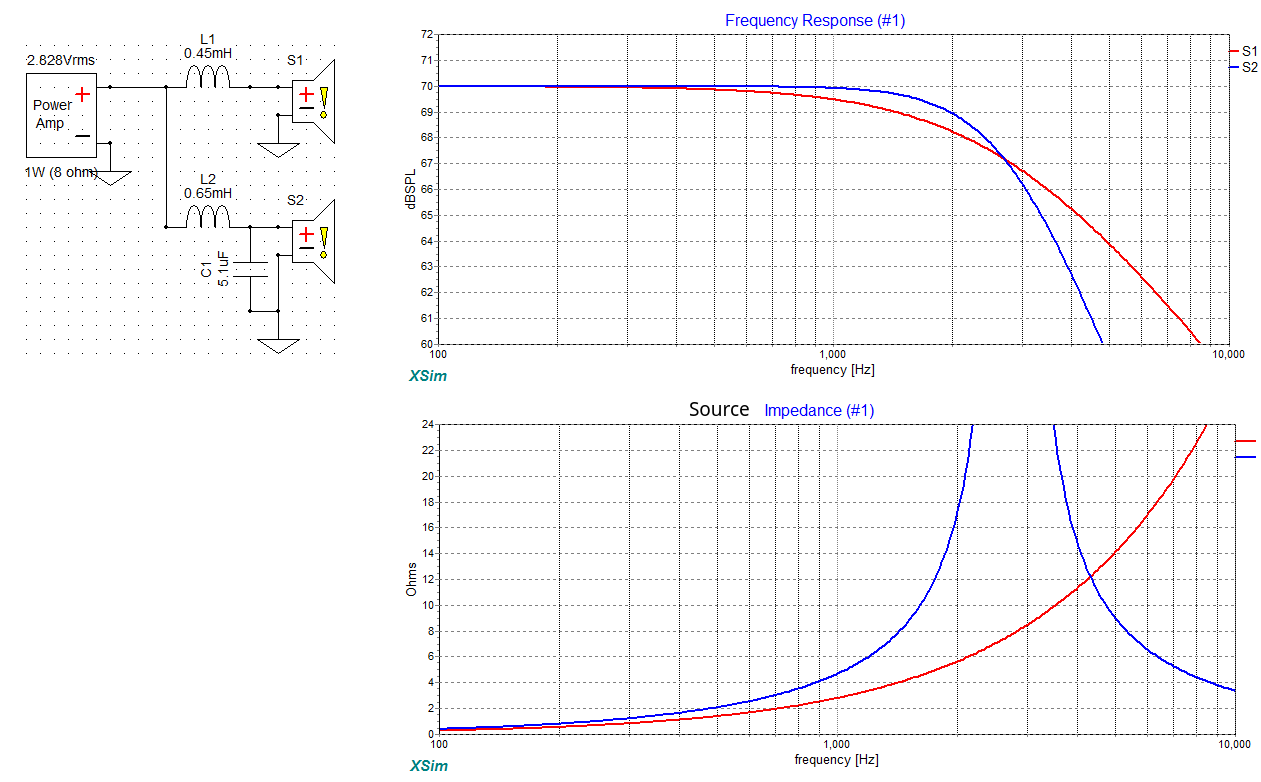

IMO inductance modulation is the elephant in the room that active designs often struggle with overlook altogether. A 1st order passive low-pass is a quick fix (the series impedance helps keep the current proportional to the amplifier input voltage, in spite of non-linearity of the speaker).
2nd order passive filters lose this benefit because of the capacitor added in parallel. It short-circuits the speaker at high frequencies, forcing current to flow, causing problems (and maybe even fuel myths about capacitors having peculiar sounds, when there's some real physics going on).

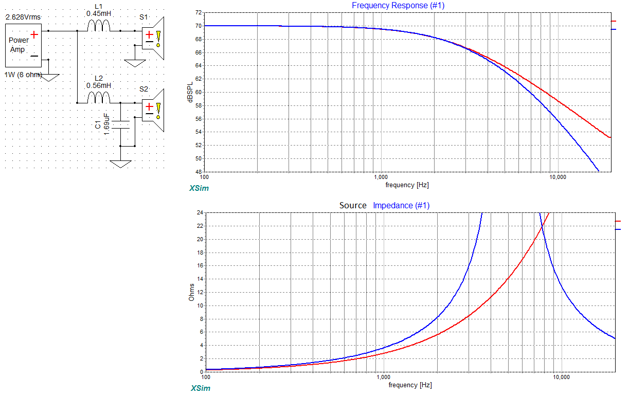

Some of the First Watt amplifiers (especially F2 with its 80 ohm output resistance? IIRC) could be a good match to a well-made active XO. That way the output impedance is built into the amplifier, and the active XO can be designed from the ground up to EQ the response.
The source being the amplifier or the speaker? If looking from the amplifier, then yes, but if looking at spurious voltages generated on the speaker side, then that would reduce the impedance seen from that side. (But please double check as I'm often wrong).
The source impedance could be described as the impedance the driver sees looking out at it's terminals. In other words if there was no crossover then it would only see the short circuit of the amplifier, so any finite impedance you see in that plot is the result of the crossover components.
You are correct that the capacitor shorts this, but as can be seen comparing the red/blue (first/second order) it happens above resonance, when the response is already down.
