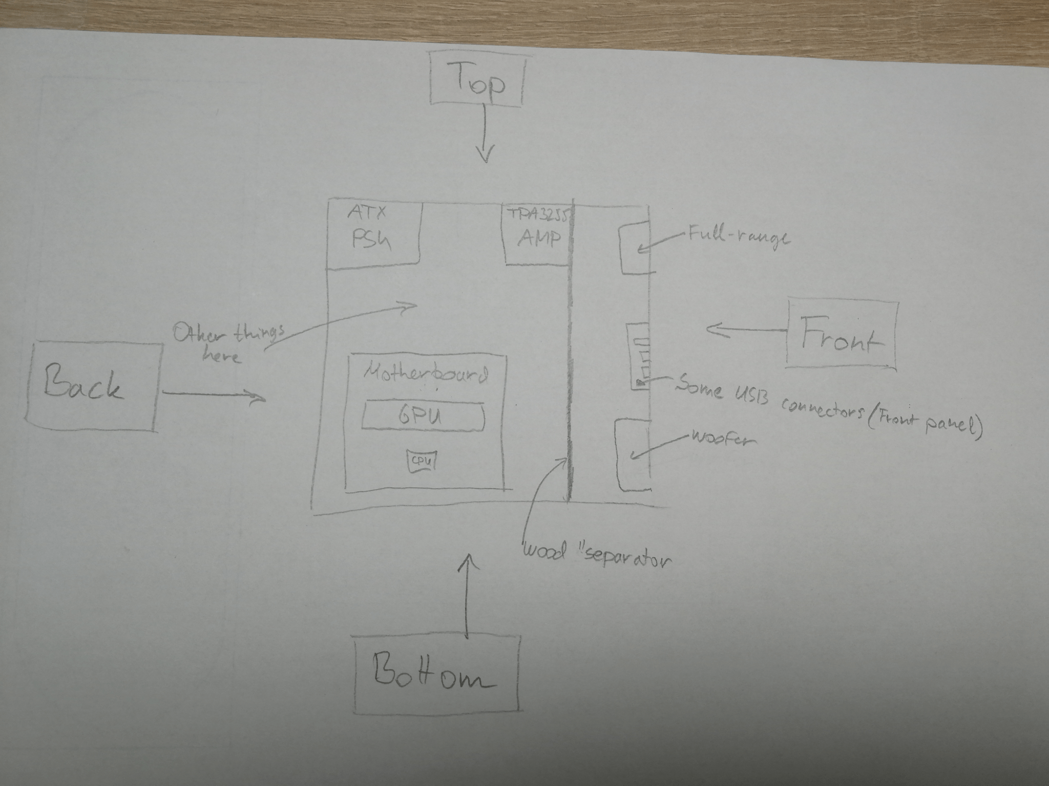

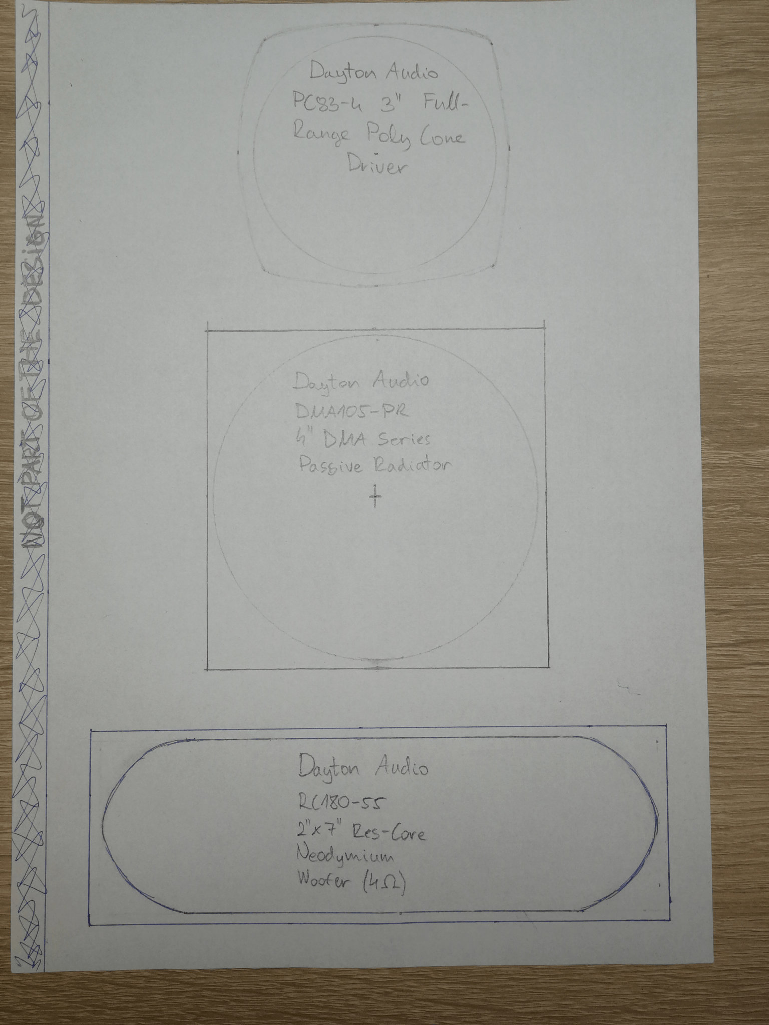

I have drawn a "beautiful" drawing about the front of the pc ( I don't know if putting a PR on the same side with the woofer is good or not. So please correct me if I'm wrong! ): It's size is the real 20cm X 30cm (almost an A4 paper)
And I also drew a "half-cut" drawing of the whole thingy. Here it is:
No, I guess it'll be mono. (The community decides this...)
What are your thoughts about the newly modified thing?

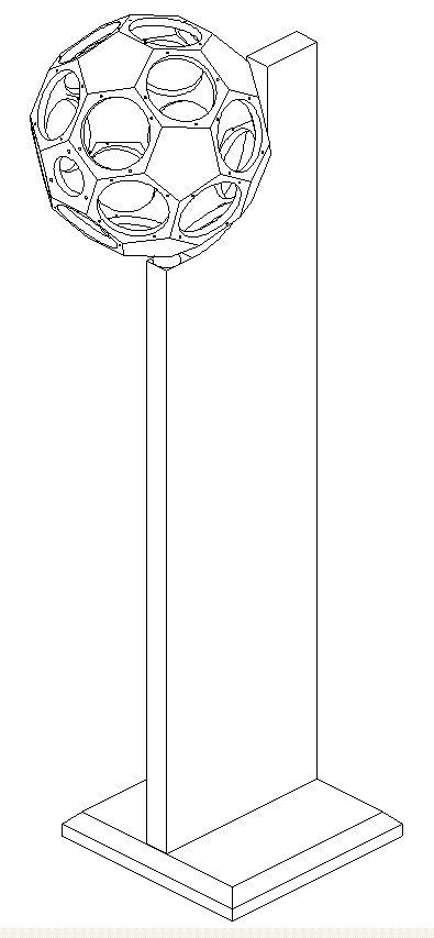

I once made the (rough) cad drawings for a speaker based on the form of a Buckyball. One of the pentagons having the tweeter pointing at you and all 20 hexagons with a wideband speaker on them. Maybe I can find those files back somewhere. Never got to build it as I saw no way to cut wood at the angles needed or how to put it together if I could have the wood cut.
Reactions: Alie-nSoundSystems

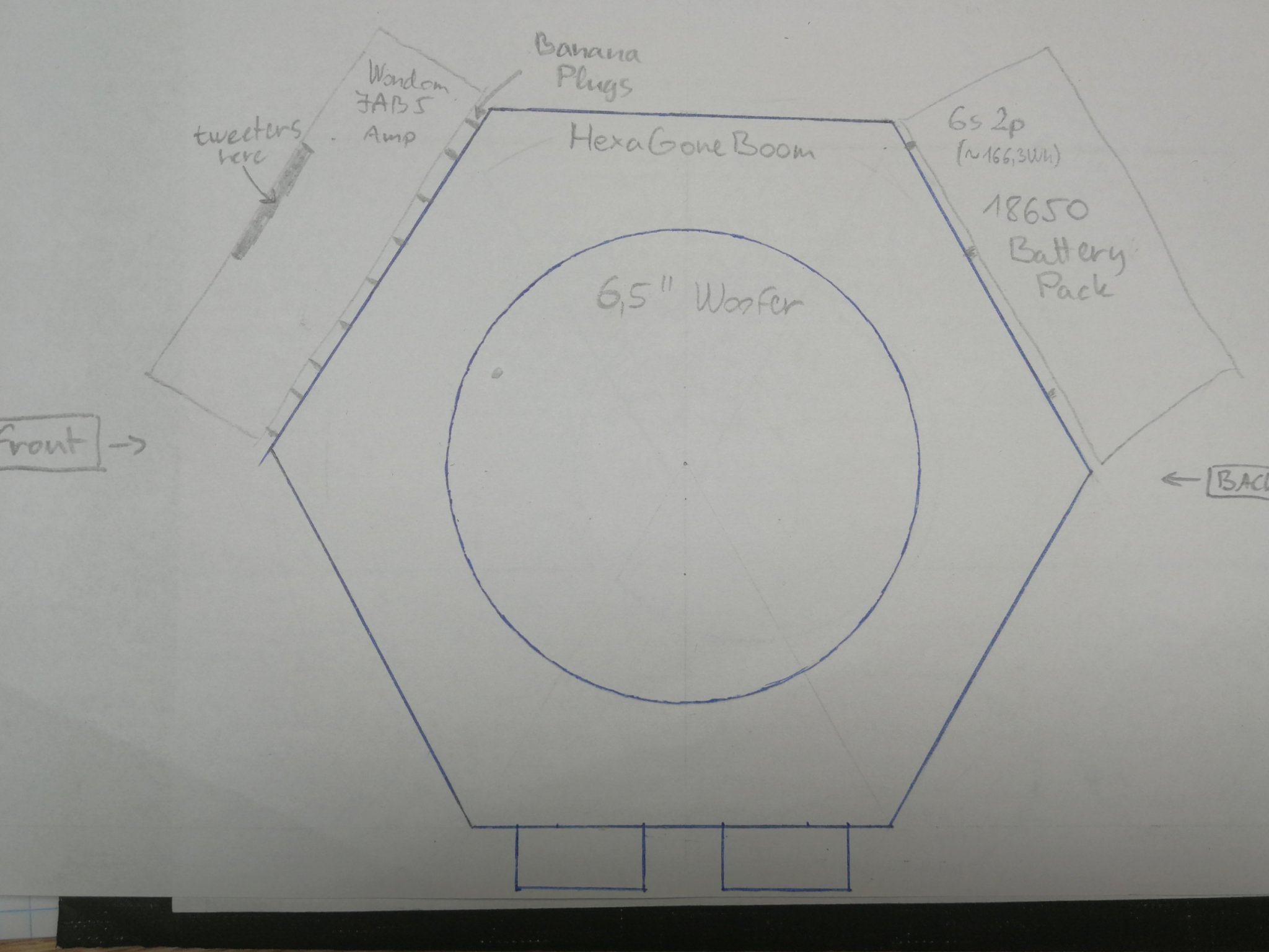

@Havoc Yes, that would be a good idea. Yesterday, I drawn 1 (littlebit) similar and 1 random ideas to make.
- The first is a hexagonal shaped boombox with two 6.5" woofers and two 1" tweeters (I will send its drawing. And I will definitely make this boombox for myself, if it'll be great then I'll make a product from it.)

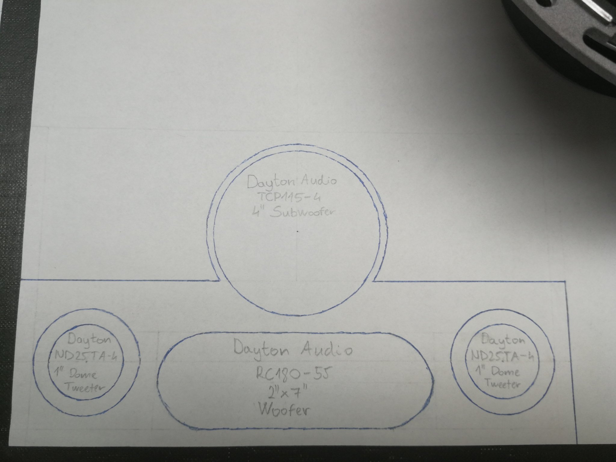

- The second is a strange-shaped "boombox". I will send the drawing of it because it's hard to write its looking and the drivers down.

Hi Guys!
Finally I'm able to send you my newest designs.
So, the first is the design what I'll make for myself and test it. (, if it is any good then it can be a product.)
The second is also an idea, if I will finish the HexaBoom then I'll test that, and (I think) it's a quite nice design.
What do You think?
