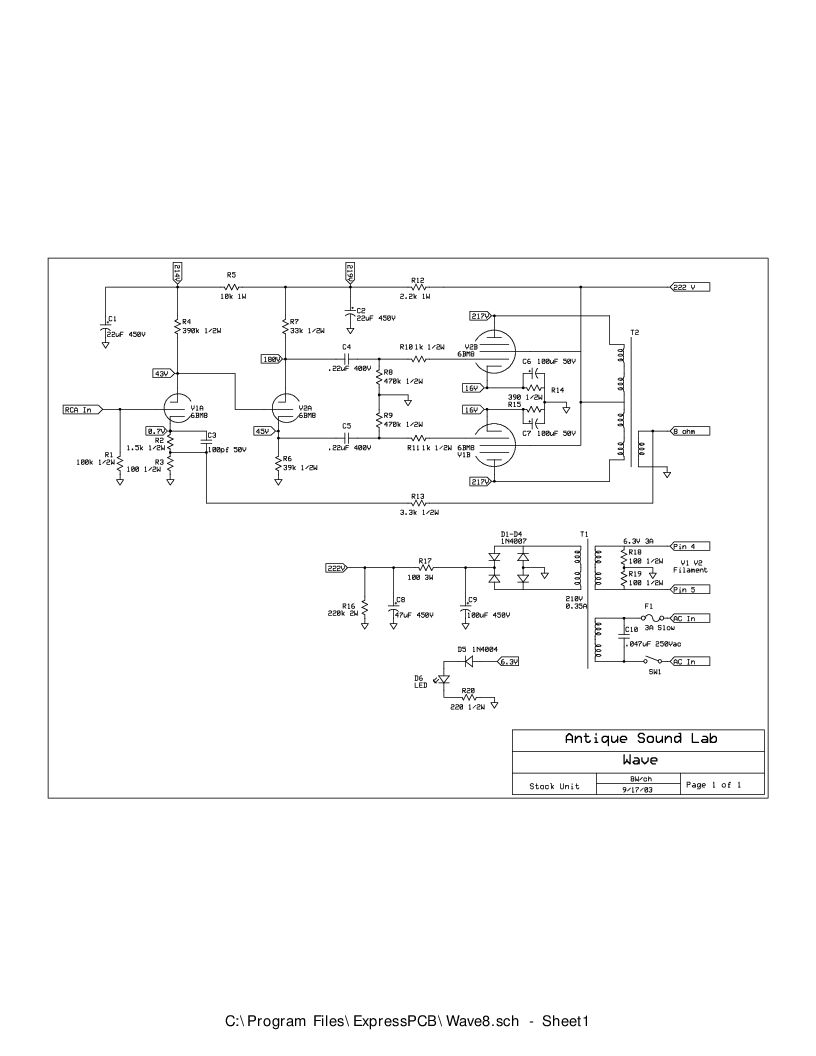

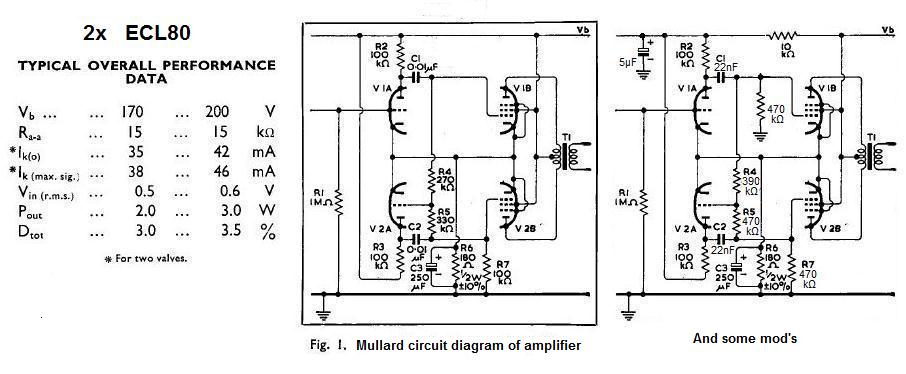

The 6GW8/ECL86 is scarce. Solve the heater supply issue and the more, if not readily, available PCL86 is a possibility.
The 6BM8/ECL82 remains relatively easy to source and was used fairly recently by ASL in monoblocks that attracted some following. ASL's schematic is provided below.

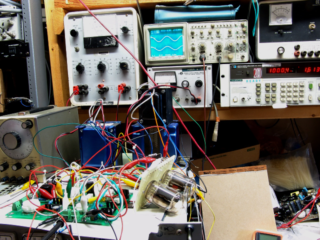

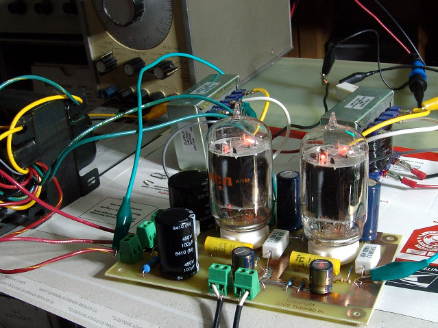

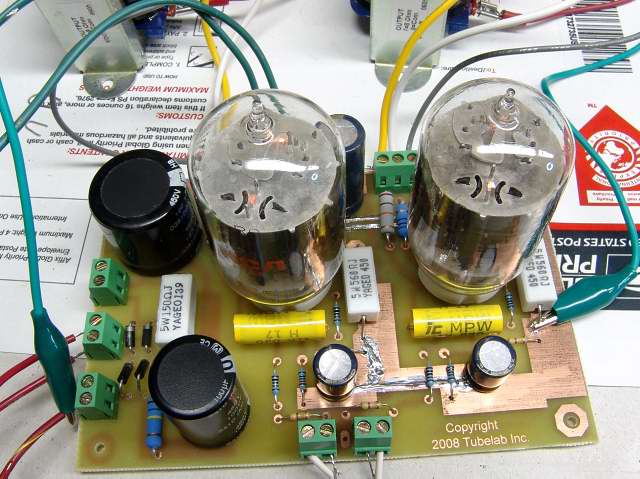

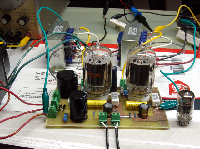

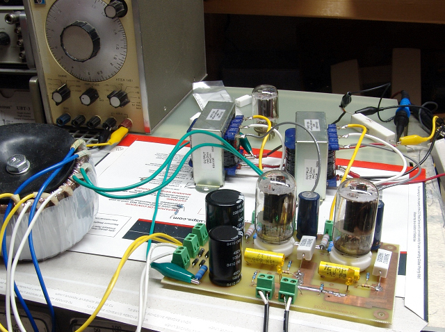

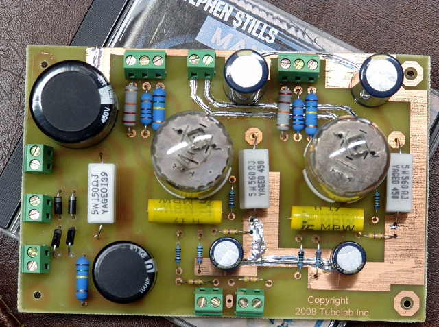

Several DIY two tubes per channel P-P amps have been made using the 6LU8 - 6LR8 - 6MF8 triode/ pentode tubes intended for vertical sweep (frame output) in a TV set. I made a breadboard version of one and managed to squeeze over 30 WPC out of it without undue stress to the tubes.
Several versions have been seen on this forum, but the schematic is similar to the one shown in post #8. You could run it at 300 volts or so of B+ into a 5K CT opt for 20+ WPC, but I ran mine at just over 400 volts on the main B+ and just under 300 volts on the output tube screens with a zener / mosfet filter to drop the B+ to the screens. Power was about 35 WPC into a 6600 ohm OPT. Trying a 5K opt made well over 40 WPC, but brought redness to the plates of the output tubes.
These tubes may not be too common in the UK or Europe, but are still in plentiful supply here.
The 6LR8 is a 9 pin Novar tube similar to a Magnoval but with smaller diameter pins. Sockets may be hard to find in the UK. The 6KY8A is a smaller 9 pin Novar tube with the same pinout as the 6LR8. 20+ WPC can be had from them. The 6GF7 is a dual triode in the same package. All have the same pinout except pin 7 is a NC on the triode, so they can all work in the same amp.
The 6LU8 and 6MF8 are 12 pin Compactron tubes. The 6LU8 is identical to the 6LR8 except for the base, both are stout tubes capable of more than the 14 watt dissipation rating. The 6MF8 has the same pinout as the 6LU8, but carries a 12 watt plate rating and has lower transconductance. You can still get 25 WPC from two of them. There are also smaller sized variants of these tubes with the same pinout, but I don't remember the numbers.
I made the breadboard in true Tubelab style by wiring Novar tube sockets up to an early prototype of the Tubelab SPP board. That board uses a single 12AT7 and 2 X EL84's or 6CW5's per channel. I never made a board for the P-P version, and the pictures for the prototype were lost when I dropped my computer.
I made a SPUD SE amp that fit the Novar tubes. It just used one tube per channel. It started out as a furball of wires connecting a turret board to a SSE board, and evolved to a PC board. The SSE uses 1/2 of a 12AT7 and typical octal output tube per channel. I had the board set up for 6EZ5's at the time. The 6LR8 triode is similar to 1/2 of a 12AT7 and it's pentode is like the 6EZ5. I used 6LR8, 6KY8, and 6GF7 tubes in it.

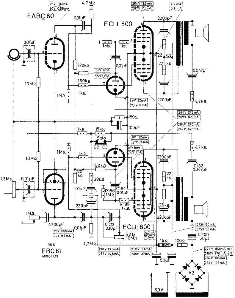

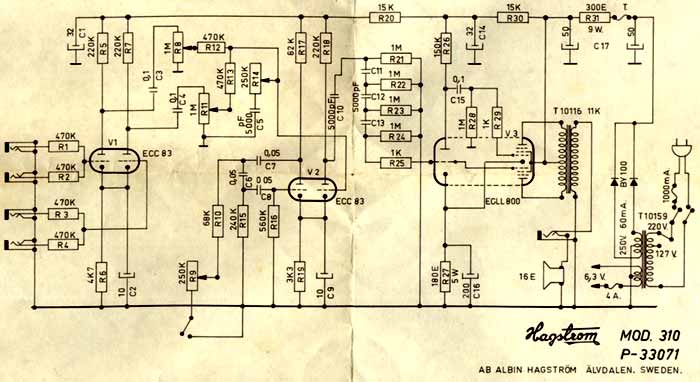

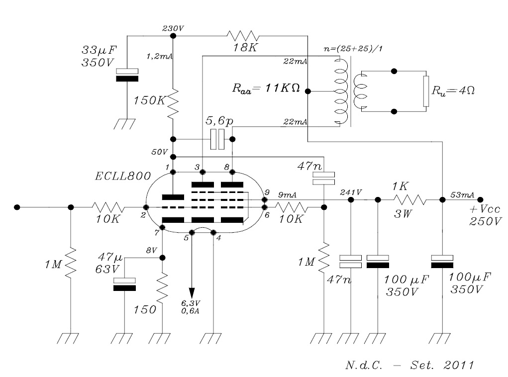

It is possible to build a mono push-pull amplifier with a single tube ECLL800 / 6KH8 . It is a compactron-like device with two power pentodes and a special phase inverter triode. This now scarce tube has been mostly used on early stereo German table top tube radios, add-on powered speakers (to add the second channel to a mono record player), and even some guitar practice amplifiers. Power output can reach 9W, but on cost-optimized design 5W is a more likely outcome. Those designs had flaws that made this tube disappear rather quickly from the market. Tube was expensive and life was limited, due to the very high heat that had to be dissipatesd in a cramped space; the output transformer required a high (11k) impedence: it was impossible to get good low frequency response from the tiny transformer that had to fit on those compact designs.
To get full power, 8V are needed at the triode grid: a modern low impedence 2V source can be directly connected with a 1:4 input transformer. I wonder if a similar tube had ever be manufactured in the compactron range.
