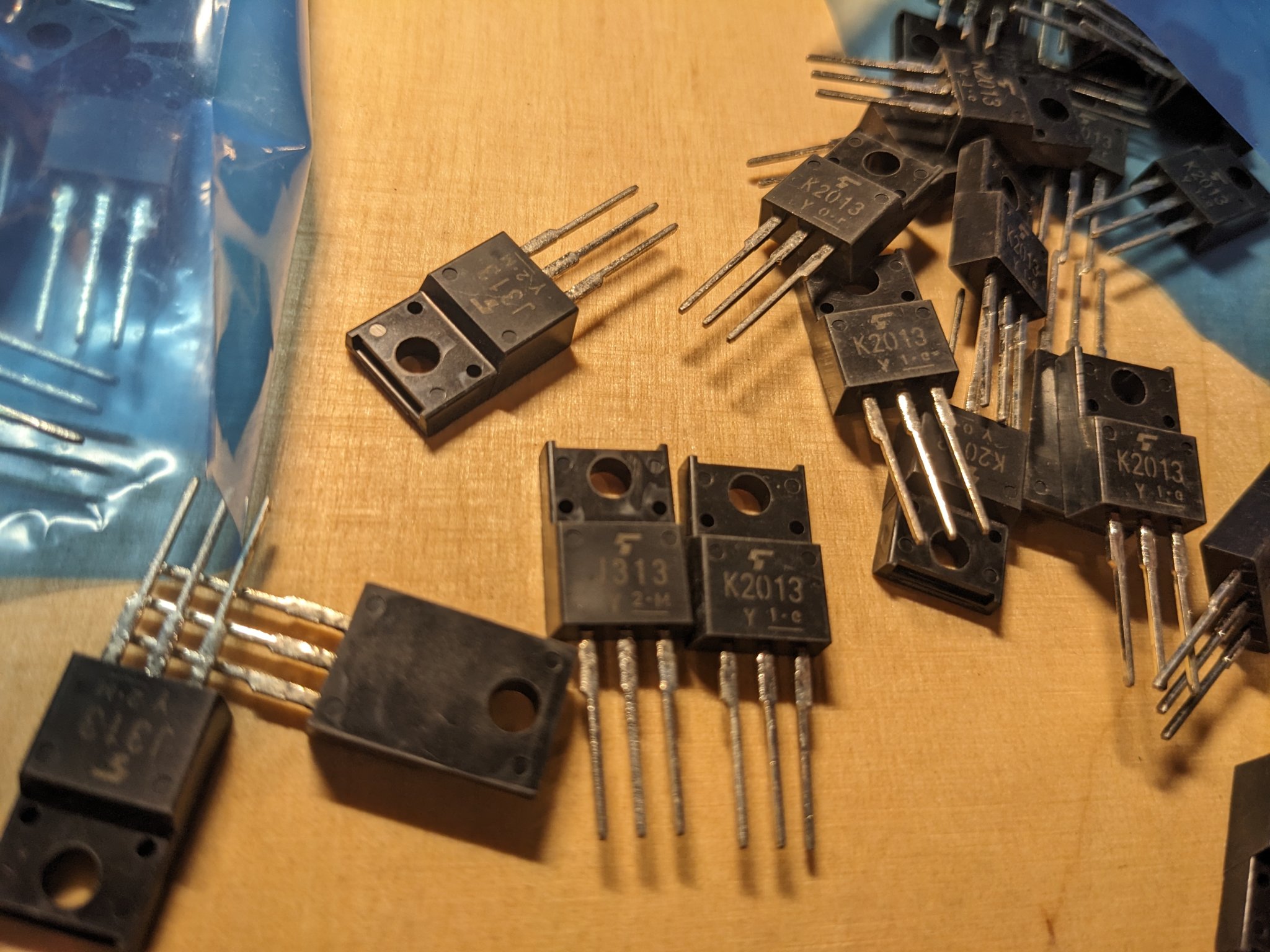

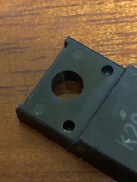

I really spent to much money on Fake parts, However, there are way to identify these Toshiba parts may this helps.Dear Ggetz and Tamra,

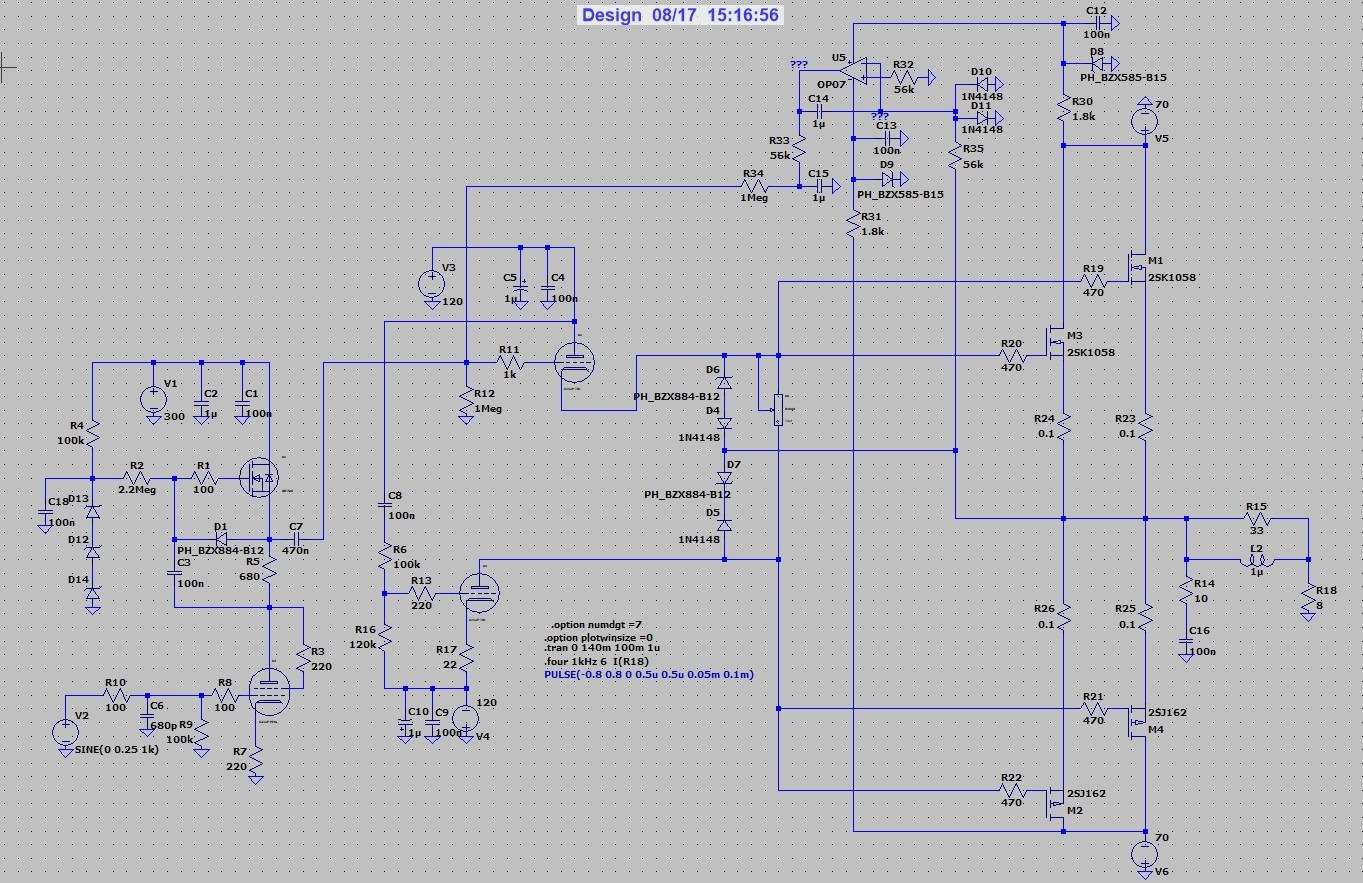

- 2 stage, fully differential, very little FB, +160Watt amplifier
