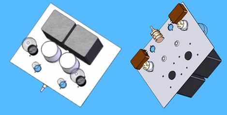

PSU/mains will not be anywhere nearby. I've just made a nice solidworks layout for dual mono with external PSU, and I think that'll be the way to go. You are right about the sensitivity, it will be low, but then again my power requirements will not lay anywhere near the 600mW-700mW this beast can put out at 4Vrms swing on the grid of the 26. I'll most likely never pull more than 100mW out of it, and that is in extreme cases only, the speaker sensitivity is above 114dB/W/m, so even with my 2.5Vrms output DAC, I think passive preamplification will be an option no matter how crazy it sounds..

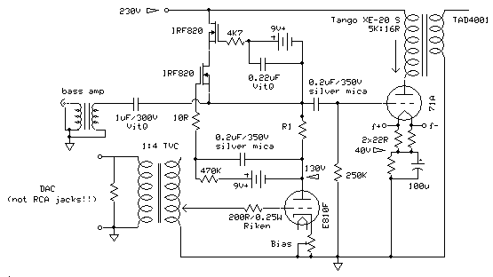

Looks like this amp took quite another turn than expected, the driver tube is not going to be a DHT at all, sorry to folks who thought this was going to be a pure DHT project, it is not.
I found out I wanted and needed the gain some IDHTs provide, and I am thinking about e810f/7788 (triode wired) as I have them handy. I just got my hands on some step-up TVCs I will use at the DAC input, wich with an 1:4 step up ratio and a CCS-loaded e810f triode with mu of 70 (can this be right?) will provide a gain of about 280 at full volume wich in turns mean I can start looking for other DACs than the TDA1543...
The CCS will be battery biased, I've gotten some 0.2uF/350V/0.3% silver mica capacitors I will use both for coupling and bypass of the lower battery in Pimm's BBMCCCS. I plan to double-load the CCS mu output with an extra parafeed step-down stage for pre out for my bass amps (they have to be tapped here to be controlled by the TVC).
Waiting for some other stuff, a stepped volume switch, some sockets, etc before I can start build. I'll have to get a chassiplate for it too, and that'll first come after christmas holydays. This is how it looks at the moment, comments are welcome.
I ended up doing this all-DHT in the end.. very similar to the schematic I posted exept the UX-112 serves duty as driver. Brought it to the lab here the other day and did some tuning, it sounded very very good on my grado headphones but there was noticable hum. Everything was powered with lab-supplies though and I really plan for SLA batteries on the filaments, so maybe that'll better things. I am building it into a proper chassis soon, but the IAG chassis I ordered a month ago at iagaudio.com still hasn't arrived.. 🙁 If i'm lucky, and get my IAG chassis soon, I might be able to finish it up within two weeks, before I have to attain a mil excercise upnorth for 3 weeks.. when i get back from that I have four weeks unntil my engineering exams, so not much time for hobbies these days

- following this I could use something with mu = 20. I know the 2C22 stage sounds excellent - almost DHT. My question here is the same as yours - is there a DHT with mu >15. There are some quite obscure possibilities - DCC90, 3B7, 3A5 in doubles, and in singles DC93, DC80, CK5676, 1LE3, 3A/142A, 3A/108 and some others. I can't see myself using any of those, and chums that have used some found them microphonic. So I think here we will stay with 2C22. Other possibilities are 6S4, 76, 6P5GT and such. Maybe ECC40 or E80CC which is about as much as I find myself liking in smaller tubes. And the loctals 7N7, 7AF7, 7A4 etc.
The gain of this three stage setup is OK for me - it's balanced so that helps too - and the Russian teflon coupling caps and stepped shunt attenuator don't interfere too much with the good sound. Keeping everything in one amp simplifies the topology and allows small value coupling caps, since the teflons come in 0.1uF. The DC on the DAC output gets absorbed by the CCS under the 26s.
The output tubes - 6AH4 - have a mu of 8 so I may be in trouble with gain if I use 2a3s which I certainly want to try. I also want to try 71A in the outputs and some others like 1624 and 1626. This is where it gets tricky again - I want to keep the 26s in the first stage - they just sound so good. So if I need more gain I may need to go above mu=20 for the second stage, and that's the question you seem to be asking! Mind, with horns, you gain sensitivity, but then on the other side you are SET. Andy
