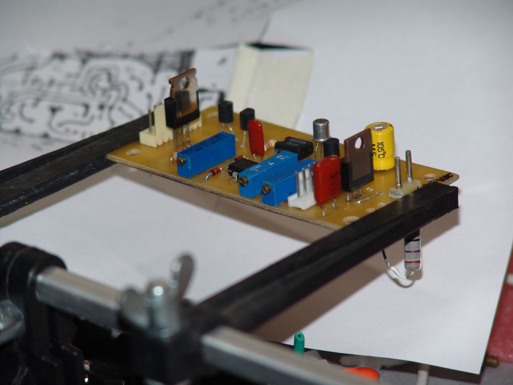

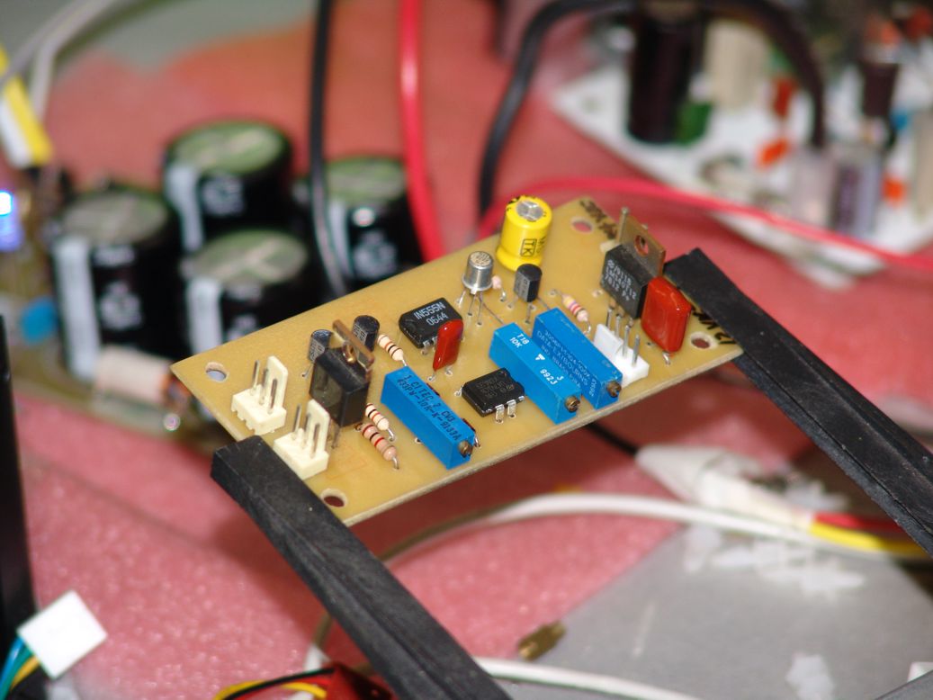

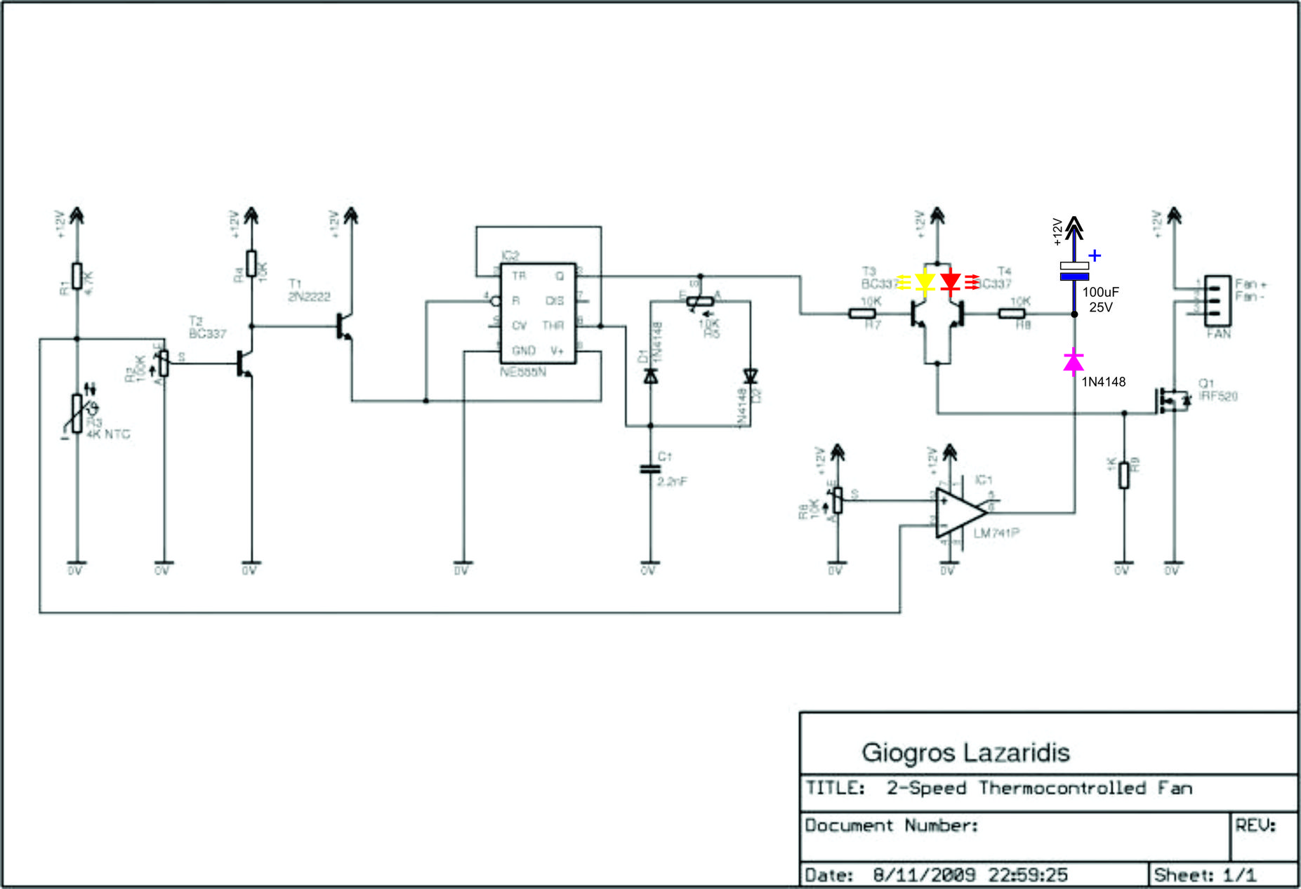

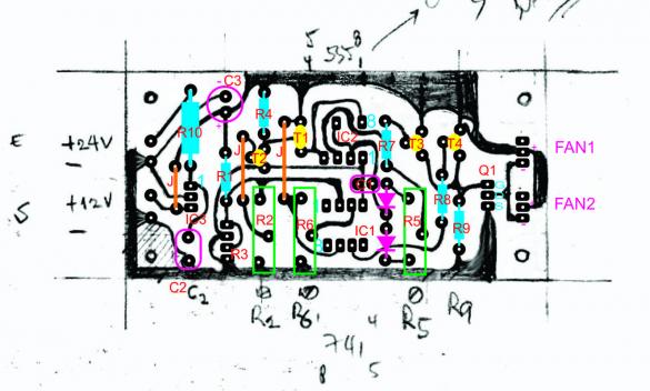

For those who don't like large heatsinks, this fan controller is a good choice.
It is well explained here: Two Speed Temperature Fan PWM Controller - Electronic Circuit Schematics
I slightly changed the circuit to use dual sensors and dual fans, and to be fed from a 24VDC input.

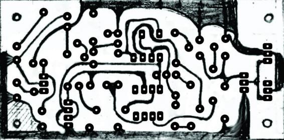

I need support to draw a decent PCB layout!

a suggestion for a little improvement.
Can you insert a timer to allow the opamp to kick start the fan motor with full voltage?
When the timer expires, the NTC determines whether slow speed or full speed is required.
I've inserted a diode in series with opamp output, and then a capacitor from +12V.
It works fine, thanks. It is good to cleanup dirt!
I've also inserted two LEDs, between T3 and T4 collectors and +12V, in order to monitor controller's state. Yellow for mid speed, and red for full speed. So, during power-on, red LED is lit!

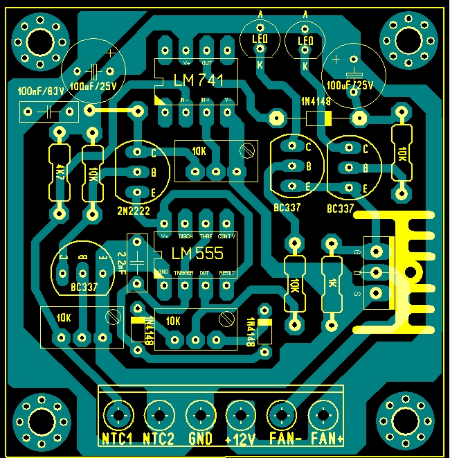

Yes Max I'm here....
but not with empty hands 🙂 I hope you like it .😉

PCB
Hi alex mm in pcb of smartx21 is used 2 FAN, could be included in your drawing of pcb the second fan?😕

can you pls share pcb copper side i want to try build this one..TYbut not with empty hands 🙂 I hope you like it .😉

I am confused as well.
So will I need 2 boards for 2 fans ?
Or can I just parallel 2 fans and connect them together ?
I am thinking of using this controller for a 100W amp, in which both channels are mounted on a single heatsink.
