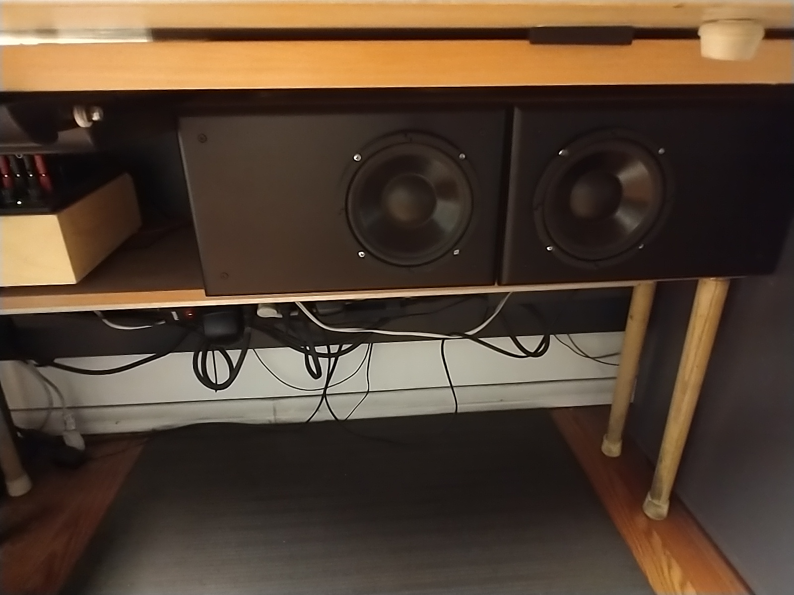

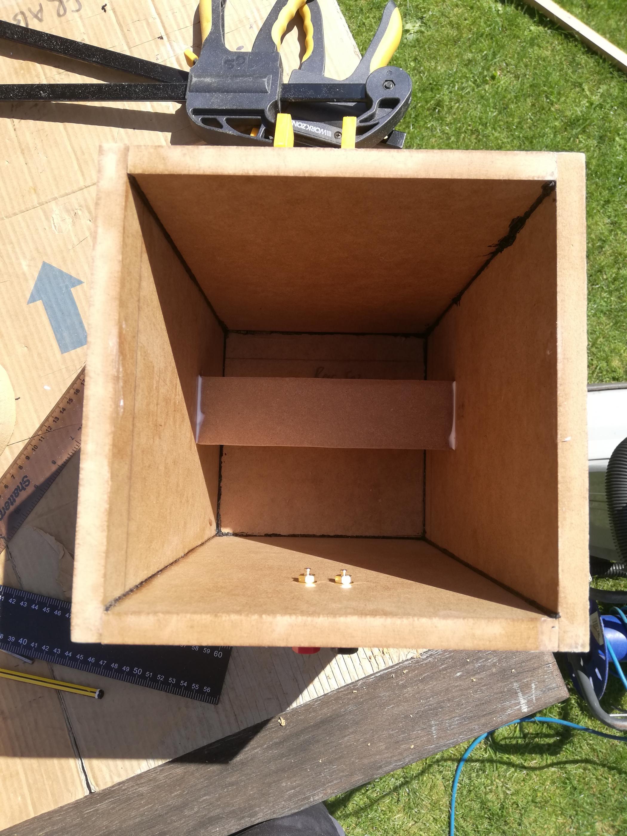

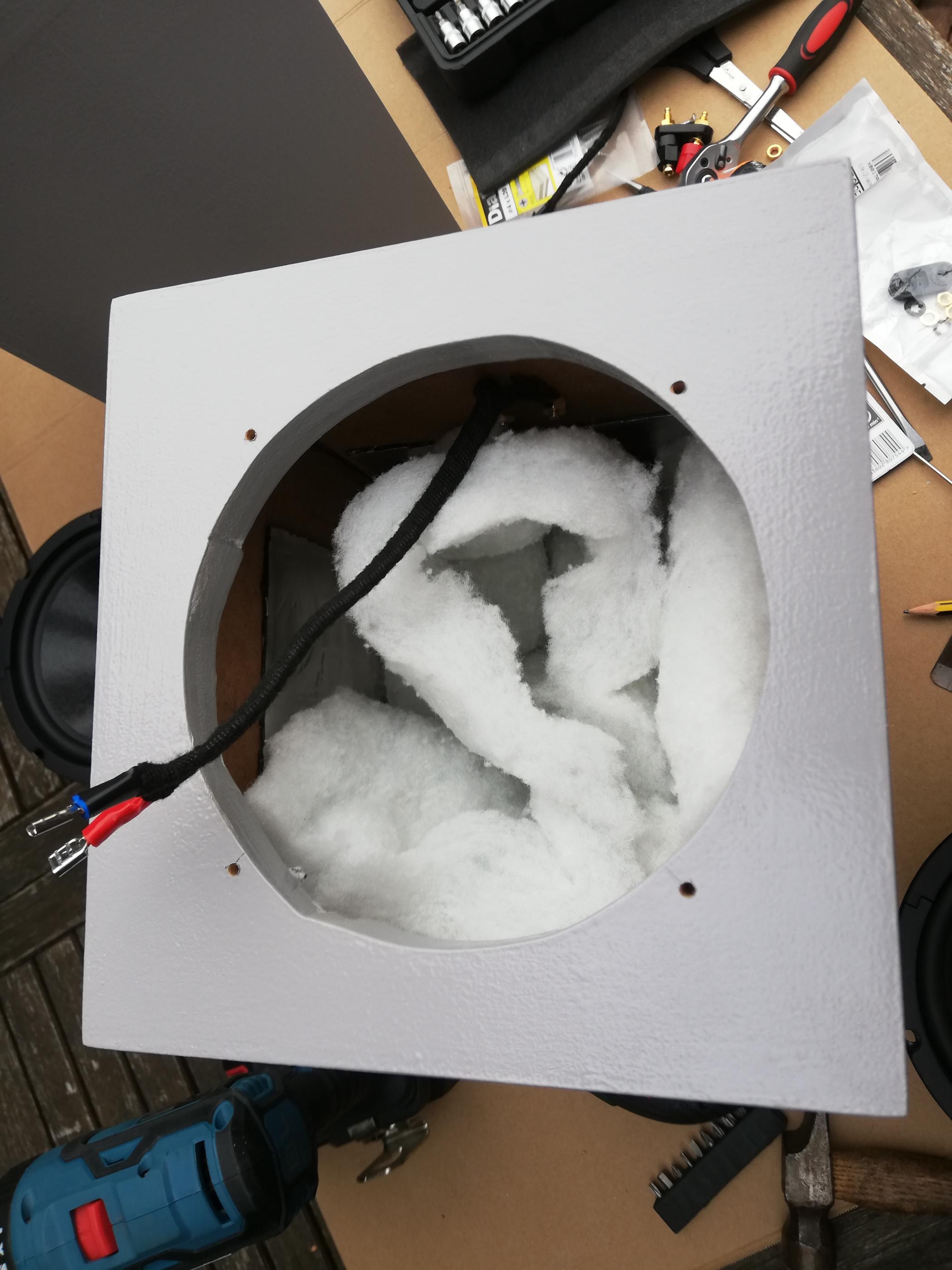

An update - I finally got round to building 2 enclosures for 2 x Dayton DC-160-4 drivers - 1 per enclosure. Net result - very pleased.
Each enclosure is approximately 32.5 cm x 20cm x 20cm. Front baffle 18mm, the remainder being 12mm MDF. All joins are sealed, side panels fitted with Silent Coat automotive sound deadening and what I call a T-brace fitted. Woofers mounted at one end to allow for different positioning options.
I originally tried them full range - pretty good but with obvious treble roll-off. I then trialled them in the bedroom system (Arcam Movie 2.1/Piega TS3 speakers) with the Arcam’s internal crossover set at 60hz. Power was provided by a 20 WPC Temple Audio Bantam Stealth (great little power amp) and each ‘bass module’ was positioned near its corresponding main speaker. The best result I found was to be upward firing. Integration was very straightforward - no boom whatsoever. Just smoothly integrated bass that supported the main speakers and made them sound considerably larger/full bodied than they were originally - the Piegas are surprisingly able for their size anyway.
The above results were so good that I am now contemplating building something else for the office (and finding something suitable with an adjustable lpf to power it) and keeping these for the bedroom. The advantage of being small, light and passive is that they can be unplugged and stored away when not being used. The total build cost was about £80 for the pair including £20 per woofer, £30 of MDF and about £10 for sundries, including cables and speakers terminals. The paint and other bits I already had in.

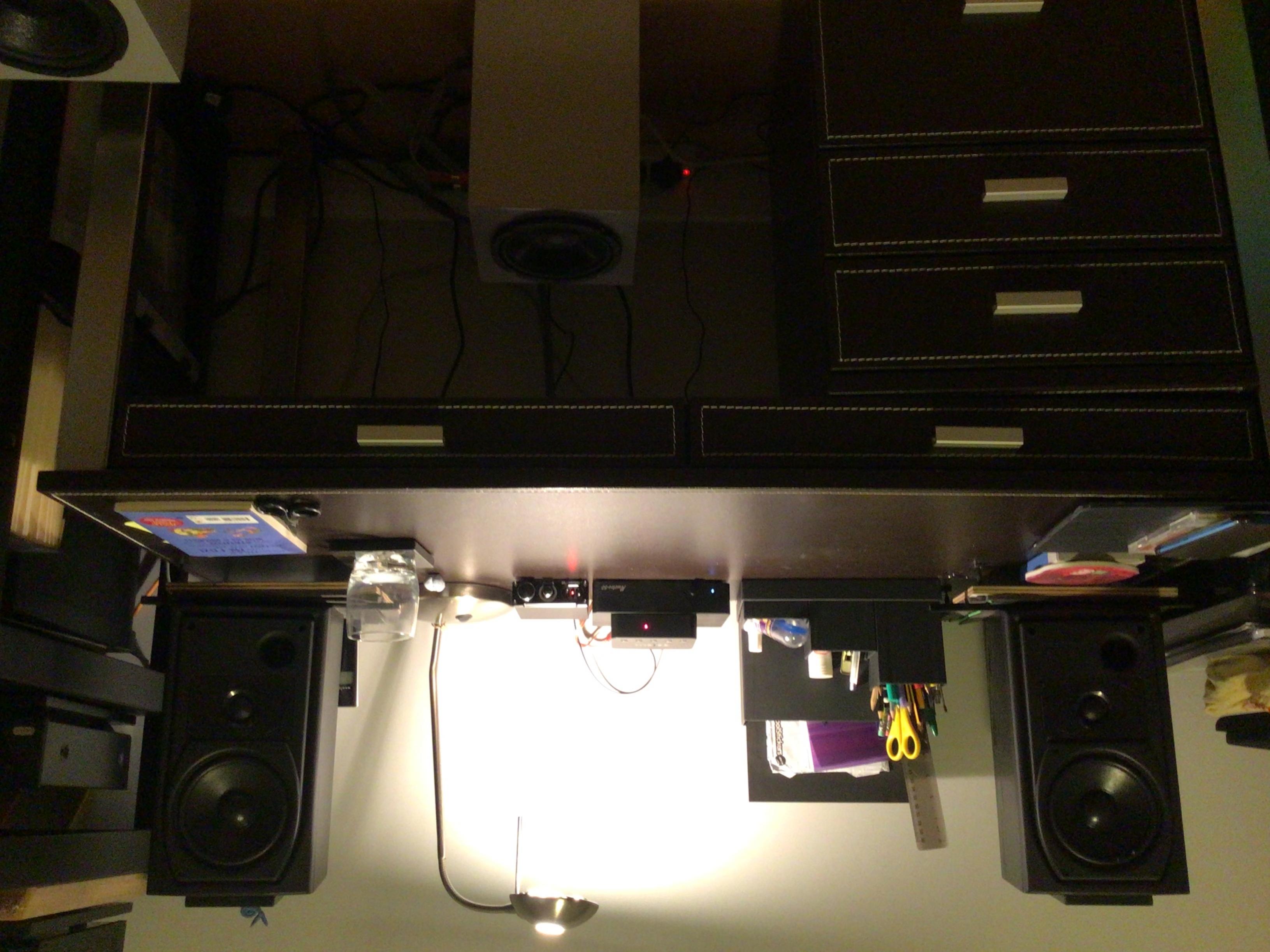

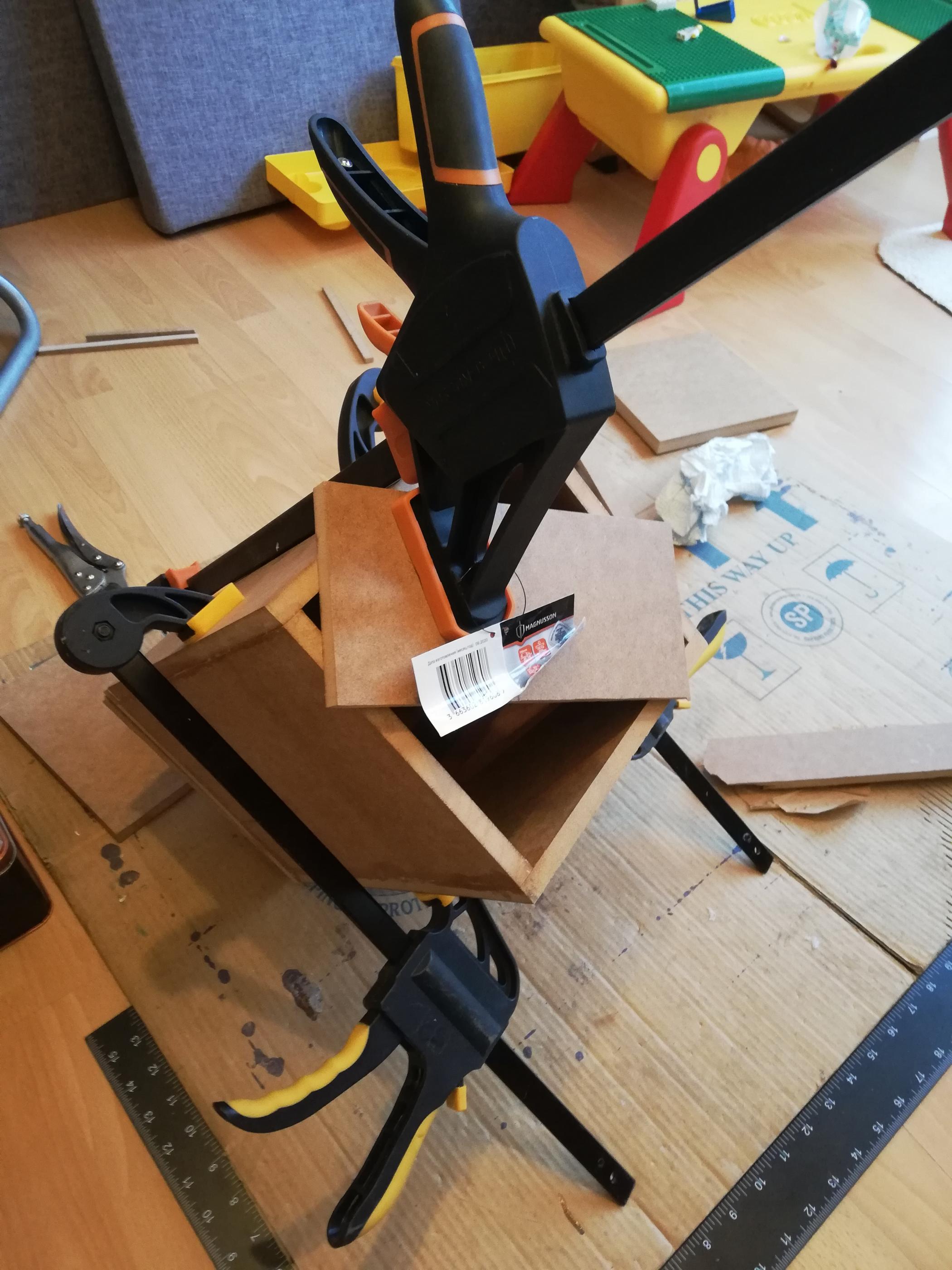

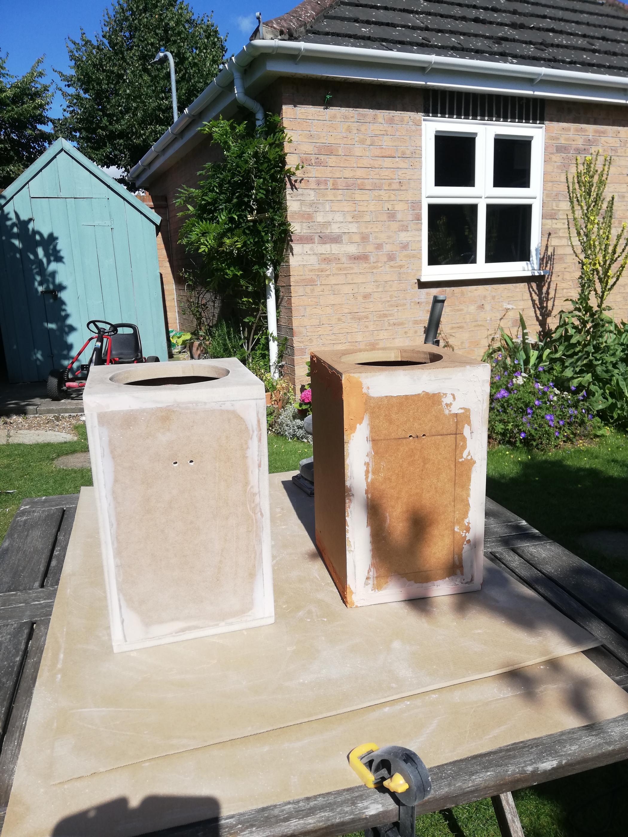

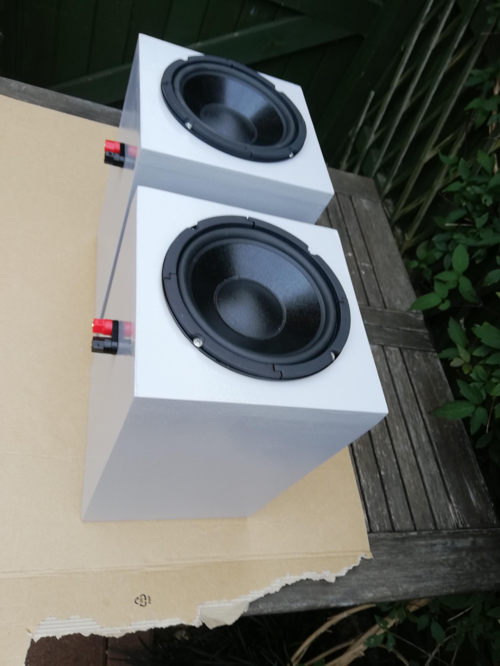

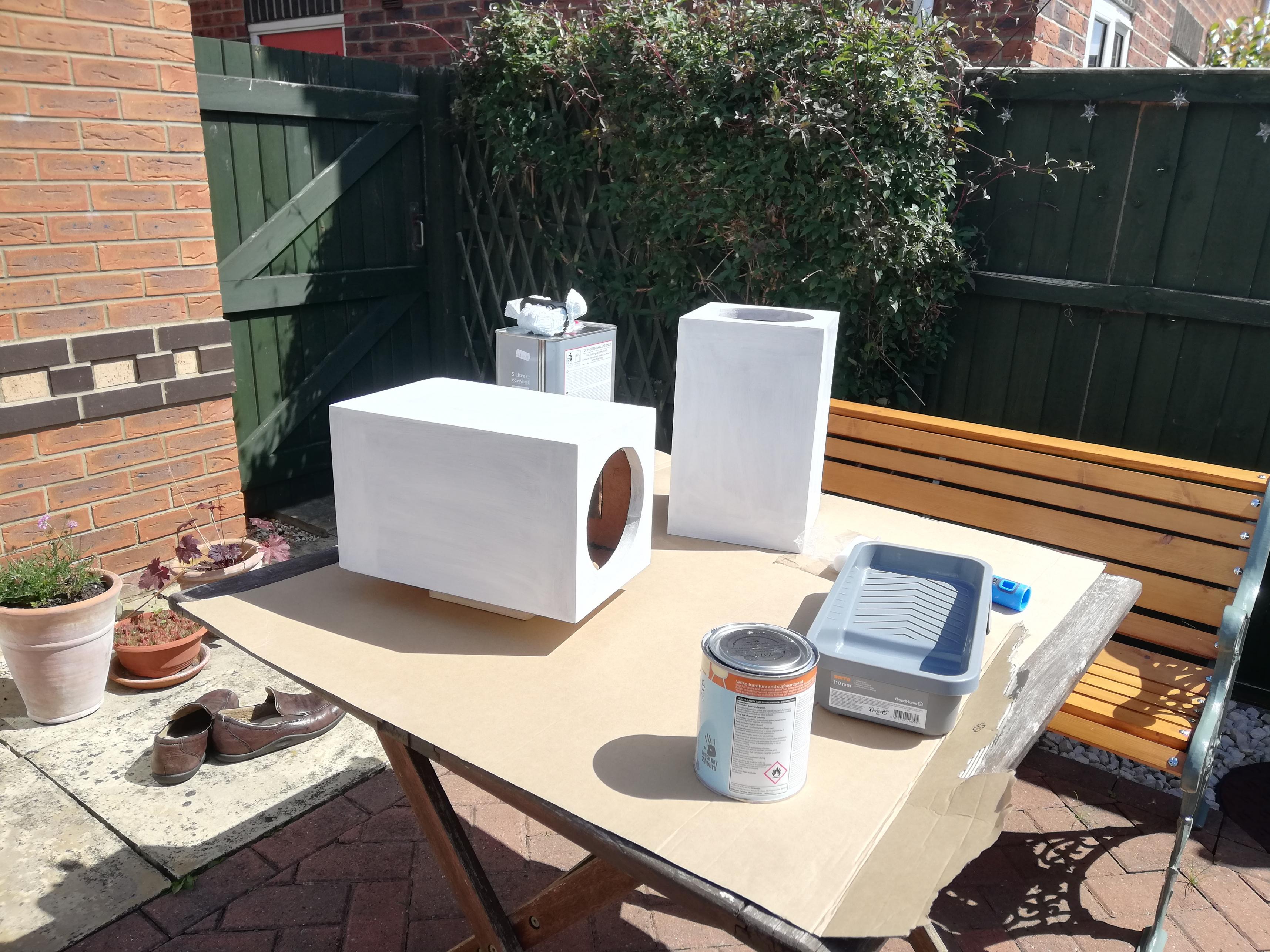

I have attached pictures of the ‘build process’. In the end I purchased a Nobsound (my wife finds the brand name amusing) G2 subwoofer amplifier and I am currently trialling it with just one subwoofer. TBH in the office the combination provides plenty of output. The amplifier is supposed to be 2 ohm stable (unlike the more powerful G2 pro version) and has a 40 - 300 hz LPF, though there are no increments marked - I have largely tuned it by ear using an educated guess of where the frequency is on the dial. I am gradually turning the volume down which in my experience is always a good sign! The amp has selectable gain settings on the bottom through dip switches - I am using the factory-set 26 db option as the desk amp (see below) has quite a high output through the subwoofer output.
The rest of the office system consists of:
Tibo Bond 3 streamer / Arcam Alpha 5 CDP
AVA Media Maestro 50 fully digital amplifier - no analogue inputs.
Mission 731i speakers
Sometimes I swap the AVA with an Arcam A18 if I want a bit more power - obviously an all analogue amplifier. They both have their own merits.
Regards
Alex
Sorry that one of the pictures is upside down - I’m not sure how to change this.

The one thing I’m not so happy about is the paint finish. I contemplated spraying the boxes but, bearing in mind their intended use where they could get kicked and knocked by the office chair, I thought a durable and easy to touch-up finish would be best. I used a paint that has proved itself on our kitchen cabinets and a roller to apply it. I like the colour but would have preferred it slightly smoother. Still, as a first build I’m happy.
