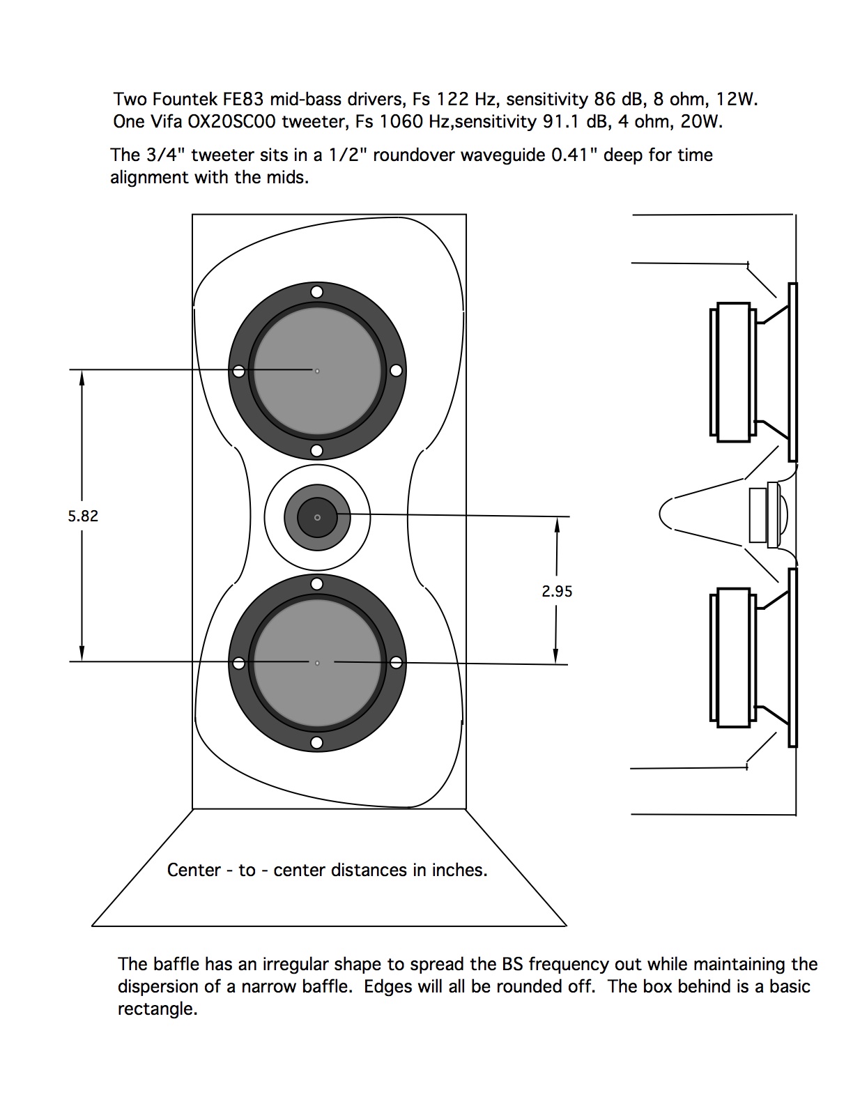

I have been thinking recently about getting a 3-Way MTW project going. I want to try an emulate the nice imaging I get from my small desktop speakers, which are 2-ways using 3" drivers in folded TLs, where the 3" midbass is crossed high (about 5000 Hz) to small mylar tweeters. Even though these speakers are built from surplus/bargain bin parts they sound quite good. I know that is not because of the high quality of the drivers used ;-) It must be the point source nature of the small size of the drivers, and probably combined with enclosures that have very effectively stopped internal reflections, and extended bass performance some.

Some points that I wonder about that maybe you can help me understand more clearly:
1. Two 8 ohm drivers of 86 db sensitivity in parallel. Do I get +3 db, or do I get more for now having a 4 ohm compound driver instead of an 8 ohm driver?
2. I have read the opinion that a true DA design approximates a point source pretty well. By "true" I mean 3rd order slopes, low XO, and, if memory serves, 90 deg phase at XO. Is that true (about the imaging aspect)?
3. Is a true DA really better in the point source sense, and so for imaging, than other ways of rigging up an MTM? I see that Thor, for instance, was not done that way.
In the plan I am proposing I think a true DA alignment could be done with a roughly 2500 Hz XO and still have the mids within one wavelength at XO. Maybe this is a particularly good application for the idealized DA design?
4. In the Statements Holtz put the two mids (also an MTM btw) in tunnels that happened to be of a length corresponding to 1/4 wave at about 300 Hz, which is close to the XO frequency he used. Lots of good reviews of those. I wonder if using a TL on a mid placed at some frequency well above the Fs of the driver results in any roll off below the tuning frequency, or maybe if all it does is to alter the slope of the roll off only below Fs? Which might make it possible to simplify the crossover?
My first experiment might just be to build the baffles, put it the FE83s, and stick pipes on the back to see how it sounds and what the FR looks like.

Here is the drawing in jpg form

Hi Datinker,
Two drivers in parallel give +6 dB in SPL. Assuming a (more realistic) sensitivity of 84 dB per driver you effectively get 90 dB at 2.83V/1m. However, baffle step will steal again some dBs at low frequencies.
Whether two 3" drivers are better than a single 4.5" or vice versa depends very much on the actual distortion profile of the drivers chosen. The vertical dispersion pattern of MTM is symmetrical by definition, an MT configuration always is asymmetrical. But that doesn't make MTM superior IMO. The idea of creating a virtual sound source exactly at the location of the tweeter is tempting, no question, but at a listening distance of 3 m it hardly makes a real difference. The error introduced by crossover and mismatch of the acoustic centers probably is far more important.
Allow me a remark to the irregular baffle. Worst case is a round baffle, because all edges are equidistant to the driver. A classic rectangular baffle actually is quite good in smearing edge diffraction. Hence I expect your irregular baffle rather to be worse than better!

Dissi - 6 db for two parallel drivers - Roger that. I have read it but I wasn't sure I believed it. That is a point in favor of the idea I proposed. You point out that the errors from crossover and mismatch of acoustic centers will likely make the biggest differences in sound quality. That is my feeling as well. Which is why I proposed to match the tweeter depth to the mids and posed questions about crossover slopes.
The point about the irregular baffle probably not being an improvement over a rectangular one is good. It would certainly be easier to make the simpler shape. What do you think about just using a larger radius on the edges of a rectangle in the area adjacent to the tweeter?
452324d1417821209-2-small-midranges-potentially-good-one-large-one-fe83-dappolito-design.jpg
^^ This is your proposed design, using dual 3" woofers flanking a tweeter
Here's a speaker project I published a couple months ago, using the same configuration
Here's the project that I'm listening to at the moment.
Personally, I prefer the latter over the former. Here's why:
1) It doesn't take much of a waveguide to horn load a midrange. A waveguide just 8.25cm deep will load a midrange down to about 1khz
2) Even with dual 3" woofers, I found that the former project could be pushed to it's limits. Basically it was possible to 'bottom out' the woofers
3) The use of unity summation aperture on the new project improves the intelligibility, the imaging, the polar response, etc
Either project is good, but the second one is better IMHO
