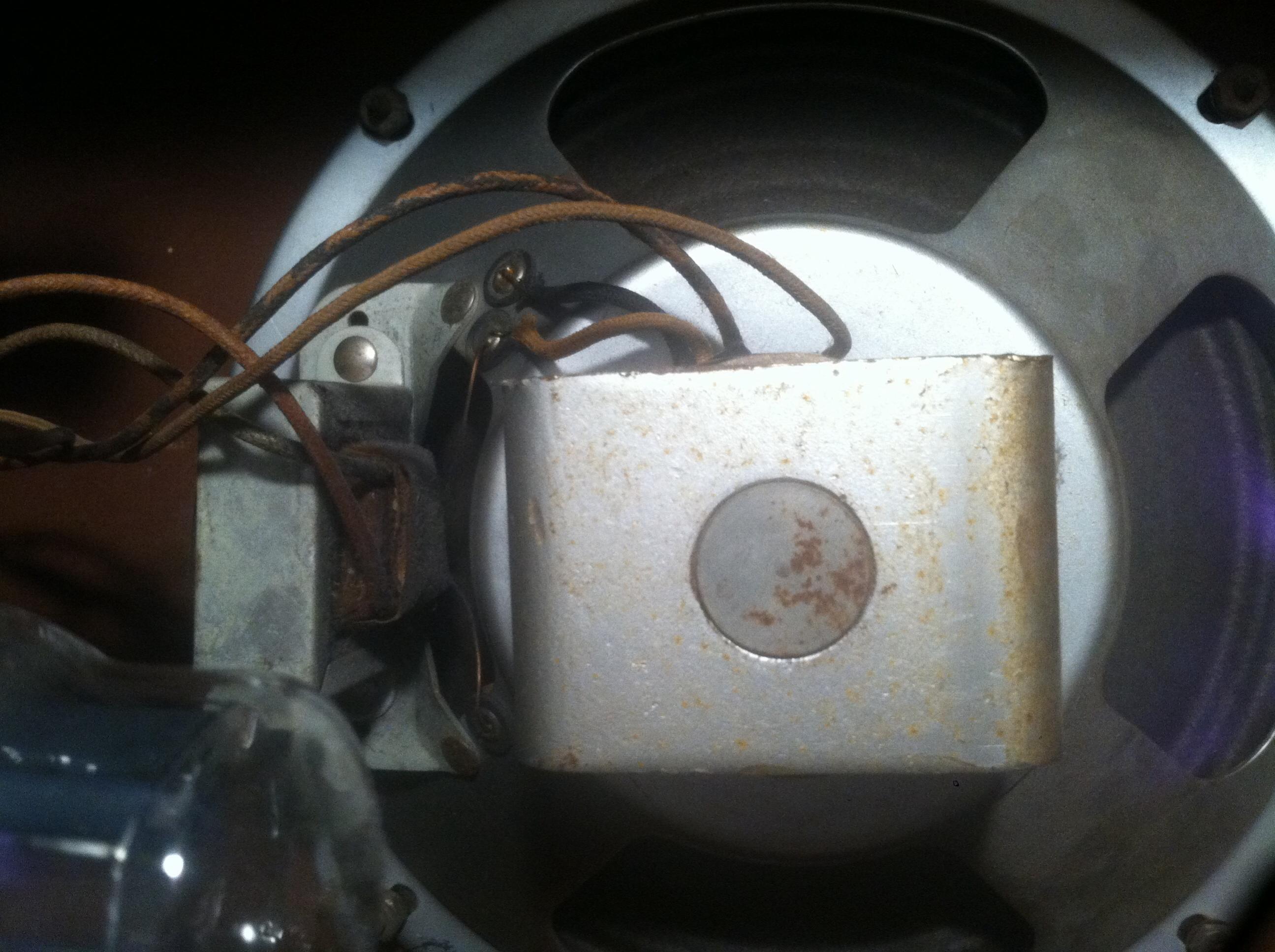

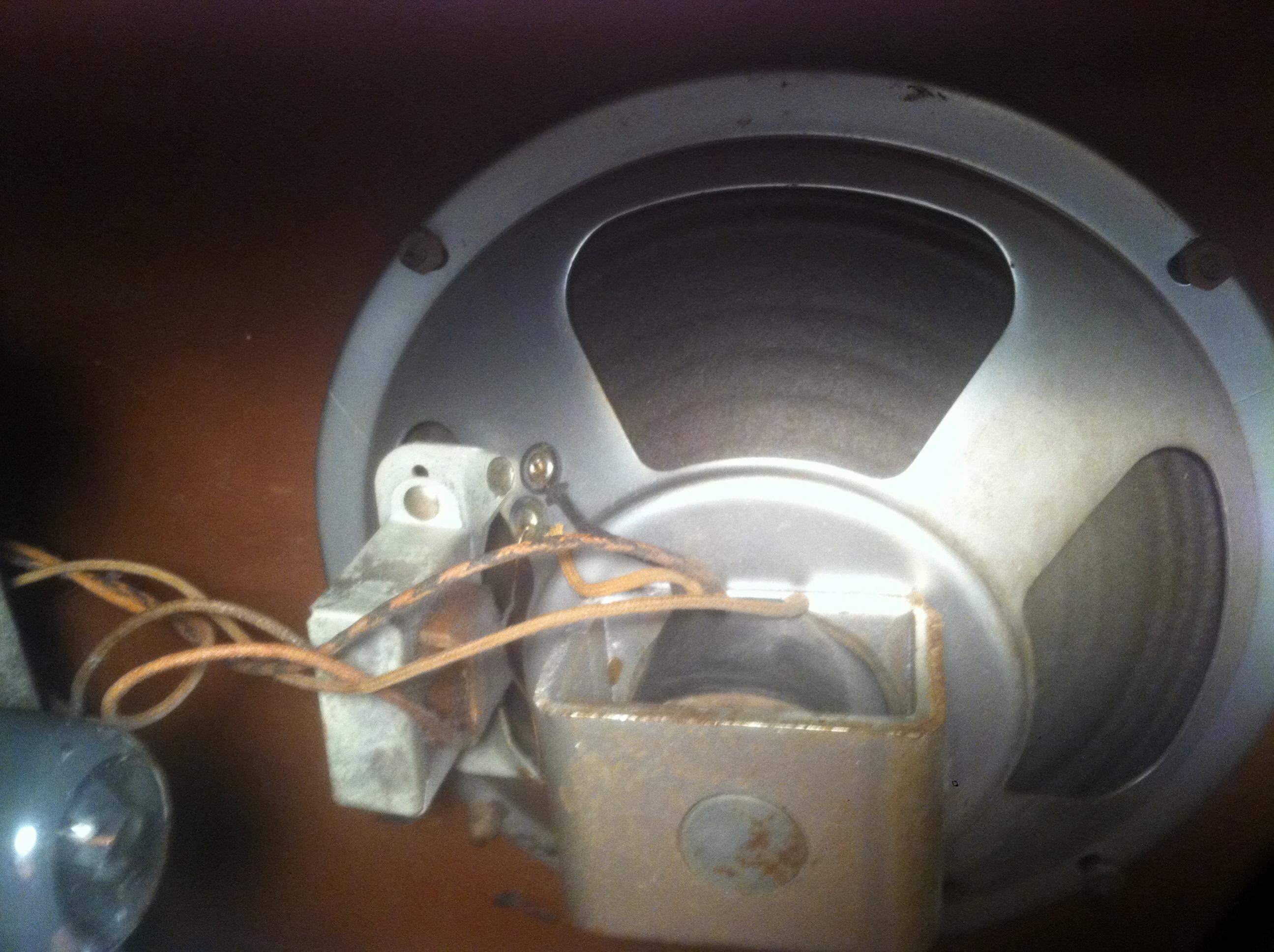

2 sets of wires going into speaker
This is an old tube amp from the 40's. It's got the OT mounted on the speaker, with 2 wires going into the speaker. Also, it has a set of wires going into the speaker magnet, then into the driver, as well as a ground wire attached to the frame. Does anyone know anything about this? As far as I know it's not a field coil speaker, just a regular alnico but I could be wrong. Thanks!

Note, there are all sorts of ways to turn down a loud amp, yet preserve most of its tone. The attenuator (power brake, power soak....) and VVR are the most common. Despite the concept, there will always be some effect on tone.
There is a third way that has not been successfully commercially explored yet (yes, I know that there have been a few attempts). Put a variable power supply on the field coil and adjust the magnet strength. The tone remains fairly constant over a fairly broad range of loudness. I did this maybe 35 years ago with a variac feeding an isolation transformer feeding a solid state bridge and a filter cap wired directly to the field coil. Also note most of the field coil speakers I found do not live long behind one of my amps! Field coil OK, voice coil, not happy! The spiders on these old speakers were quite loose, smacking the strings will bottom out the coil, resulting in a loud pop.....for a few times.
For some really unusual effects build a second small SE guitar amp, and wire the field coil in place of the OPT. Yes, two amps feeding the same speaker. Try both polarities of the field coil and be prepared for weird sounds.....especially with effects on the amp feeding the field coil.
