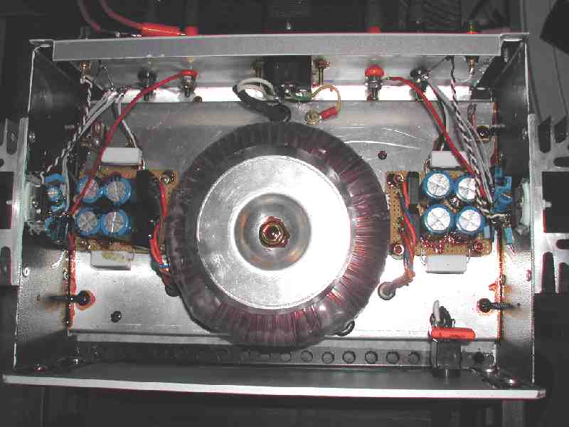

Joined 2002
Here is the 1 x-former, 4 bridge GC
Regards
George

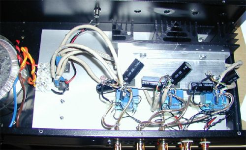

As mentioned before, I blew my fuses when I used one toriod and six bridges for three channels. Now I use two bridges for three channels, and it works. Have no idea why....
But maybe I wired incorrectly. I wired the three pairs of bridges in parallel to the secondaries. Same wiring as now with only one pair of bridges.

This makes sense to me. My fuses were 5 A, but I'm not quite sure now, cause I threw them out. Should I go back to six 6A bridges with a bigger fuse? How big a fuse? 300VA toroid, 25+25v. Would six compared to two bridges give some advantages anyway?
Do you use the fuses on the primary or secondary side of the transformer ? Do you use the slow type (T) ? 5A on the primary side should be more than enough, maybe even too much.
I think so. Diodes are non linear devices, so interference between channels is reduced by using separate bridges. And the max. current capability is increased. How big the difference is ? I can't tell...

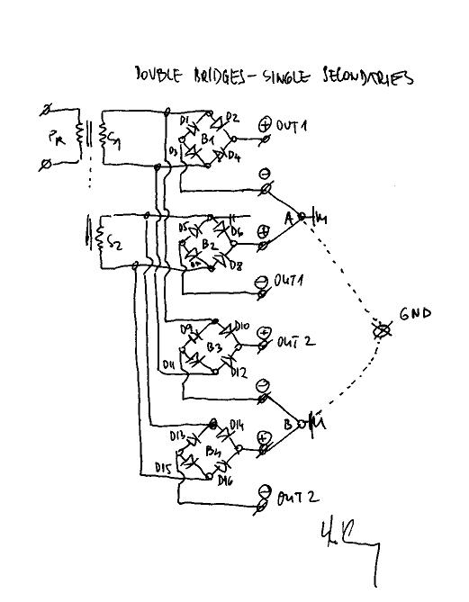

Some idea when are one pair secondaries connected to two (and more) pairs bridges.
If ground point of upper pair (point A) is connected thru star ground point together with ground point of lower pair (point B), I see some problems (maybe):
1. Some diodes are connected parallel (D1 with D9, D3 with D11, D5 with D13, D7 with D15), and if these diode pair are not matched, exist possibility (exist anyway) that current for upper amp flow thru star ground and diodes dedicated to lower amp (and vice versa). This current thru grounding wires can produce hum (IMO); isolation between amps is smaller.
2. If bridges have some diode double and some single, is not this nonlinearity-nonsimetry in rectification?
3. If we make mistake and tray to use sec1 for + rail of upper amp and for - rail of lower amp, thru ground we make short connection (antiparallel two diode). Maybe is this reason for some fuse blows.
At end, I can speculate that grounds of amps are not connected together (then this problems are away), but this is true (IMO) only when input signal is connected thru line transformer.
Regards

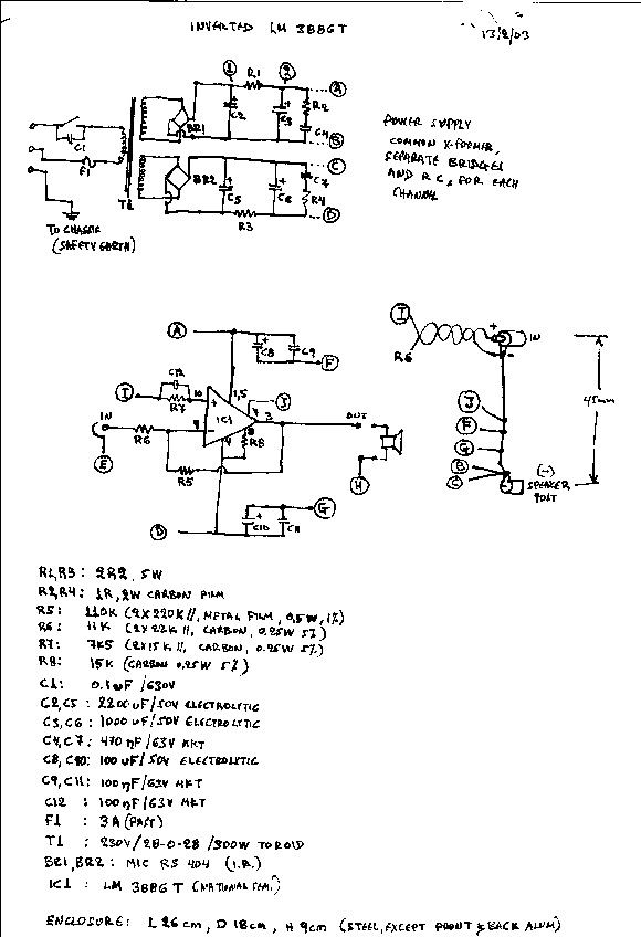

Joined 2002
George, you did wire the two pair of bridges like this, in parallel to the secondaries, right...?
Jan
Yes . I attach the schematic, which is for one channel only. The bridges for the second channel are wired in parallel. The "grounding" is also shown on the right. The fuse on the primary is 3A fast. The 2A fast was marginal. The 1.5A fast didn't make it. Chassis is grounded. Signal ground is floating.
Regards
George
Regards
moamps, I wired exactly like on your schematics, except three channels in parallel.
Each star ground for each channel are in fact not connected ! I have two star grounds per channel. First starground for psu and speakers, and second starground for inputs. Those two star ground are then connected. But for each channel only.
I will have to investigate futher why I cannot get it to work with six bridges, cause it works fine with two bridges. :h_ache:
