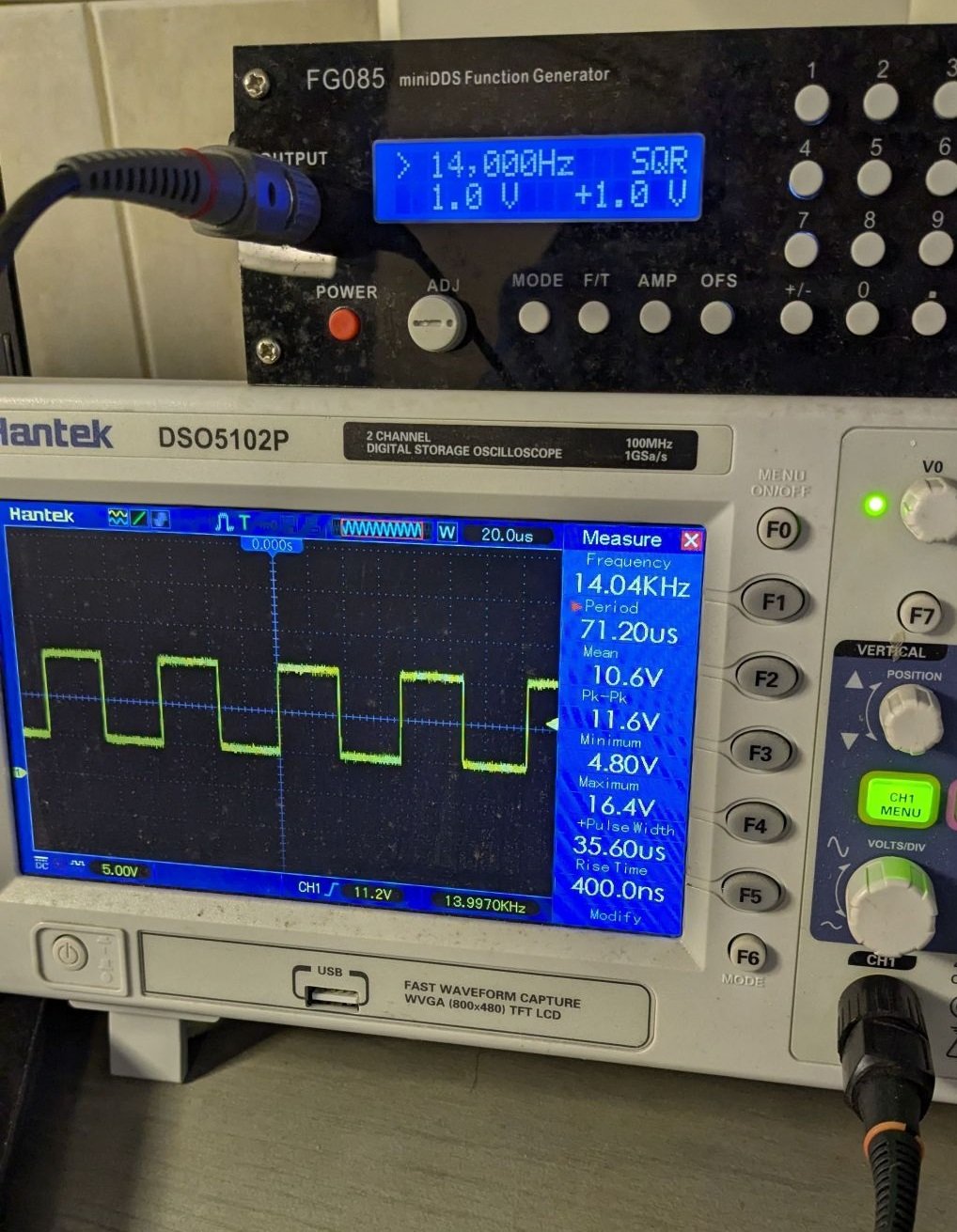

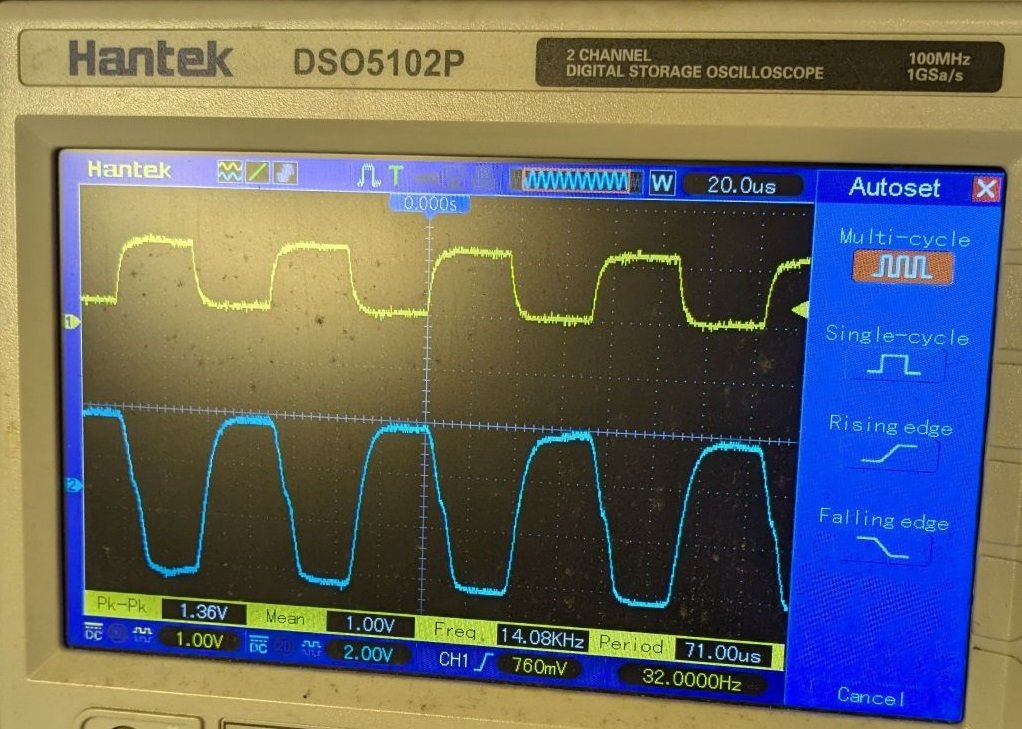

Q1.) Why isn't the squareWave the same on pic #2 as on pic #1 ?
Pic #1 is the signalgenerator -> Oscilloscope, no amp involved at all
Pic #2 : I have a 100k pot as volumeControl , Signalgenerator -> volumeControl -> lineIn on the Amp.
The probe connected after VolumeControl.
Because the 405 was never designed to behave like a medium wave transmitter, as the designers emphasised repeatedly. The bandwidth is 55kHz or less, and this is never going to reproduce square waves accurately.
Q2.) Is there anything i can change/replace on the amp to make it better ?
Given the above, define ‘better’ in such a way as to conform to the original design intent.
