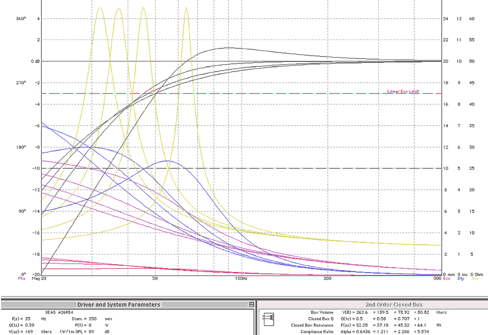

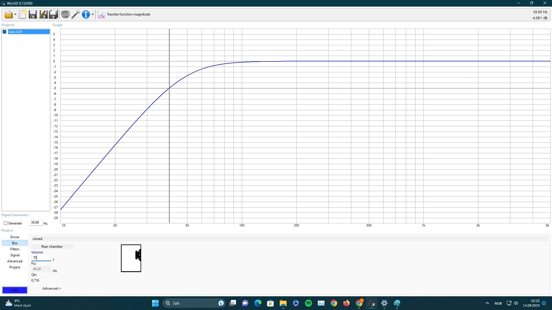

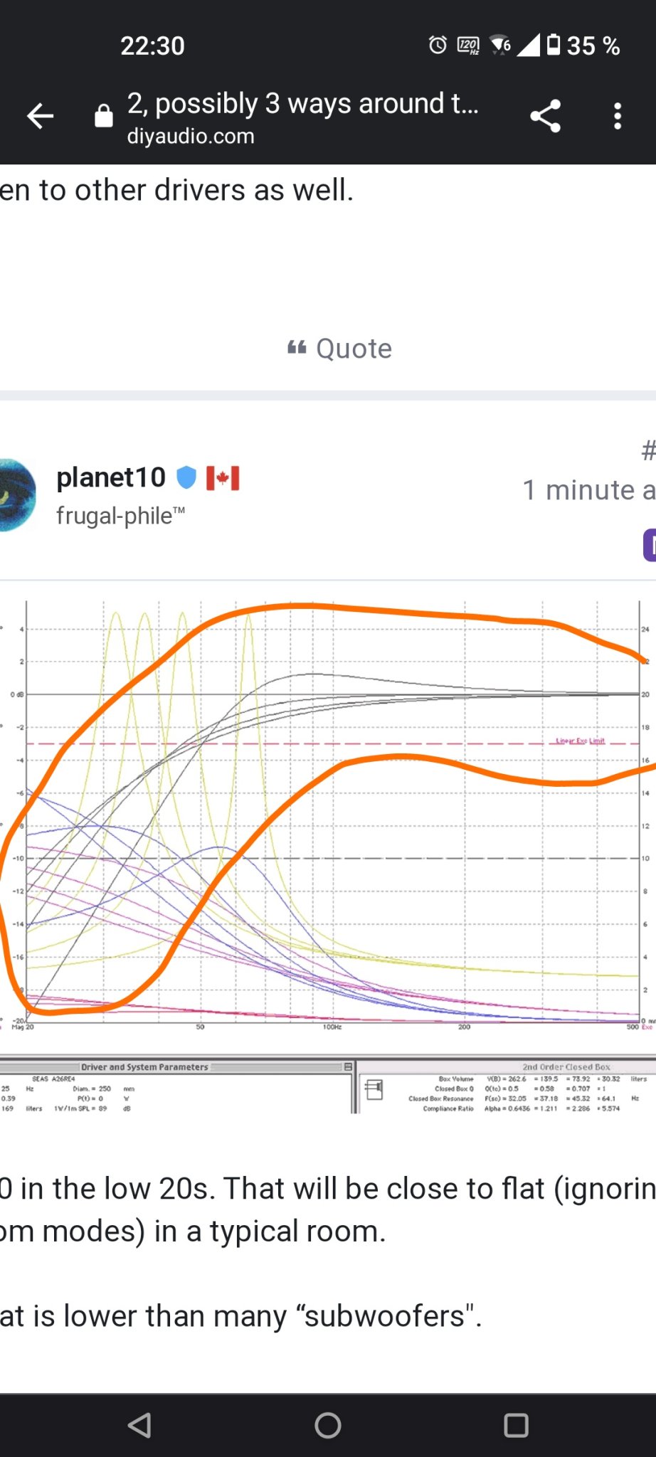

I see you don’t understand sealed. As the box gets smaller the Q goes up. So the smallest box has the biggest bump and won’t reach as low.
Typically one aims at max-flat (Q=0.707) but in a room with lots of gain a lower Q can play well.
Have a good look at the entire A26 ReViz to get a good idea of loading the A26.
https://frugal-phile.com/boxlib/A26-ReViz-0v90-080323.pdf
