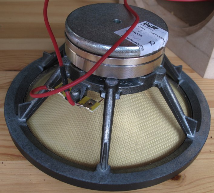

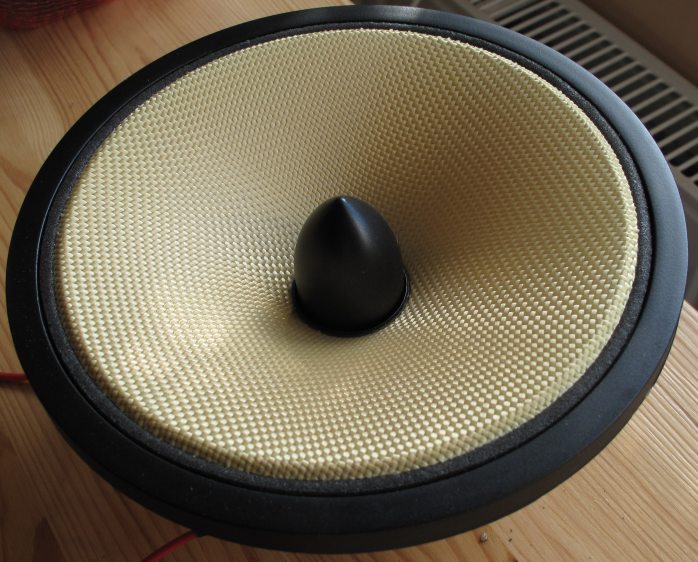

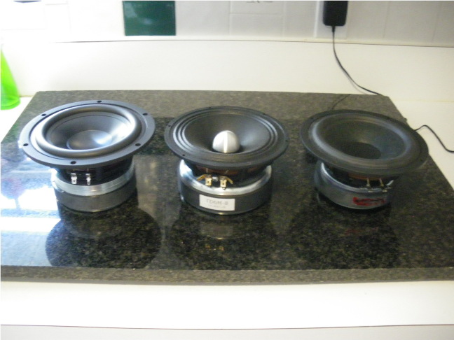

TD6M-8 T/S Parameters overhung motor 2.83V: 94.5dB
Fs: 83hz
Qms: 3.1
Vas: 10.3L
Cms: .45mm/N
Mms: 8.2 g
Rms: 1.38kg/s
Xmax: 3.3mm
xmech: 7mm
Sd: 127 sqcm
Qes: .46
Re: 6.1ohm
Le: .044mH
Z: 8ohm
Bl: 7.5 Tm
Pe: 100W
Qts: .4
qW SPL: 93.5dB
2.83V: 94.5dB

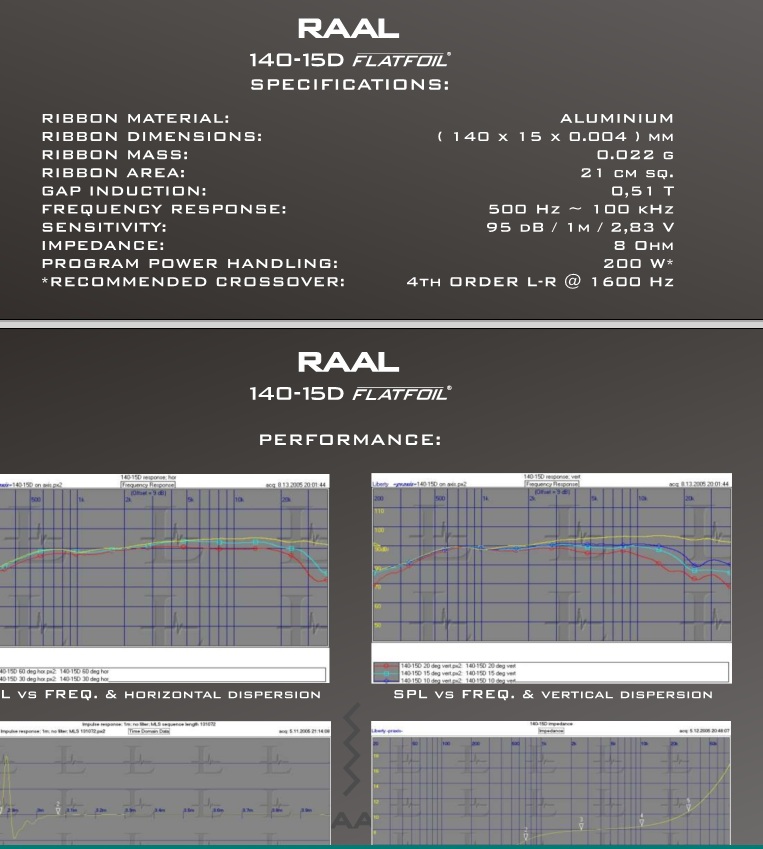

I was thinking along the lines of the 140-15D Raal tweeter a 6" a 10" and what ever I need to achieve house shaking base for the sub cabinets, which of course will rarely be used for music, so I need full frequency from the first three drivers.

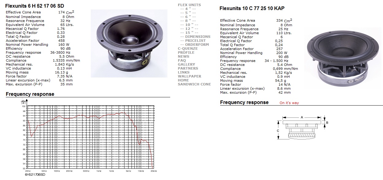

The drivers in the pics are the ones I want to use, I guess I should ask is this a bad match?
Ok if I understand you correctly LineSource what your saying that the Raal tweeter is so flexable / efficient that I should be jumping straight to an 8" instead of mucking around with MTM 6".

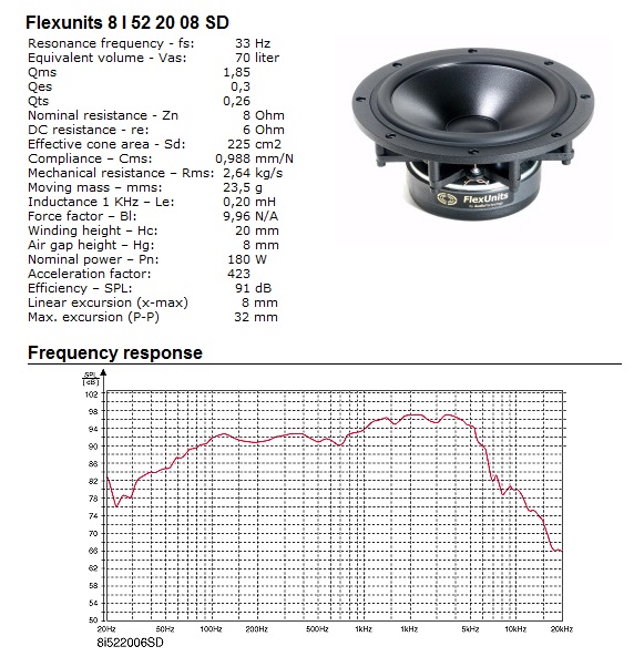

Putting the tweeter and the 8" in the same cabinet close together won't be an issue as that was kind of what I originally had in mind early on.
Would I need one or two 8"? and then maybe the 12" KAP?

Going from an MTM with 6"s to a single 8" REDUCES over all driver spacing issues, which allows you to use a more sensible x-over point on the RAAL without as much or theoretically no detectable lobing. I'm not sure where you're getting this "my tweeter selection is so elite I didn't even realize how amazing it was I guess I can use an 8" wow it's dawning on me" revelation. You're interpreting what LineSource was trying to tell you in complete reverse of the intended point. I assume that you didn't understand part of what was being said so you simply ignored the part that didn't make sense, hoping that the issue would solve itself. LOOK UP LOBING.
The RAAL looks like a good candidate for the top end of a wide bandwidth 3-way system, yes.

Raal suggests a low pass crossover at 1600Hz with a 4th order Linkwtiz-Reily configuration and this would seem like a very sensible place to start since the person who made it recommended it. As I say there is a strong temptation is to cross the 8" (or whatever combo) higher to try help out the tweeter, is this being counter productive?
Or alternately crossover with a 1st order configuration to let it taper off more gently to go higher up the range. My gut says I should crossover with a fairly high order to stop the bass wandering out of its comfort zone.

Out of the AT units you have selected above it would be best to go a C-Squenze than a flexunits for the midrange maybe like 15H 521206SDKM or if you want a lager midrange 18I 520613SD
For woofers what enclosure are you going with sealed or ported?
For 10" woofers.
Sealed l would go Qty 2 x 10A 772510 KAP
Ported Qty 1 x 10C 772510 KAP
