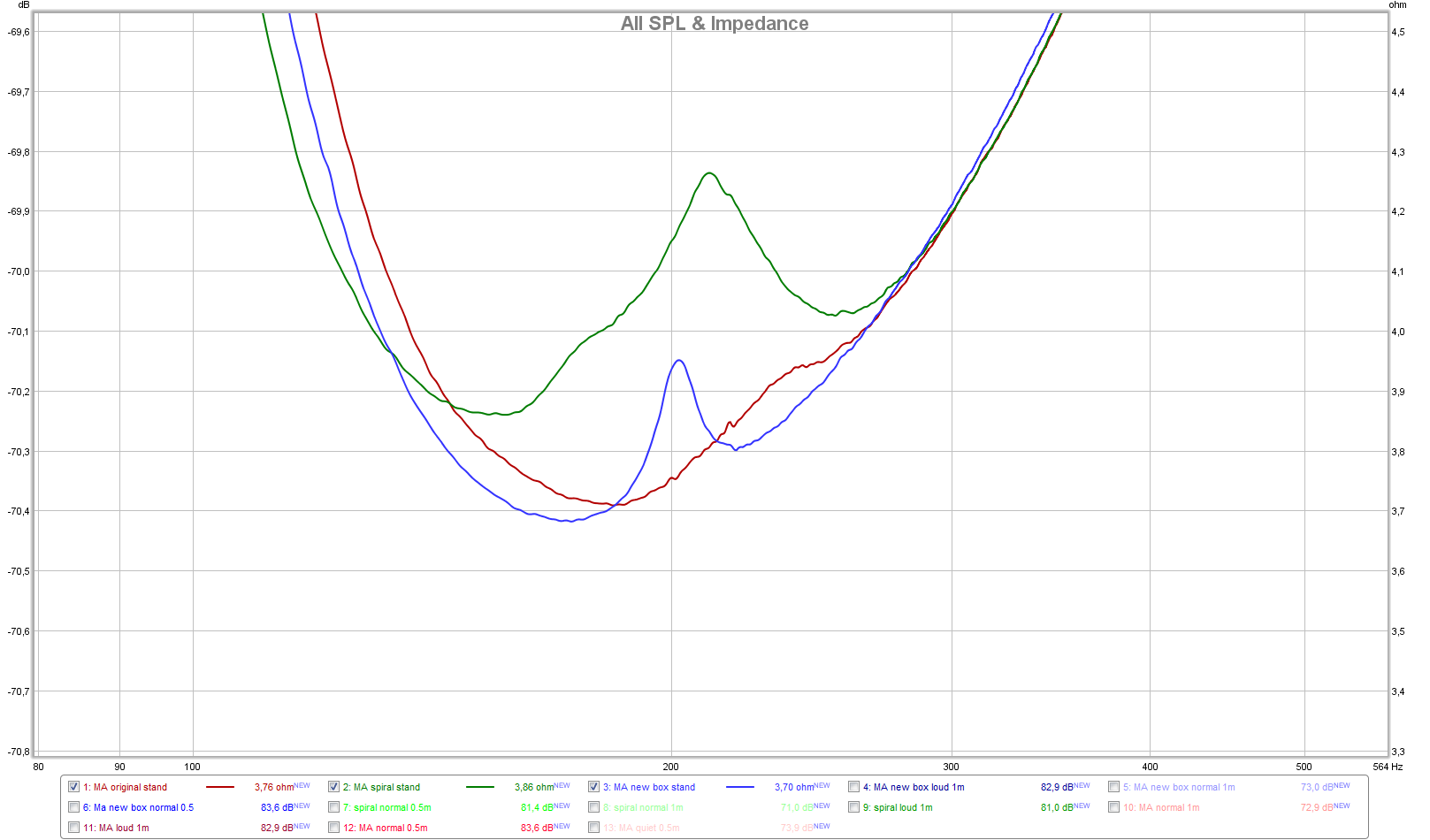

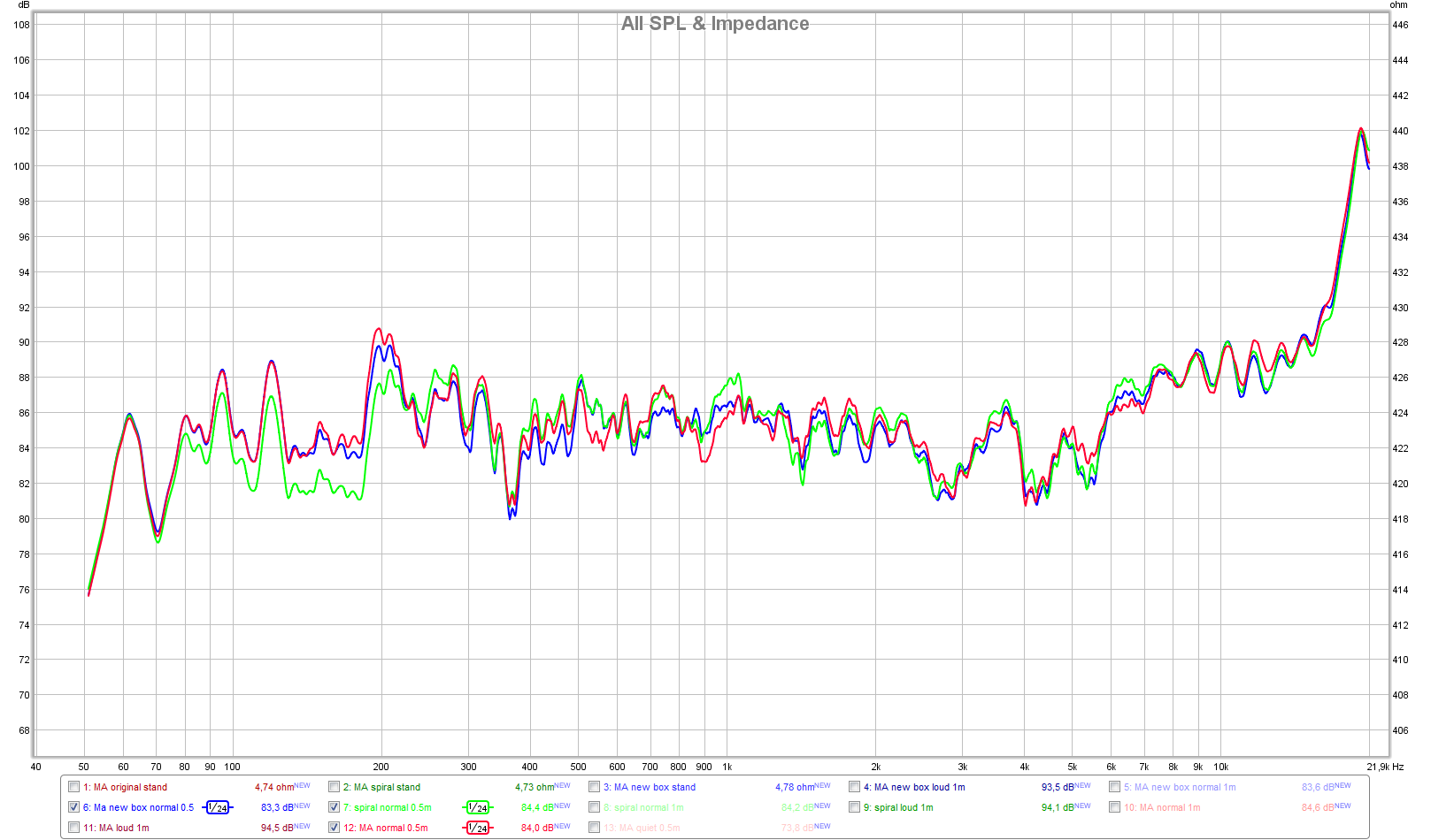

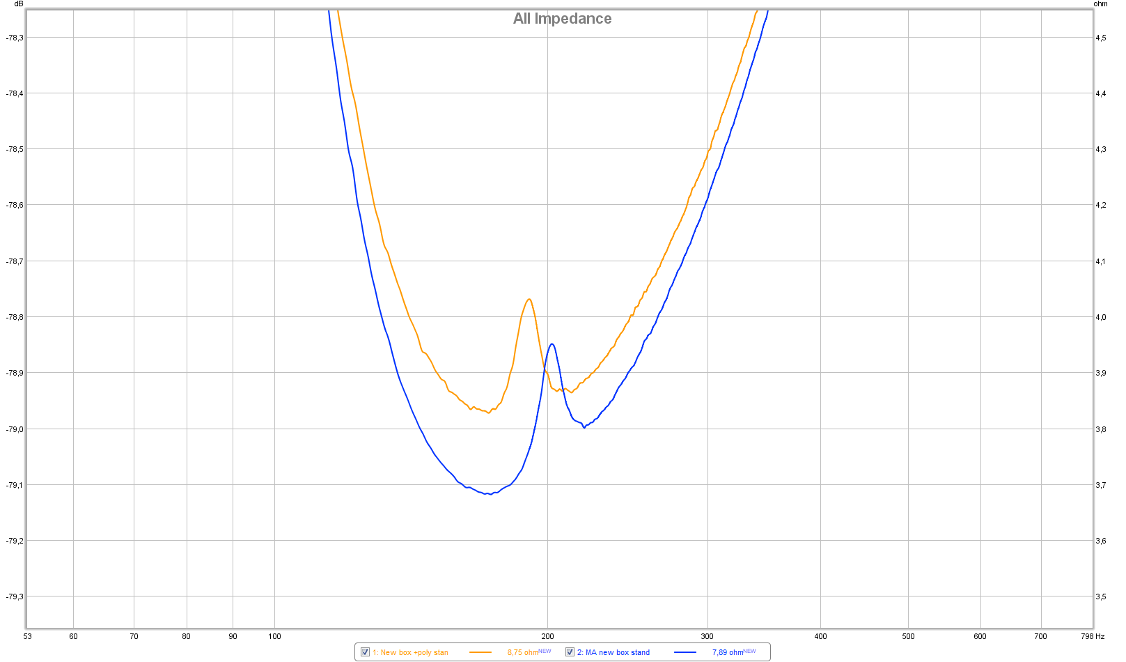

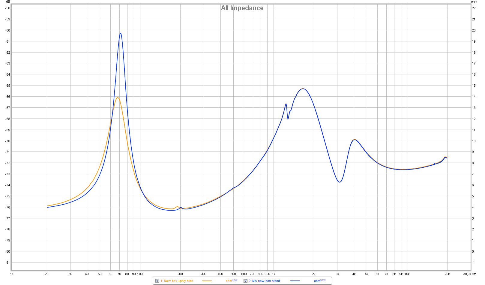

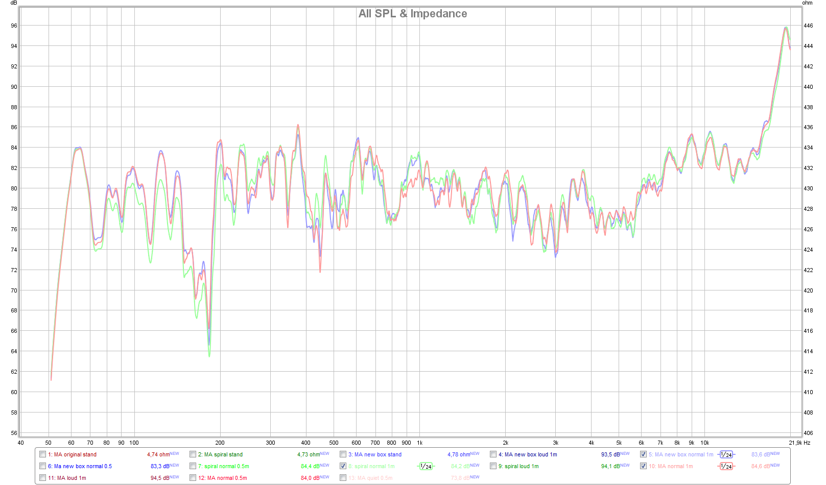

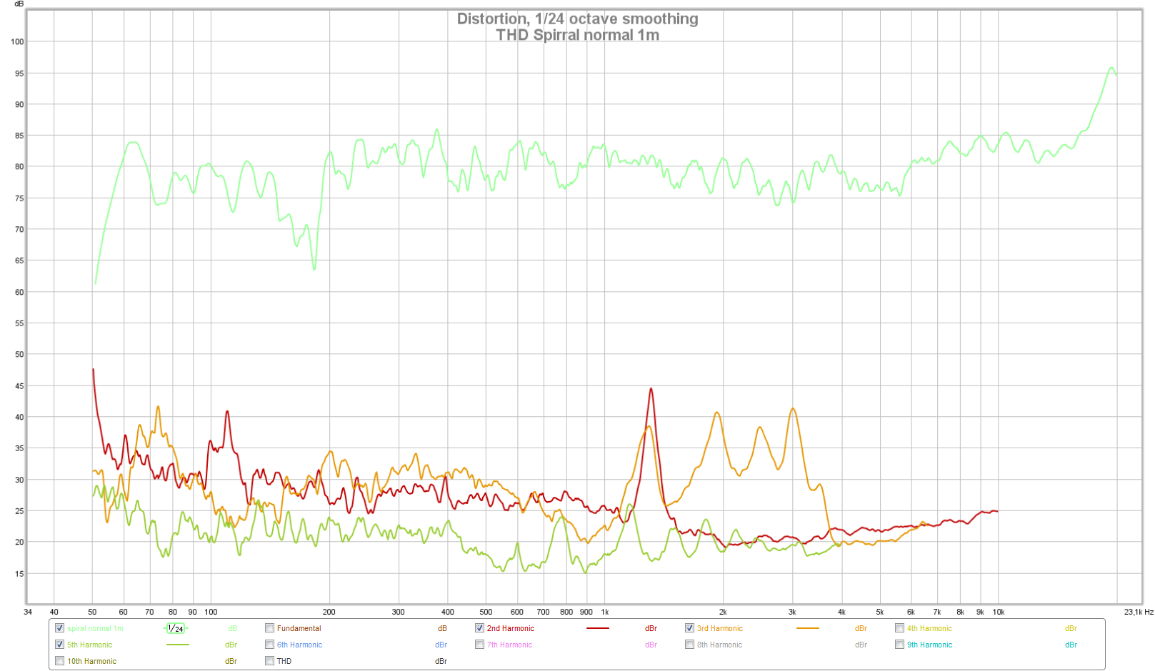

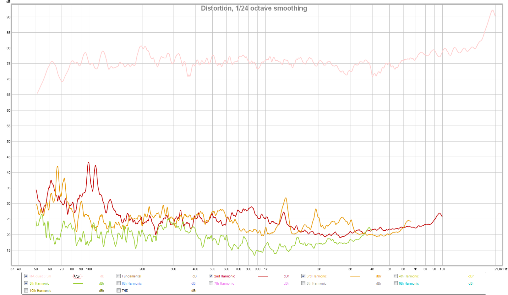

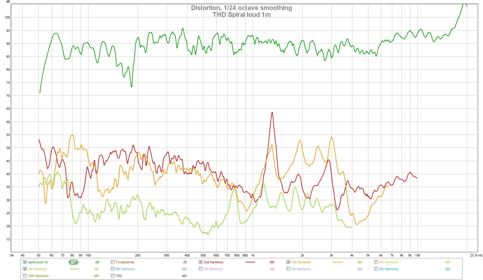

Almost finished building the second spiral. Even though the audible differences are small in comparison to the braced cabinet, the spiral does measure a bit better. I think the hump at 1.3K disappearing is due to the separation of the woofer chamber with the tweeter and crossover. Secondly i can pull the tweeter, turn it upside down and add a mid + tweeter on top while still having the woofer close to the mid for the 3-way experiment.
I finished the 2nd spiral and got me some fiberglass/glass wool 8cm thick on paper/aluminum backing which I removed prior to using it.

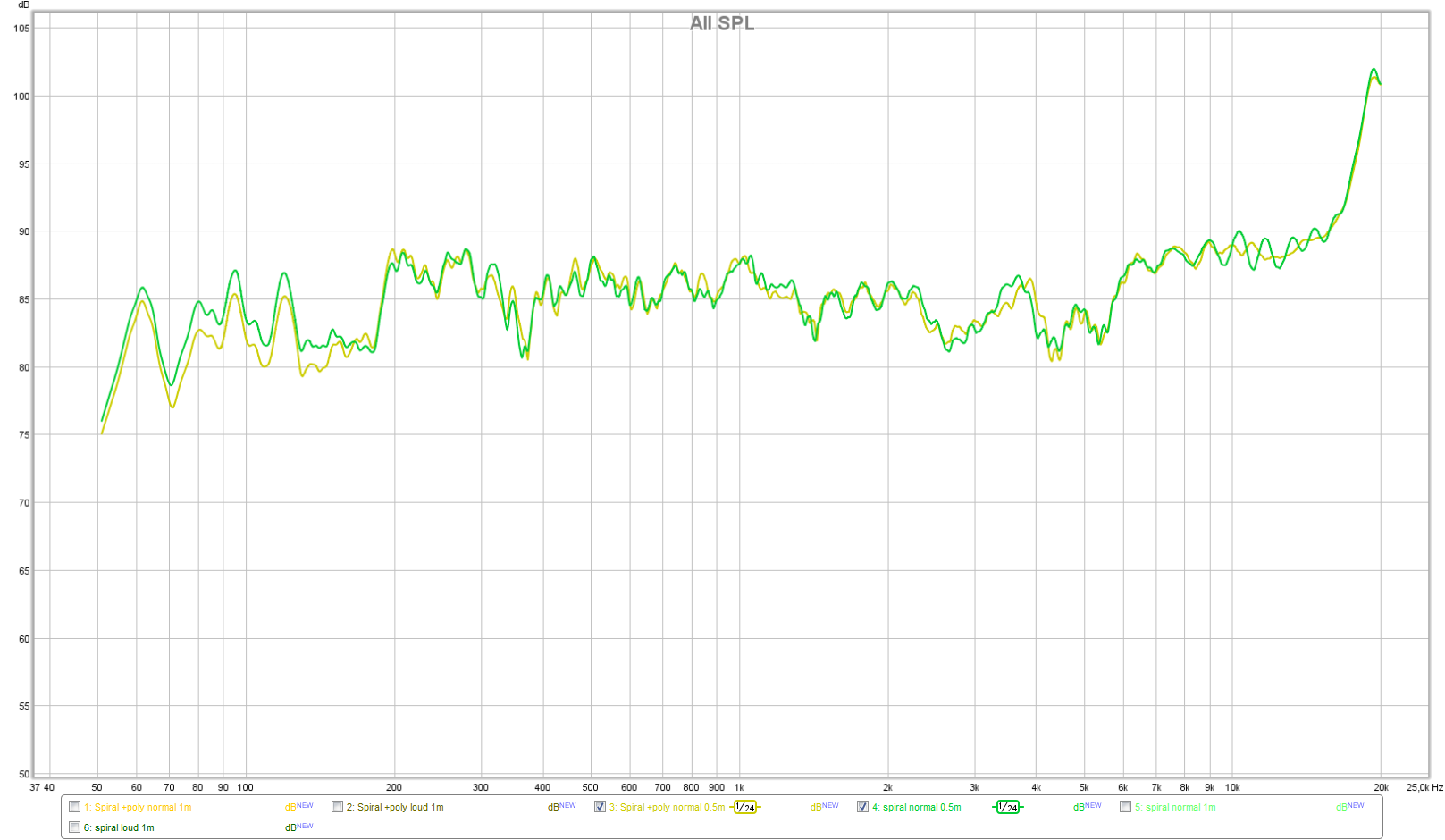

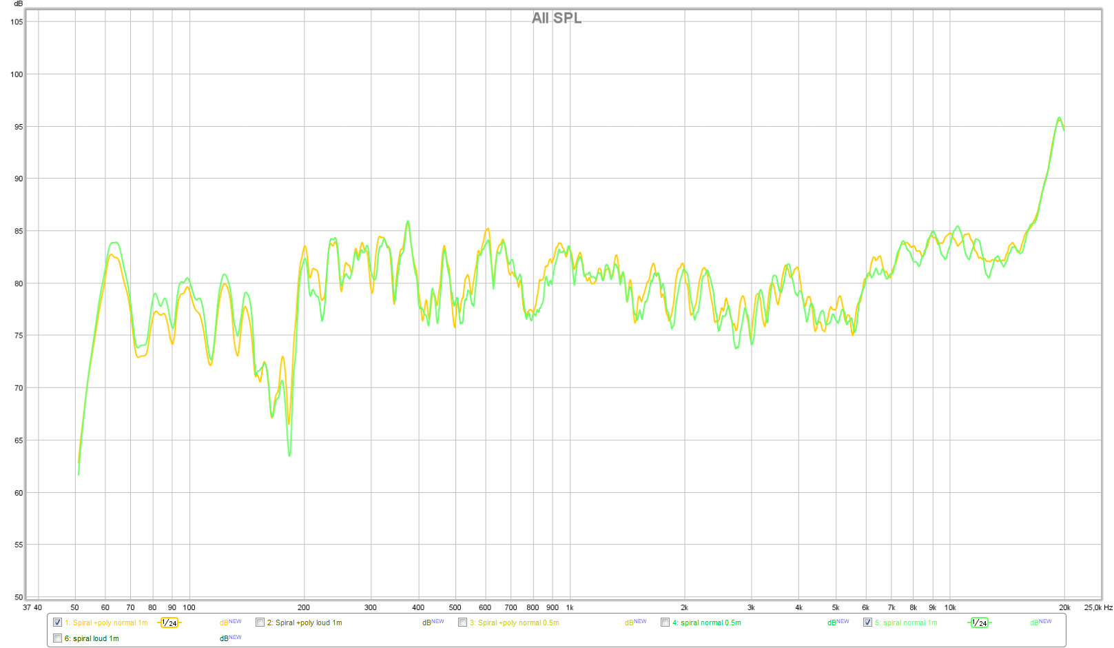

No fill comparison to no fill first spiral:
Looks close enough considering the difficulty of making these cabs identical.

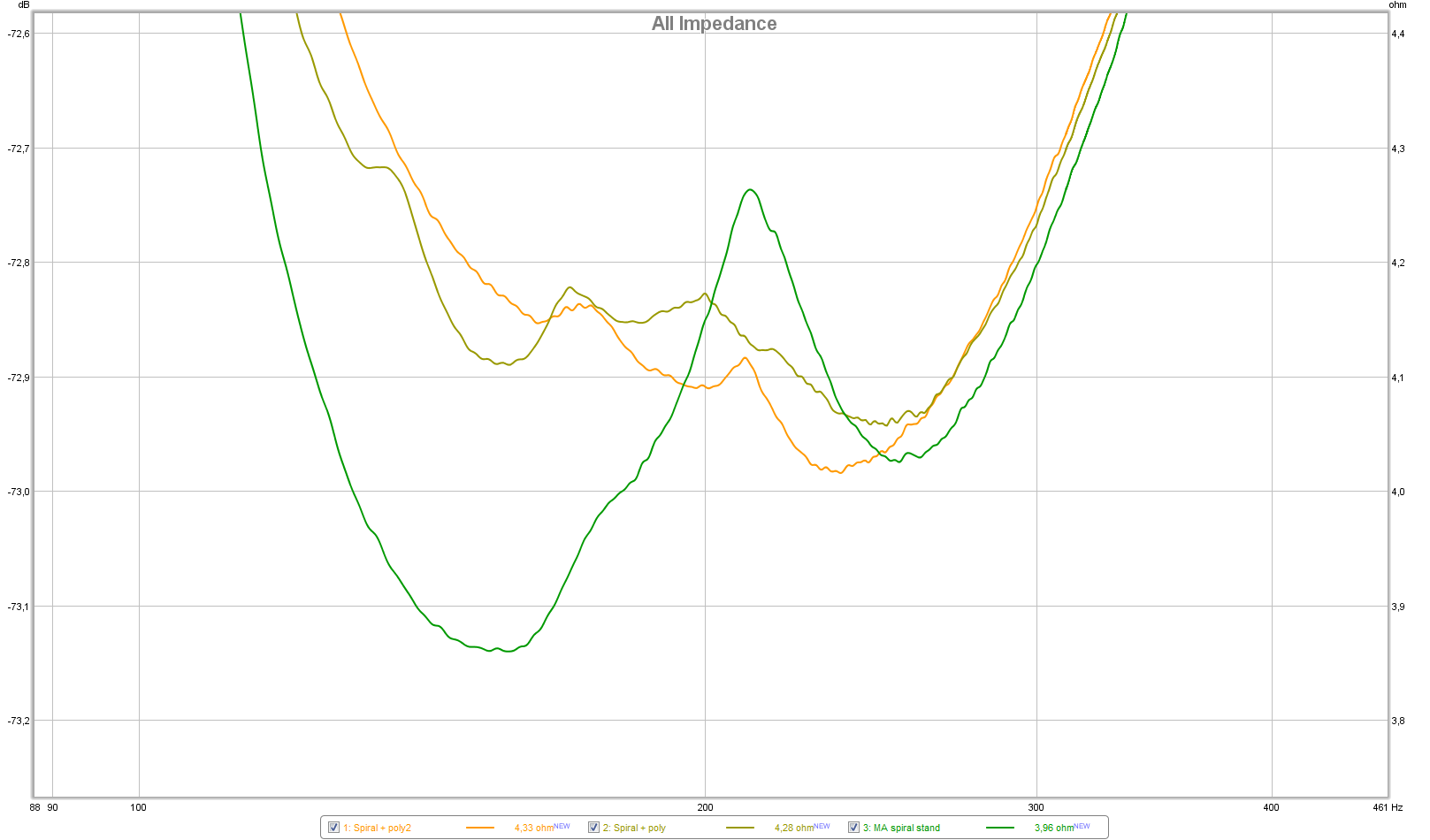

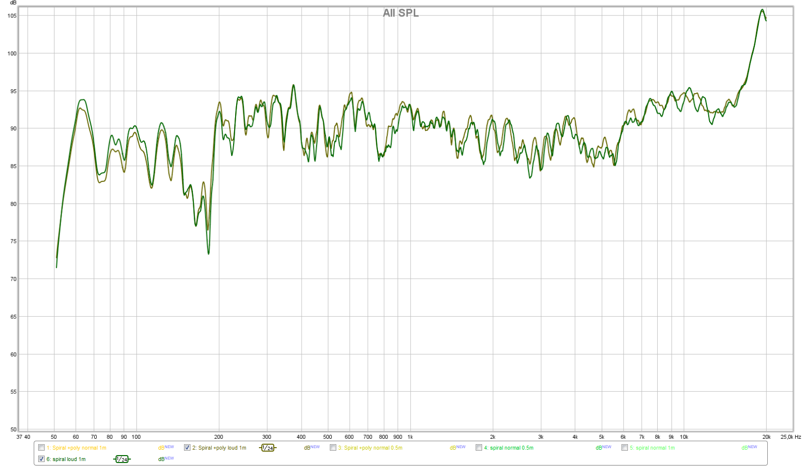

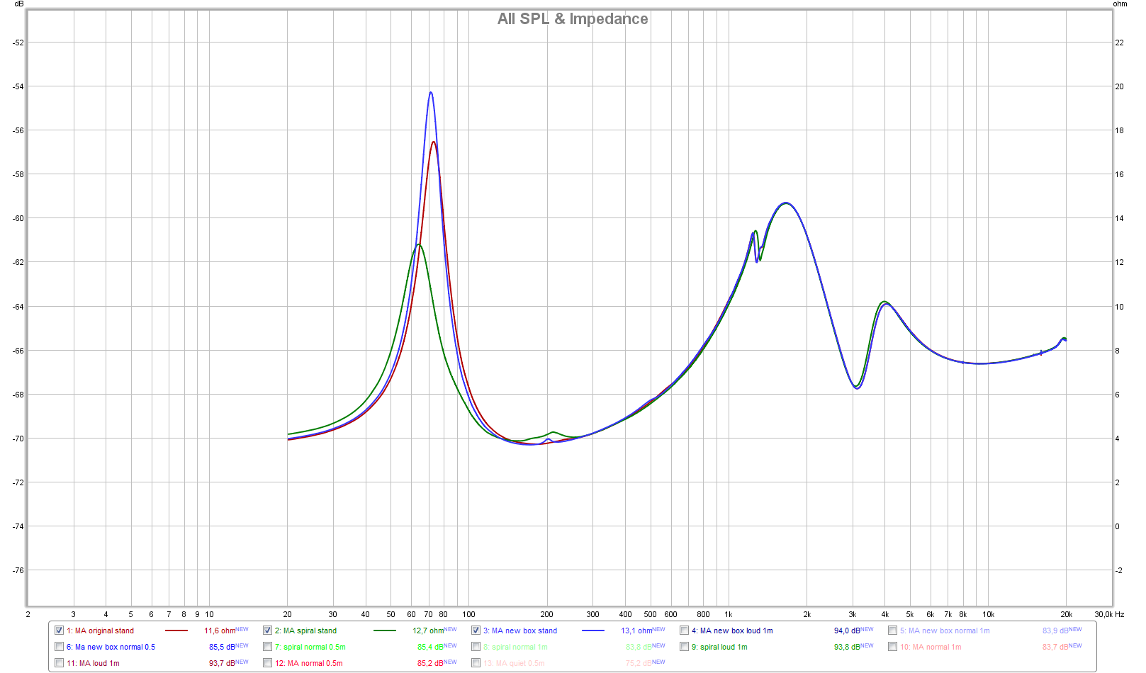

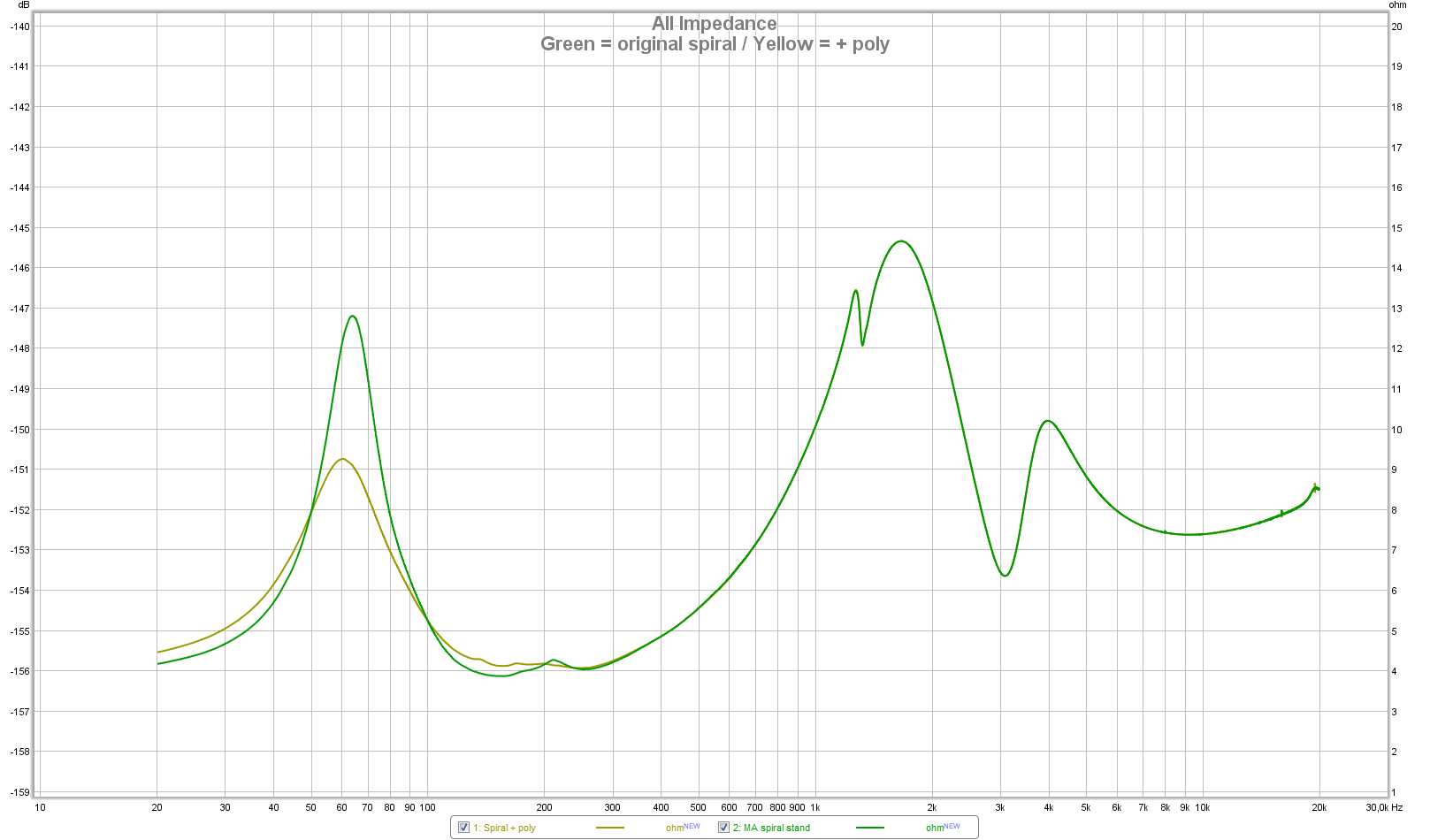

Different amounts of stuffing:

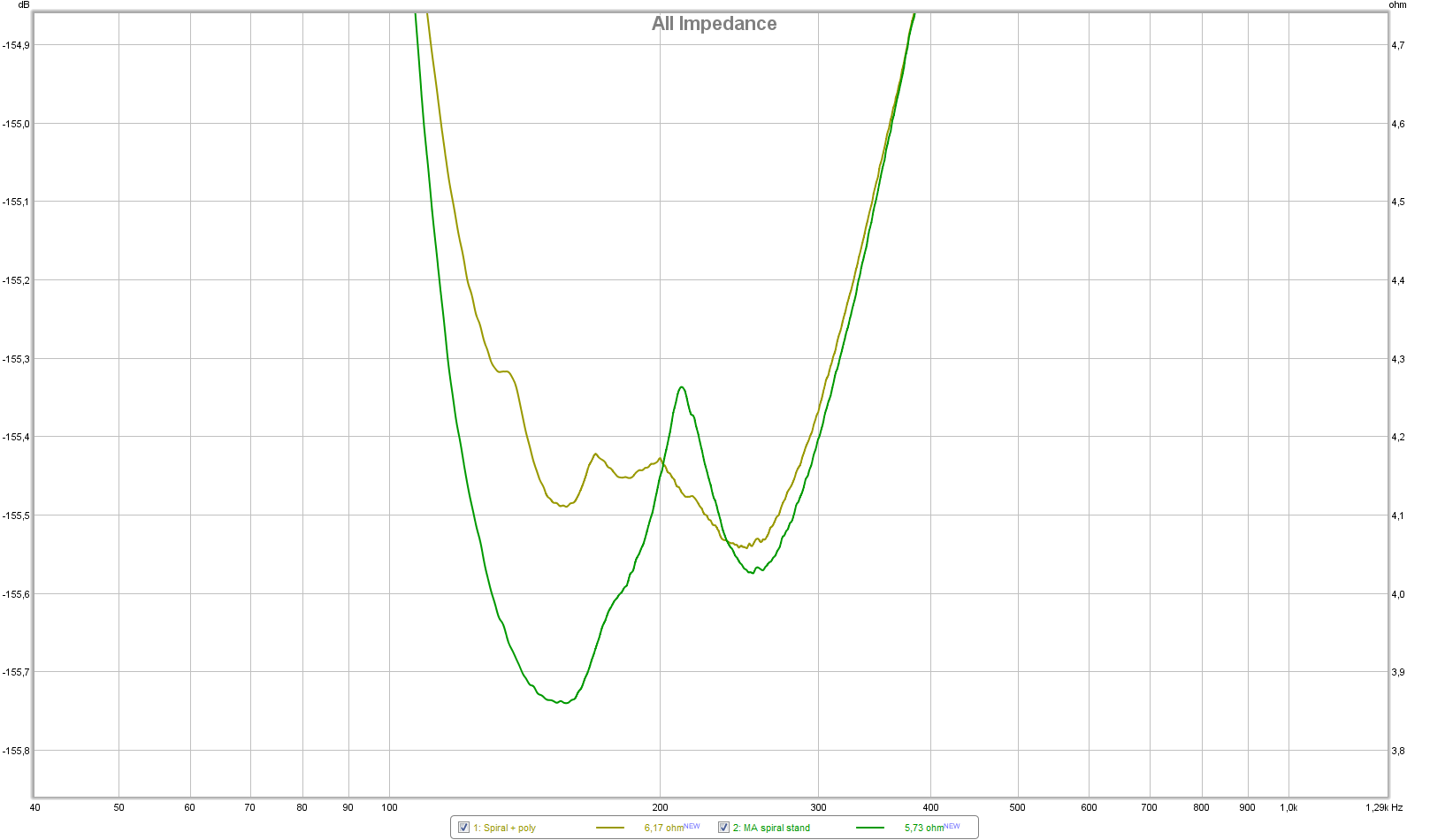

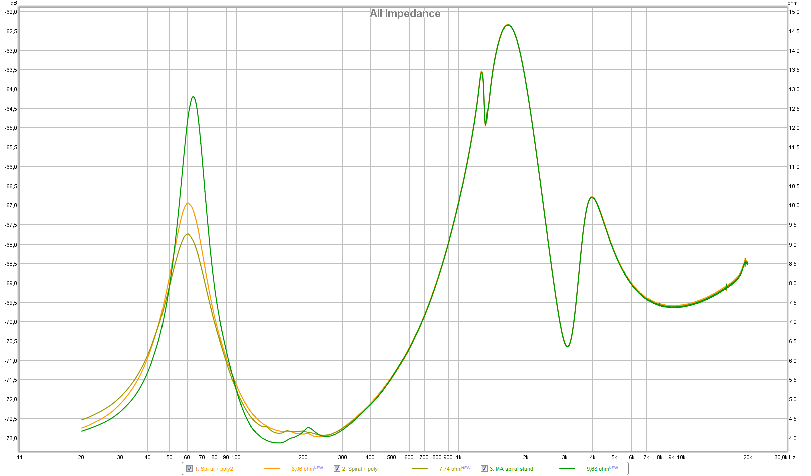

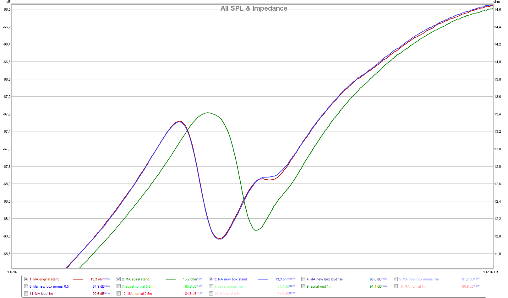

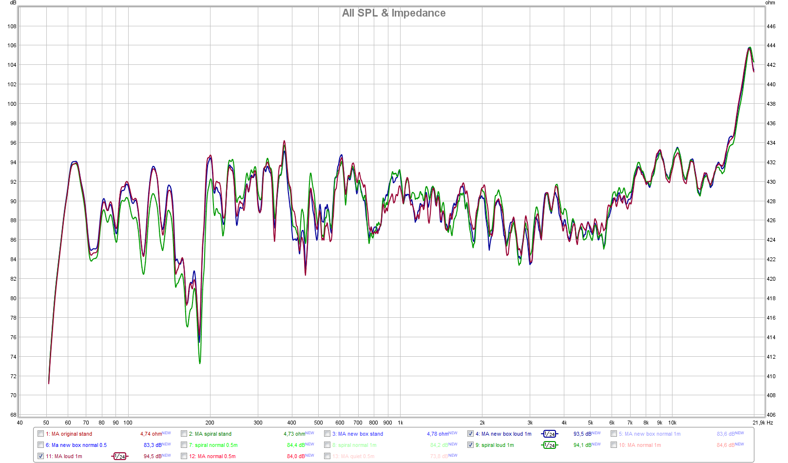

The first time I filled the second spiral with fiber glass I packed it a bit resulting in the huge shoulder at 100Hz. I remeasured the impedance with the enclosure upside down and at another location with the same results. Thinking I might have some weird resonance caused by not tightening the driver enough or something I removed and double checked everything and took out a bit of fiberglass resulting in the "less fill graph".
Comparison between first spiral with polyester mat filling and 2nd spiral with fiberglass filling:
I listened to these 2 extensively (mono signal and fast switching between the two spaced 20cm apart) and I have to say I can't really hear a difference.
I also noticed the little hump at 1.3K is still there, I'm still using the original wires so I haven't sealed the compartments with silicone, I'm hoping it goes away when I do. Otherwise I have no idea why it was gone with the first spiral.
@ wesayso: Did you find similar changes in impedance when stuffing with fiberglass or am i using too much (or too little)?

Interesting, ever finalize your conclusions? Really nice controlled testing [emoji1360]

I'm using them as a bedroom system now, still sounding good 🙂.

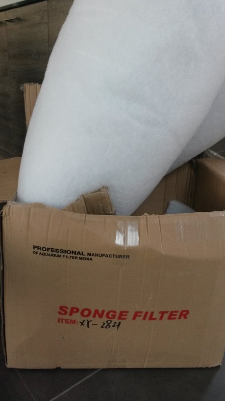

As far as the polyester vs fibreglass, I think you can get equal results with both in this type of enclosure. The pathlength is so long that it makes up for the lesser damping from the polyester. In more traditional boxes I only use fibreglass and felt for damping at the moment. Polyestermat (or sometimes felt) is only used as a barrier/filter to protect the drivers from the glass fibres and to have some better impedance matching.
Don't use fibreglass for vented enclosures if you like your lungs, I don't like vents but I would use very densely packed polyester. (IKEA pillows are a very cheap source of polyfill and it is better then the polyestermat filter stuff I used for the monitor audios) Real sheep wool is comparable to fibreglass in terms of damping but silly expensive if you want to use it for large (>30L) enclosures.
