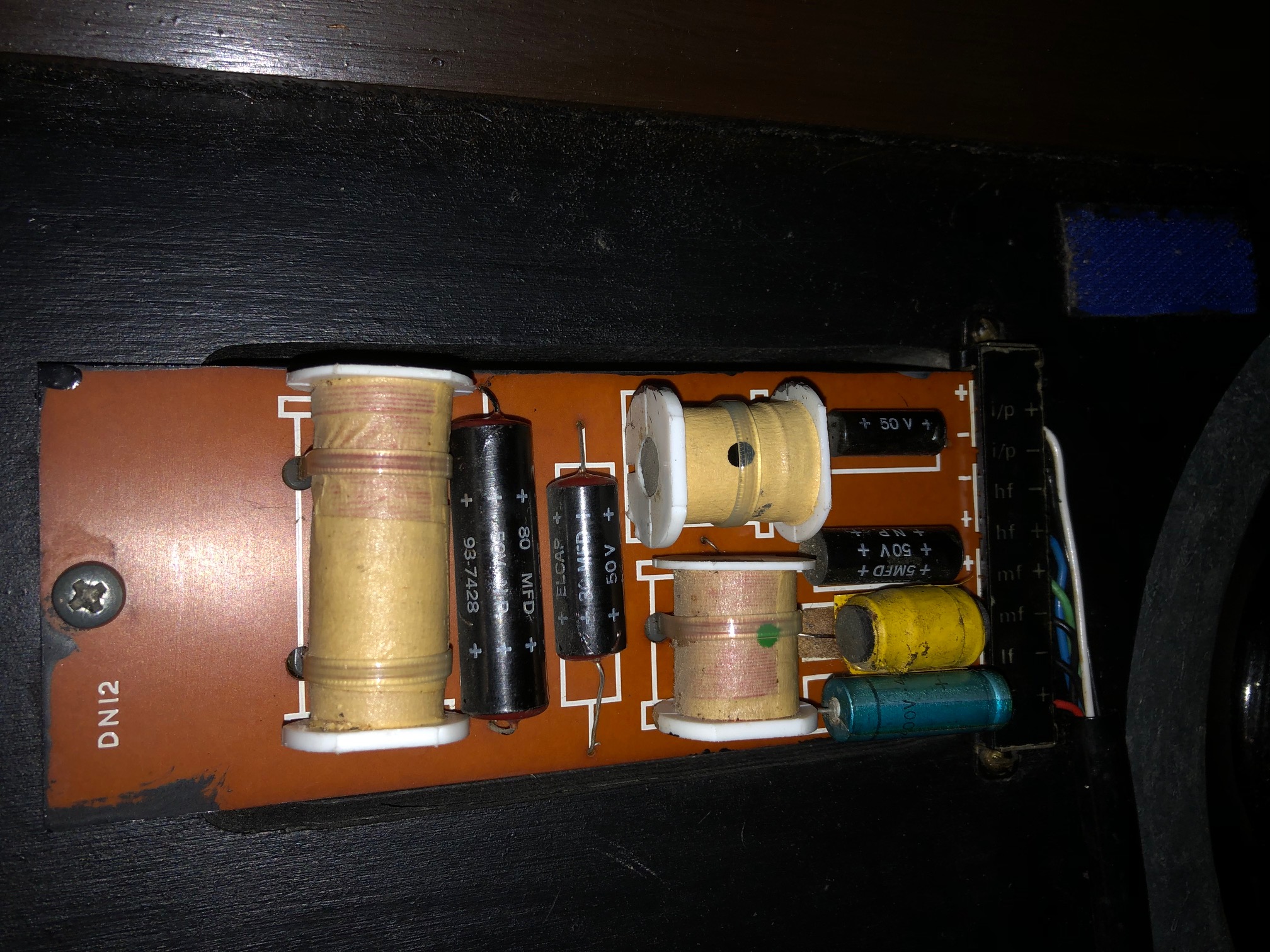

Eric, did you push in the Xovers in the right sense? Solder track side to the outside, component side of the crossovers towards the speakers? It happened to me…

I feel so ashamed that I have bothered you 😱😱😱... for nothing really .
On Jean-Paul's advice, I wanted to measure the continuity of the connector.
So I remove the frontpanel , and what do I see ???
Someone had put the CO's in reverse.. How stupid can one be...
Yes, it's stupid stupid stupid, hard and embarrassing to admit this, but I want to be honest about it.
I also have an explanation for this. We have a cat (Main Koon). But our cat is still playful and loves to use her nails...
So I put the front panels back on as soon as possible, to prevent the cat from damaging the speakers.
But I don't want to blame the cat now either. It's just my own fault. And I'm sorry for all the thinking I've put you through.

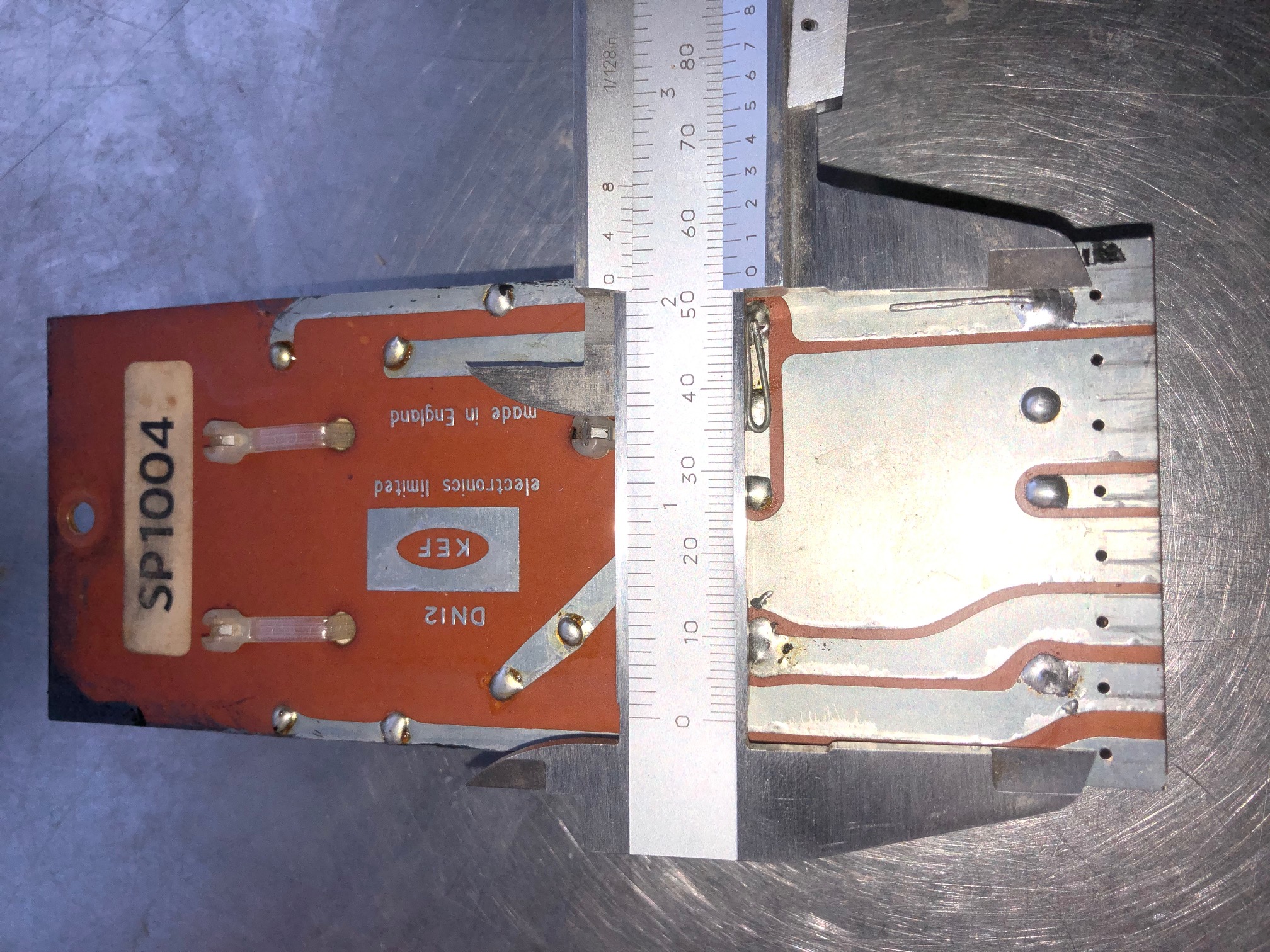

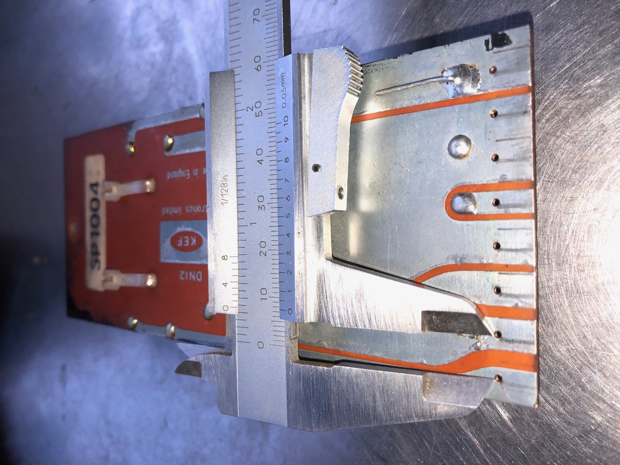

Questions for Eric who wants (t)his problems solved:

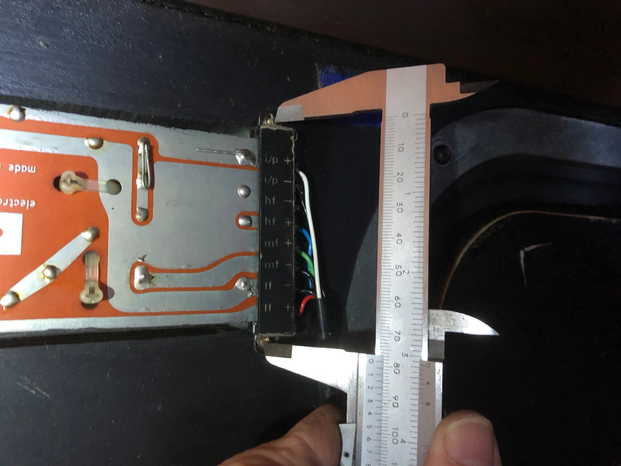

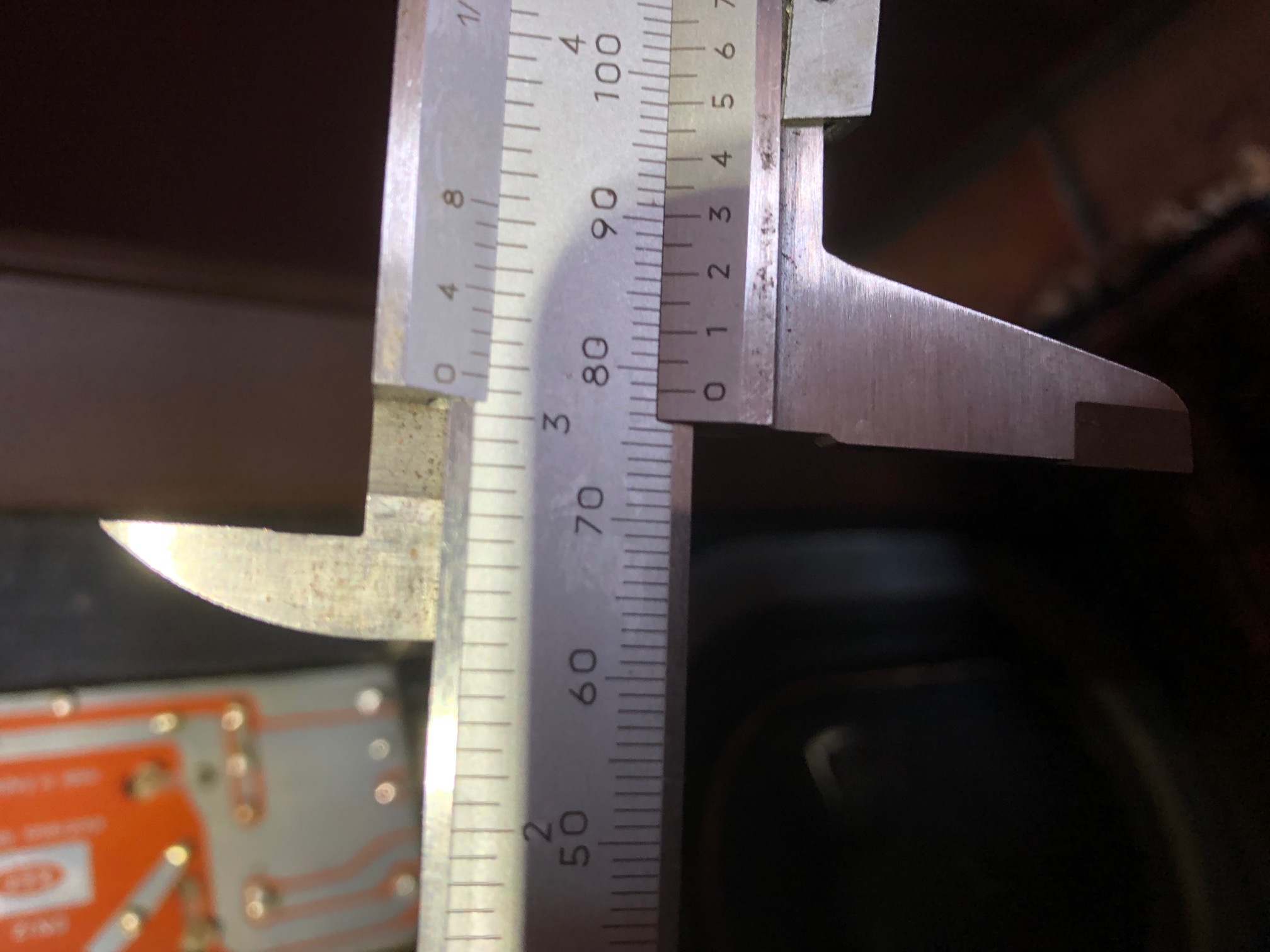

1. What is the distance between the holes of the filter outputs? If you are lucky an 8 pin screw connector block can be soldered.
2. Did you already use the DMM to measure the continuity of the connector? Imagine the contacts to have lost pressure and that they don't make contact to the PCB tracks. Your DMM will then tell ∞
* the capacitors should all be replaced for optimal performance. They're very old bipolar electrolytic caps except for the blue one which is a polar capacitor and that one is chosen wrongfully anyway. Normally I replace at least the caps for the tweeter for film caps and add a few to have the same value but preferably a bit higher rated for like 100V. A careful DIYer chooses types that have good properties and fit physically as well so if that is a MKP 250V type 27.5 mm pitch so be it. Like a 4.7 µF in parallel with a 330 nF to have 5 µF and a 6.8 µF with a 220 nF in parallel for 7 µF. It may be a small difference but it does not cost much effort/money to obtain the exact value. For the very large values new bipolar electrolytic caps have to be found that are good quality.
1. Is this the distance you were asking for ? (it's in mm...)
Nothing to be ashamed of really. We all make mistakes but admitting them is not for everyone so bravo!
What is learned?
1. a systematic approach works
2. keeping track of all steps and doing exactly the same but in reverse order is a preferred method to prevent errors (a few pictures made with a smart phone are excellent tools).
3. human errors are a large factor to take into account so every step should be checked/measured.
4. measuring works, if only to prevent assumptions as the latter create more errors/work
5. the connectors still are questionable so bridging the contacts is a must for optimal performance. Or a better solution must be found.
6. the caps must be replaced. Since they do have an influence care must be taken to make the right choices. Needs attention instead of trusting a company that sells parts.
So the follow up or the "to do" things are 5 and 6.
No, the distance between the holes of the PCB. If these are a standard distance you could solder a connector block to the PCB. Then the wires could be in the screw connectors. In your own pictures in post #23 you can see the holes with the text 'hf", "mf", "+/-" etc. Now, if you are the assumptions type of person the next thing that will go wrong is to assume polarities. If you look at the pictures you will see the pattern is irregular with +/- | -/+ | +/- | -/+. This is also written on the original connector and should be written down just like the colors of the wires going to that pins. When the connector would fit and would be soldered the text is then invisible and I hope you now see what then might go wrong.
I understand what you mean , Jean-Paul.
Distance between the (8) holes is about 7.5 mm
distance fro the first hole to the last hole is about 53.5 mm

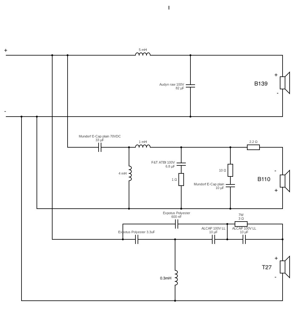

@Eric: Falcon kits are reliable. I rebuilt the crossovers for my Concertos earlier this year but found that they missed the potential of the drivers. That‘s why Falcon and others offer upgrades for this crossover. They need to be installed inside the box though, so a lot of work.
I built an improved version with aB circuit on the original boards. Their orientation (including that of the plugs) must be changed though. Thread link below.

I would use terminal blocks like these:
https://www.farnell.com/datasheets/1509394.pdf
But the homework to find a physically fitting type is for you as my time invested in this thread is in the red area. Phoenix is the brand that produces many 7.5 mm pitch connectors blocks either with push contacts or screw contacts. Both are way better than the original connectors. Phoenix stuff is plated copper and not cheap steel stuff. Also notice that you then have to secure the filter by means of extra standoffs. So the challenge is more mechanical.

Anyway I would keep the schematic by eschendorn in mind when ordering caps. Strangely the caps for the tweeter are bipolar caps of ALCAP fame which I would never use for tweeters. I suspect that the tweeter otherwise is too harsh/loud.
New subject: one could use the best of film caps like NOS MKC or MKP for such small values and do the 47 Ohm 5W metal film resistor trick in parallel to the tweeter. That way the filter works practically the same but the result is better.
Side step: I recall those T27 to going defective very fast. Am I right?
