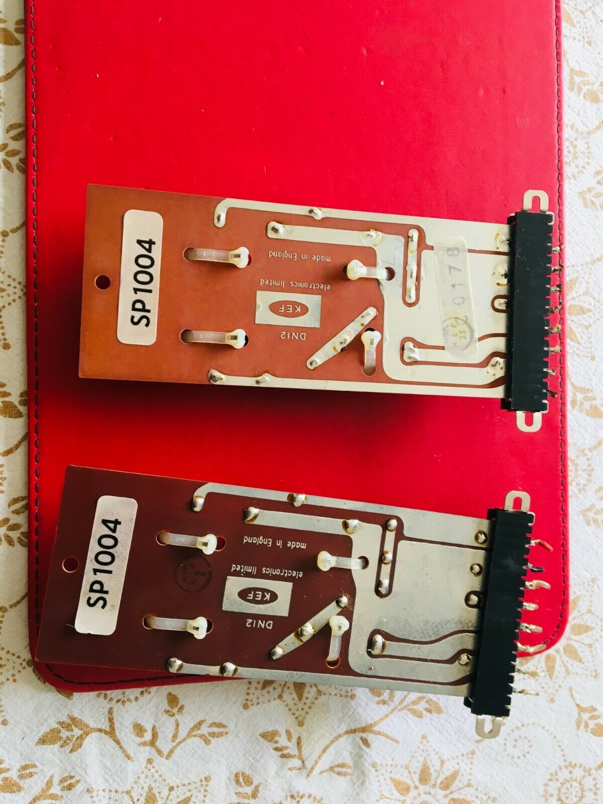

Hello everyone :wave2:
Sometimes 1 of my concertos , did't immediately play at full volume. Only just a little, often crackling sound came out. But after a few minutes, that one concerto then started to play at full volume.
So i thought maybe it could be the bad contacts of the crossover.
So I cleaned the crossover.
When I reassembled the crossover, no sound came out anymore at all...
So I took the crossover from the other concerto, and I placed it in the first concerto.
But the concerto didn't want to play anymore with this ‘new’ crossover either.:irked:
So I placed the crossover back in the other concerto again.
But, now that other concerto didn't want to play anymore either...:scared: Both concertos are dead now...
What could I have done wrong?
I first cleaned the crossover-contacts with IPA (Isopropanol). Also the crossover 'holder'.
Then I sprayed a little Griffon contact spray on the crossover-contacts and the crossover-holder.
Perhaps this can have caused a short circuit?
What do I do now ??? :scratch:
Eric, I see reports that the edge connector contacts become corroded. Perhaps yours are beyond rescuing with the likes of IPA.
Have you considered getting rid of the end connectors and hard wiring the crossover boards?

This is what I dit exactly :
First I cleaned the contacts of the circuit board from CO1 with a toothbrush with IPA. I did the same with the Edge connector.
Then I sprayed Griffon contact spray on the contacts of the circuit board and in the edge connector. I then put CO1 back into speaker SP1.
Result :
SP1 didn't want to play anymore.
Then I extracted CO2 from SP2.
And I put CO2 in SP1.
Result : SP1 still doens't play.
So I put CO2 back into SP2.
But then SP2 would play anymore.
But I did not clean the contacts of CO2.
I have just put CO2 back into SP2.
Maybe that's a little clearer ...
I hate myself for what I did... Only I don't understand what I've done wrong.
I have the Concerto since I was a teenager and I'm now 62 ... and still love their sound.
Meanwhile , I can start my search for 2 other Dn12's (SP1004)...
Or maybe try to repair them first , once I know which parts are broken.

Eric, I didn't say that the contacts could be damaged by IPA - please read my post more carefully.
My guess is that the contacts inside the edge connectors are corroded beyond rescue and that soldering the wires directly to the crossover board may solve your problem.
Please do not rush to the conclusion that you need to buy new crossover boards.
For those unfamiliar with the edge connectors on the Concerto crossovers, here's an image.
