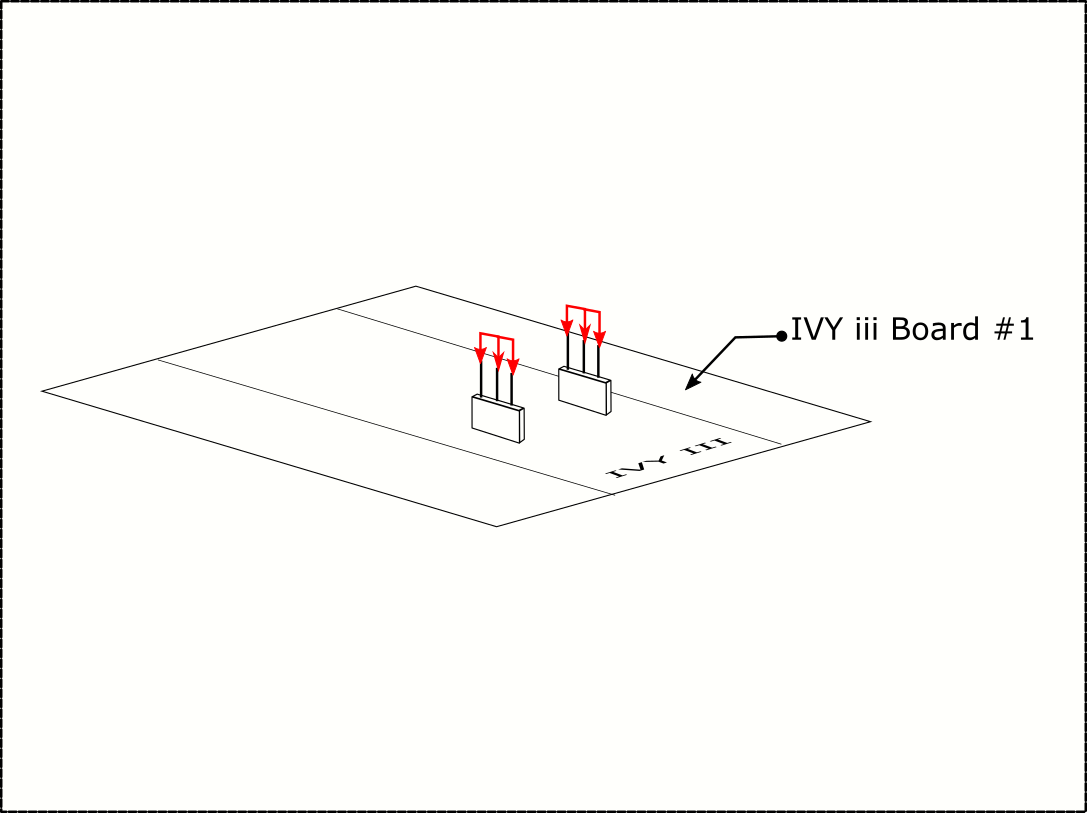

Russ White;5174600 I would test it by removing it from the rest of the circuit and connecting the inputs to GND. [/QUOTE said:Do you mean connecting are the inputs from the B-III as shown?
Yes - while you are testing it separate from the other circuits.
With the inputs connected to Gnd as above and nothing connected, I got these measurement :

With the inputs at ground the outputs should also be very near ground. So something is very wrong... are any of the IC's getting hot? You may need to double check the parts are all in the correct places on the IVY.
The parts should be in the correct places. The DAC has been singing for some years now prior to this. I finally got the tip of my fingers onto the ICs. Yes, they are hot but I do not know how hot should they really be.

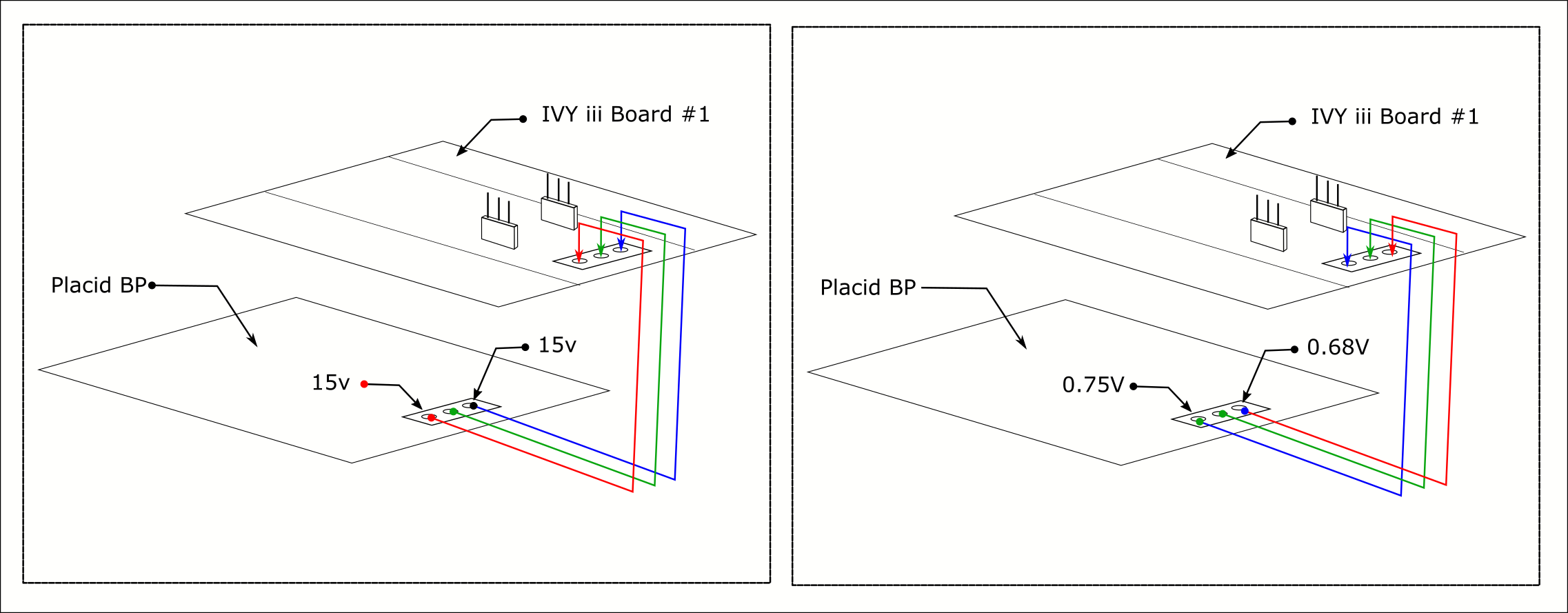

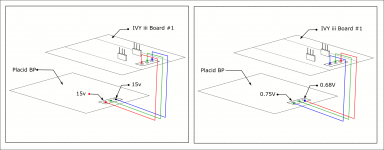

Another thing I did observed is that when I switched the Placid BP from the right output into the left input of the IVY-III and the left output to the right input, the voltage drop right to about 1.5V.
I am not sure what you mean here.... Why are you connecting the power supply to the signal inputs/outputs?
Very bad ....
Oooo! You're showing that you are taking the positive voltage output of the placid and inputting it to the negative power input of the IVY, and the negative placid supply output into the positive power input of the IVY 😱😱😱
That will probably destroy the OPA1632 !
Maybe the drawing will help me explain better,
Oh. ****. Shouldn't the Placid limits the current or voltage?
I don't know. Why not switch the plus & minus voltages to the the way they should be and see if it is ok? Nothing to loose at this point😉. Maybe the gods of audio will smile at you
It was already bad. I switched the power supply around to see if it works. It just got worse. It starts with the missing first second and then I put in another IVY which might have worsen it.
