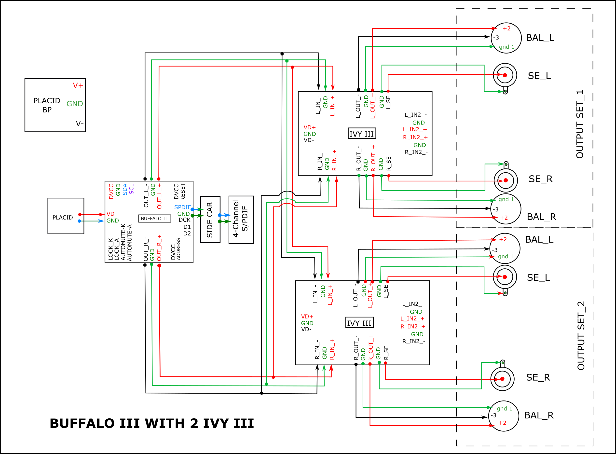

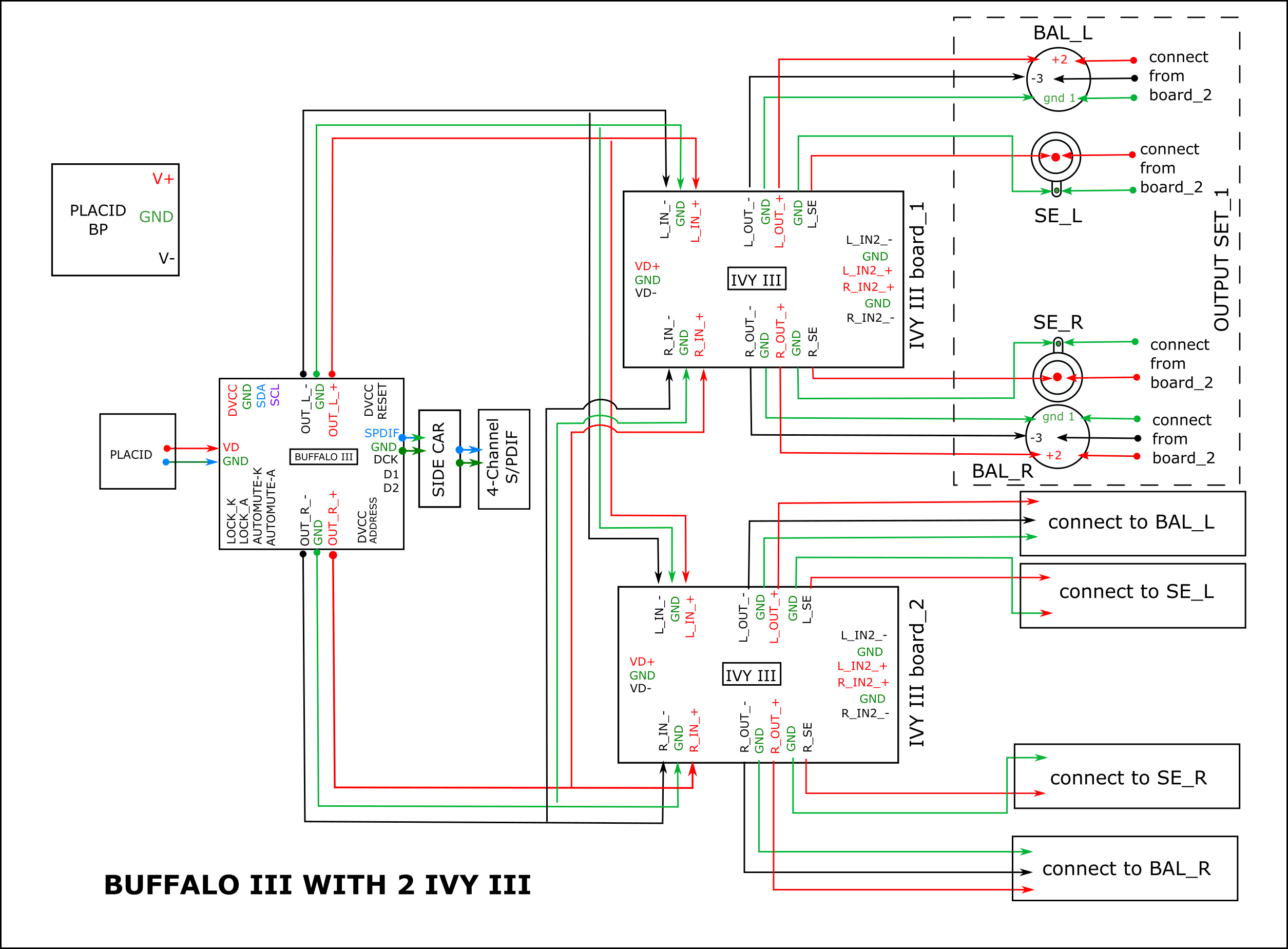

Hi, can I use 2 ivy iii boards for a single B3 dac? What are the benefits of doing so and how it is done? Thank you.
BIII with 2 Ivy III
Is it possible to connect the BIII with 2 IVY III like these?
1) with 2 parallels outputs
2) with 1 output but from 2 IVY outputs

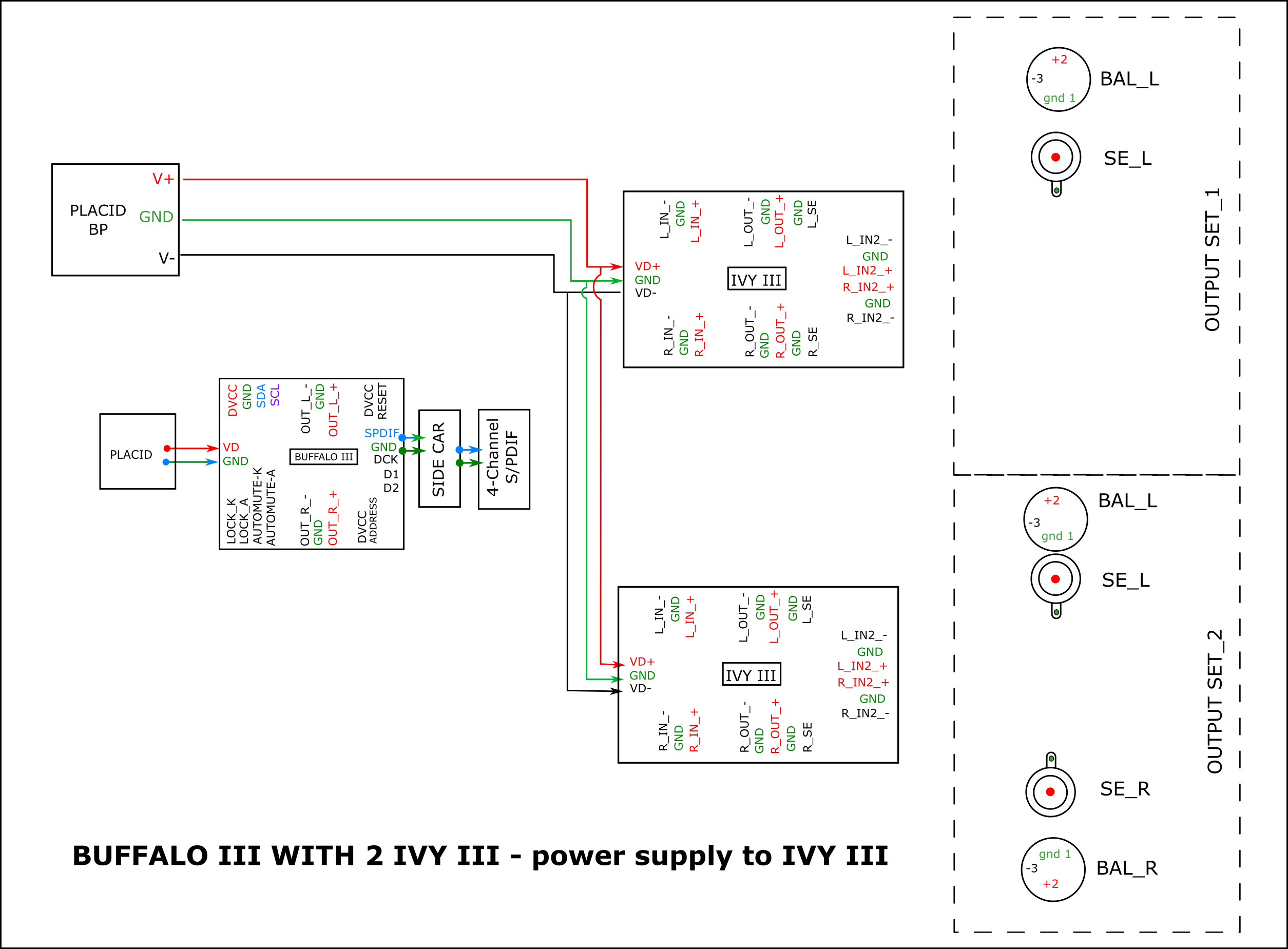

3) parallel power supply from Placid
1) Yes
2) Maybe, but I would not
3) Yes

I am using the Buffalo-III with the four-channelS/PDIF module and the Sidecar. The Sidecar is not connecting to any input but is chained to the 4-channel/S/PDIF module. It is there for future expansion.
Right now I have connected both the IVY3 to the B-III to the same channel as per the drawing.
The problems I encounter :
1) Noise distortion from both speakers. I noticed that the output from the left channel is measured at 0.46V as compared to the 77.5mV from the right channel.
2) CD Transport signal dropping every 5 to 10 seconds. I am using the shigaclone and it has no problem with another DAC. The B-III has no problem with my media player.
3) First one second of signal is lost - eg. for some songs, the first second opening of the song is missing. The BIII just locked in a second late. (This issue is already there before I install the second board.)
Do I need to set any jumpers on the B-III or set the switch position?
Appreciate any suggestions and help.
Thank you.

Yes, all your SE signals will share a common ground.
Why do you want to use two IVY boards in parallel with the same signals?

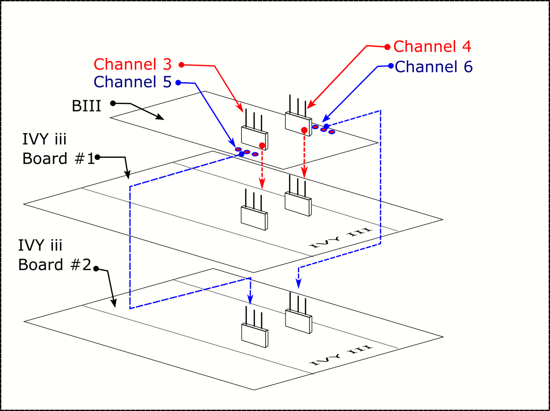

Hi Brian, no, I'm not using 2 IVY's to drive the output in parallel. I am not sure if it will work so I drop that idea. I'm driving 4 pairs of outputs from the 2 IVYs as drawn in the first diagram on the above post.
When one IVY is used, there's no distortion but signal drop from cd transport still occurs. When 2 IVYs are stacked up as shown in the drawing above, the distortion sets in. Do I need to connect the other IVY to another channel on the B-III board?
I do not know why is the very first half to one second lock onto the cd transport's signal is lost and also the dropped signals every 5 to 10 seconds.

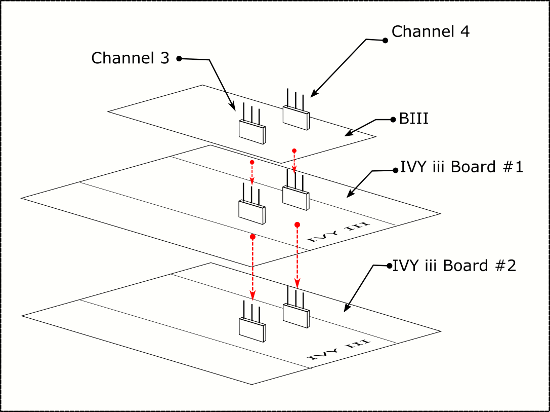

When you connect to IVYs to a single pair of outputs, you are having the available current to each output stage. This is one factor in the distortion.
The additional current draw is likely also causing the dropouts.
I think you would be better off with a single IVY. You should have no problem driving multiple outputs from a single pair of IVY outputs.

I am connecting it to a different channel. Do I need to increase the current on the both Placid HD and BP for the IVYs and also the B-III?
You can check this by measuring the shunt current on the Placids while playing. You will want it to stay above 50mA when under load.

Just the BP currents should need to be be adjusted - watch the shunt current - my guess is you are going to need an additional 150ma or so. Still, you should check both supplies. What firmware are you using?

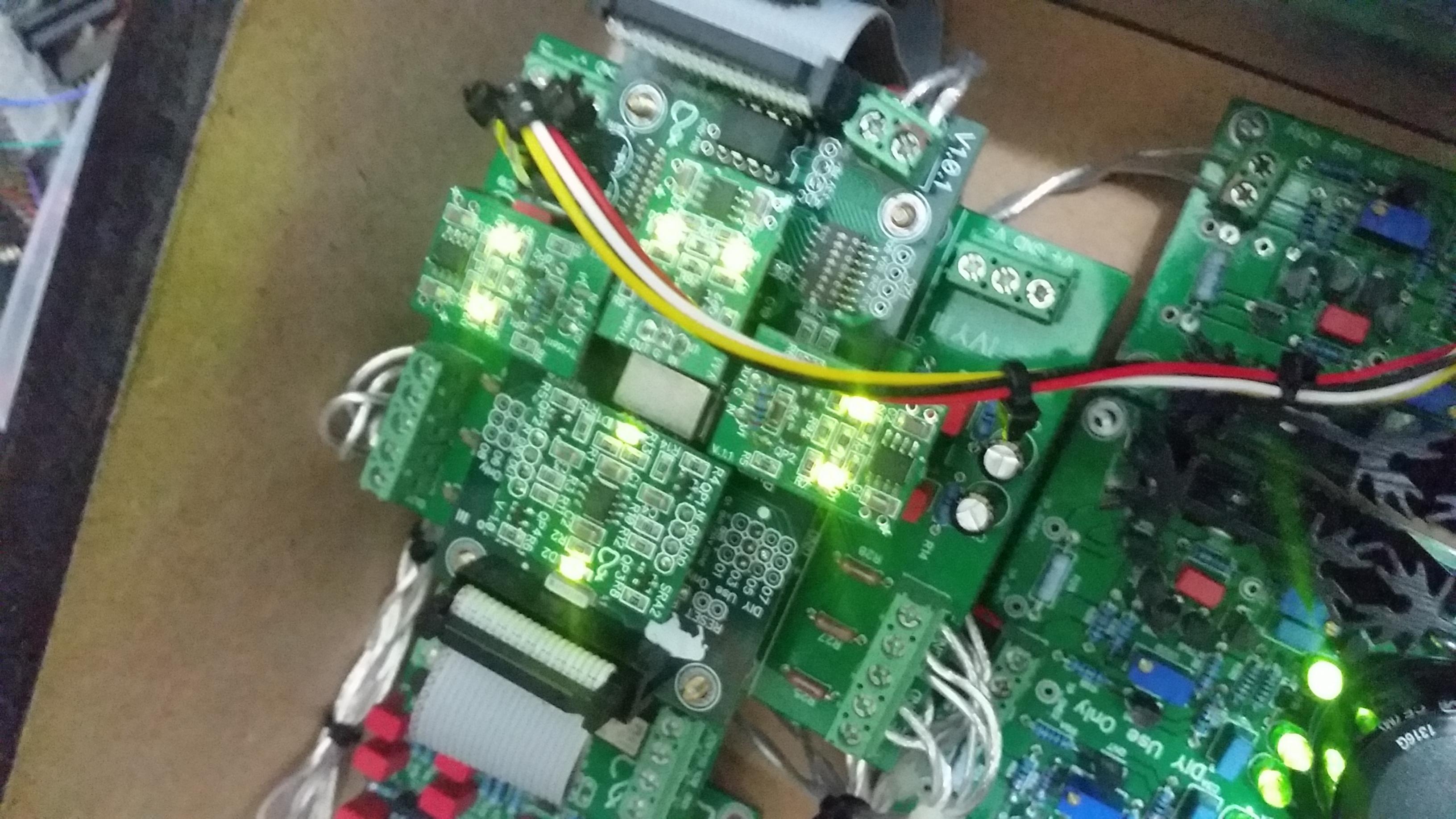

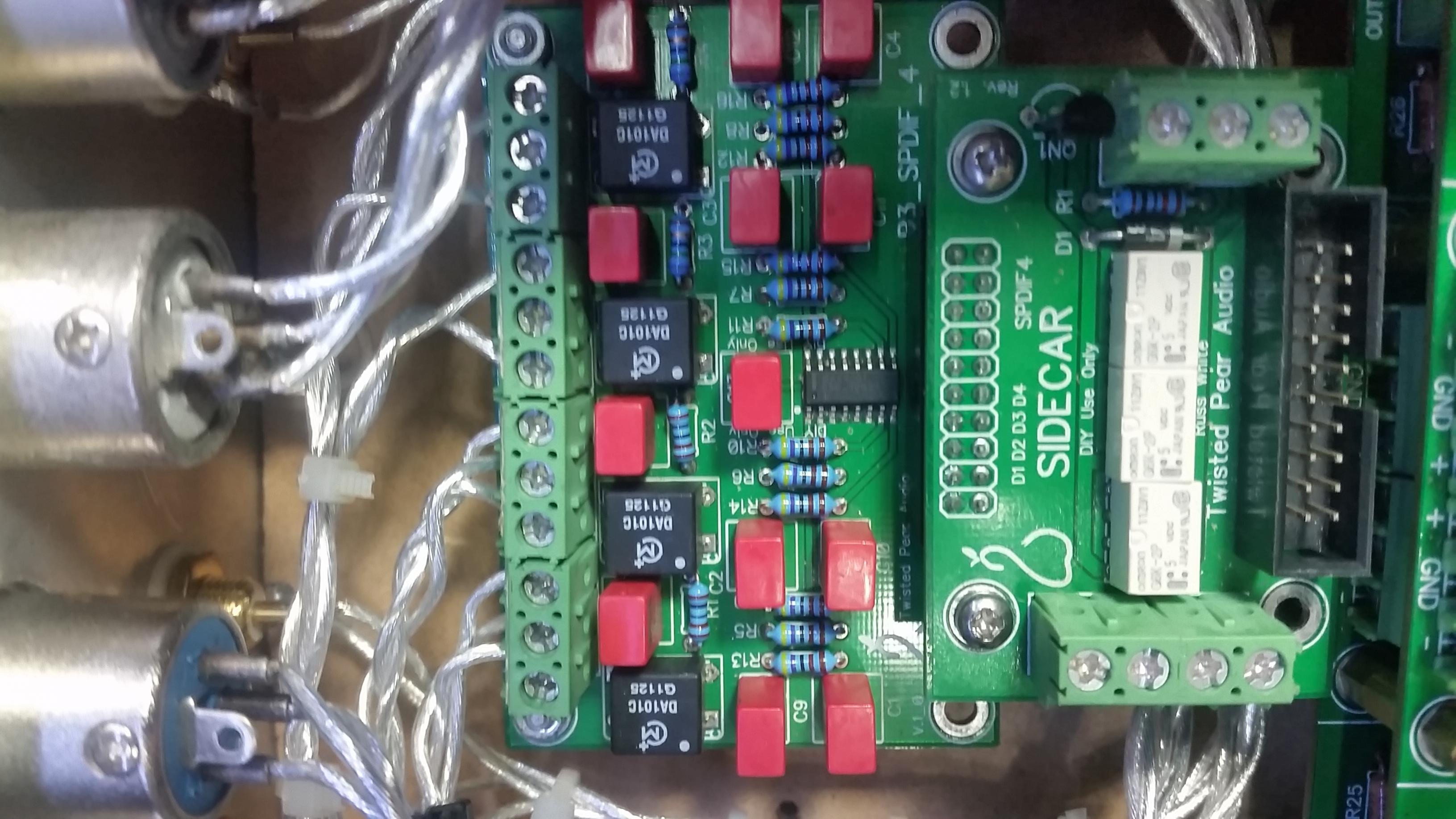

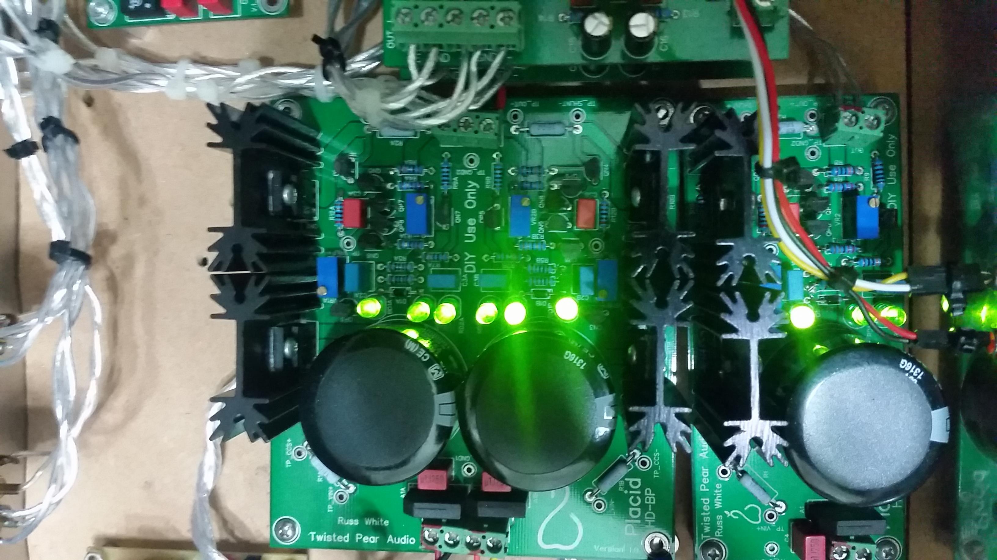

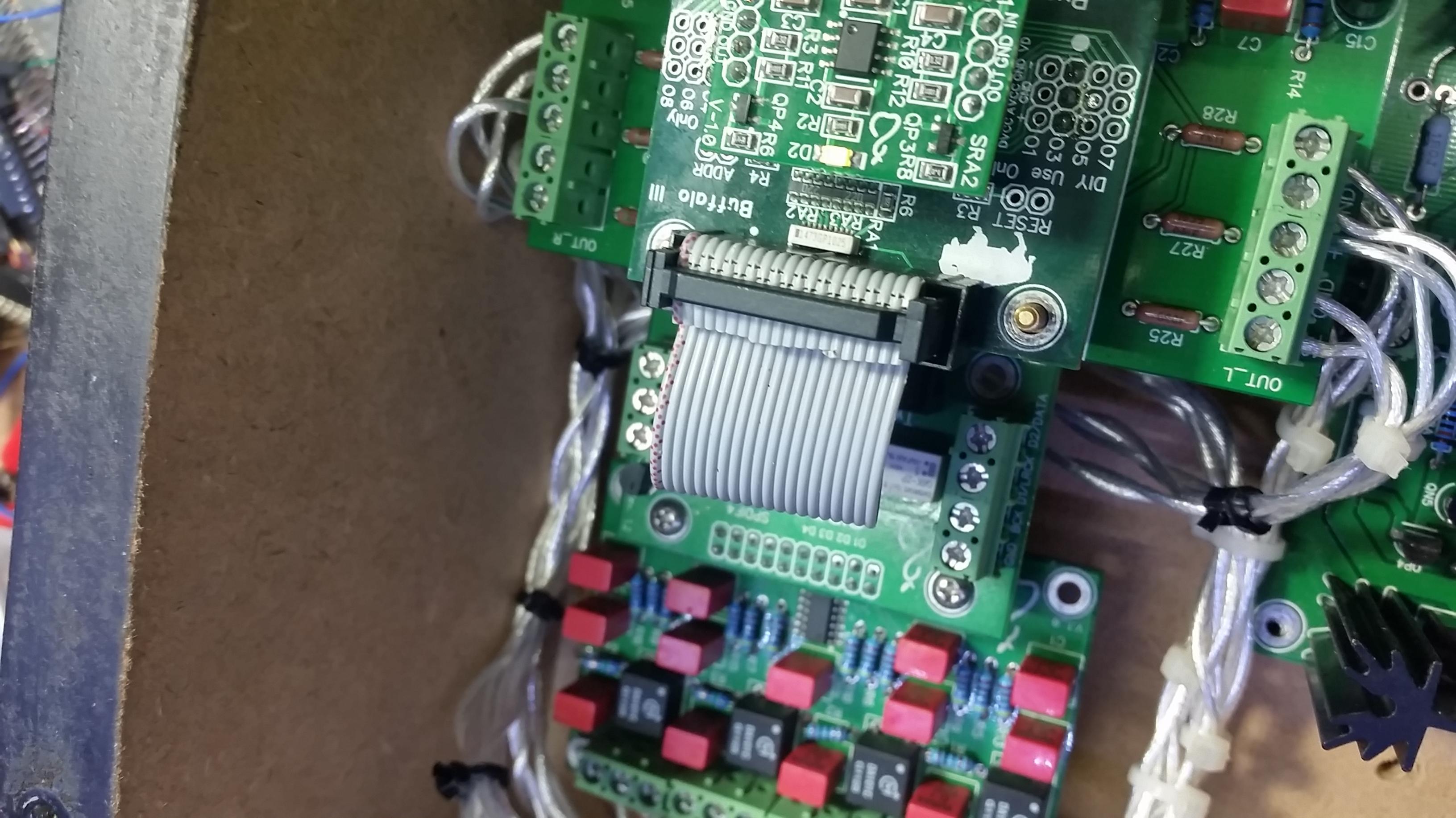

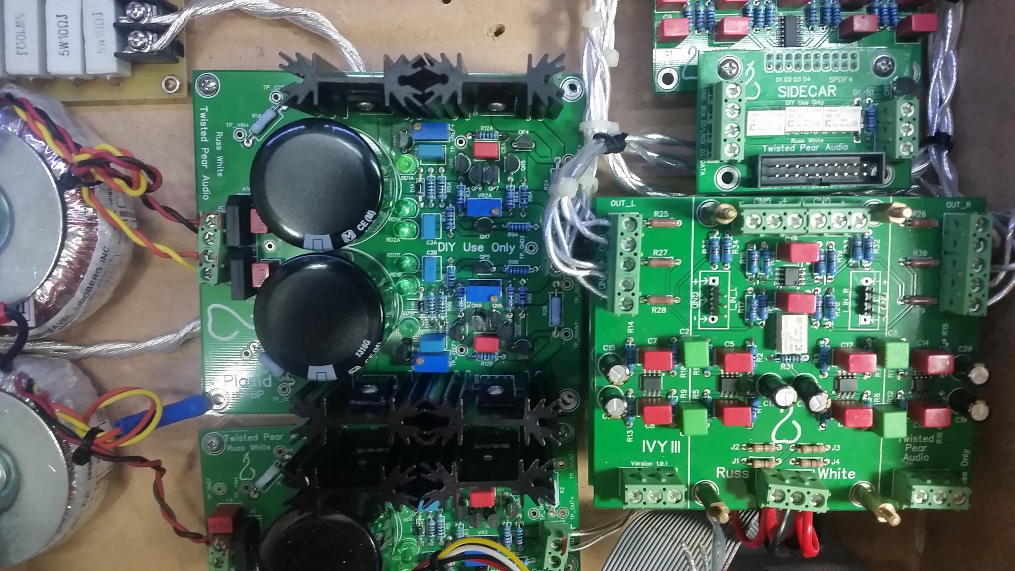

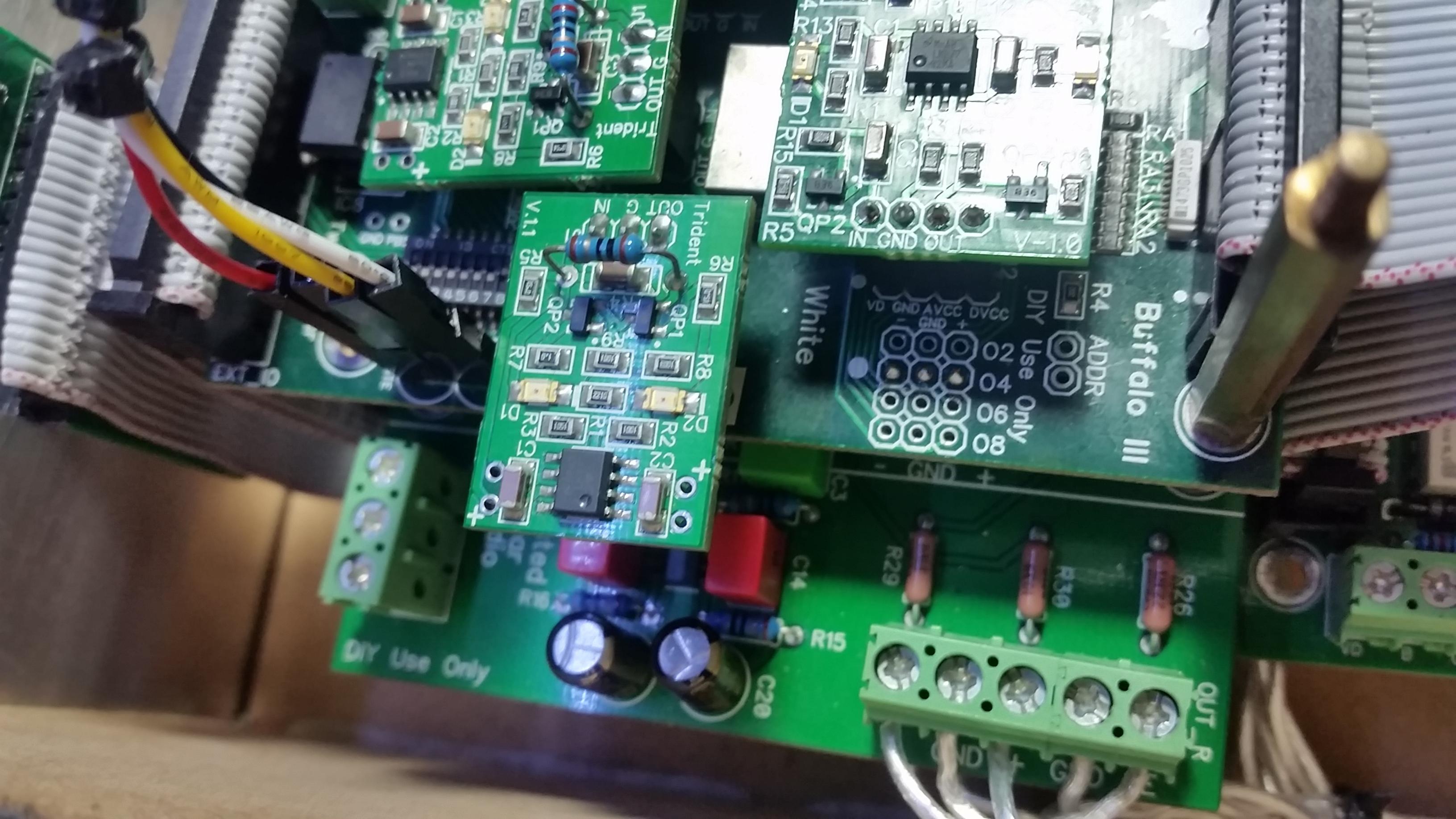

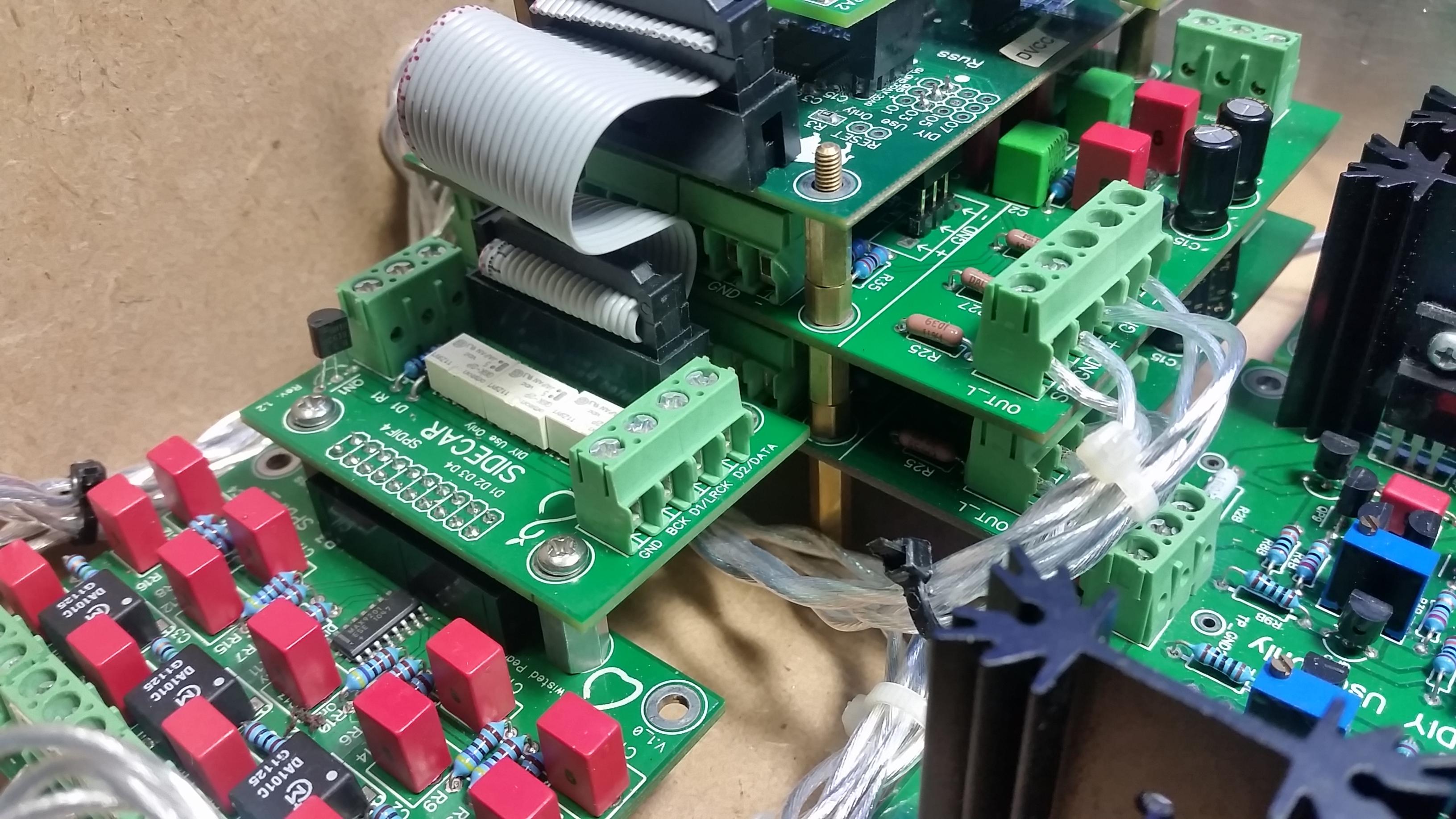

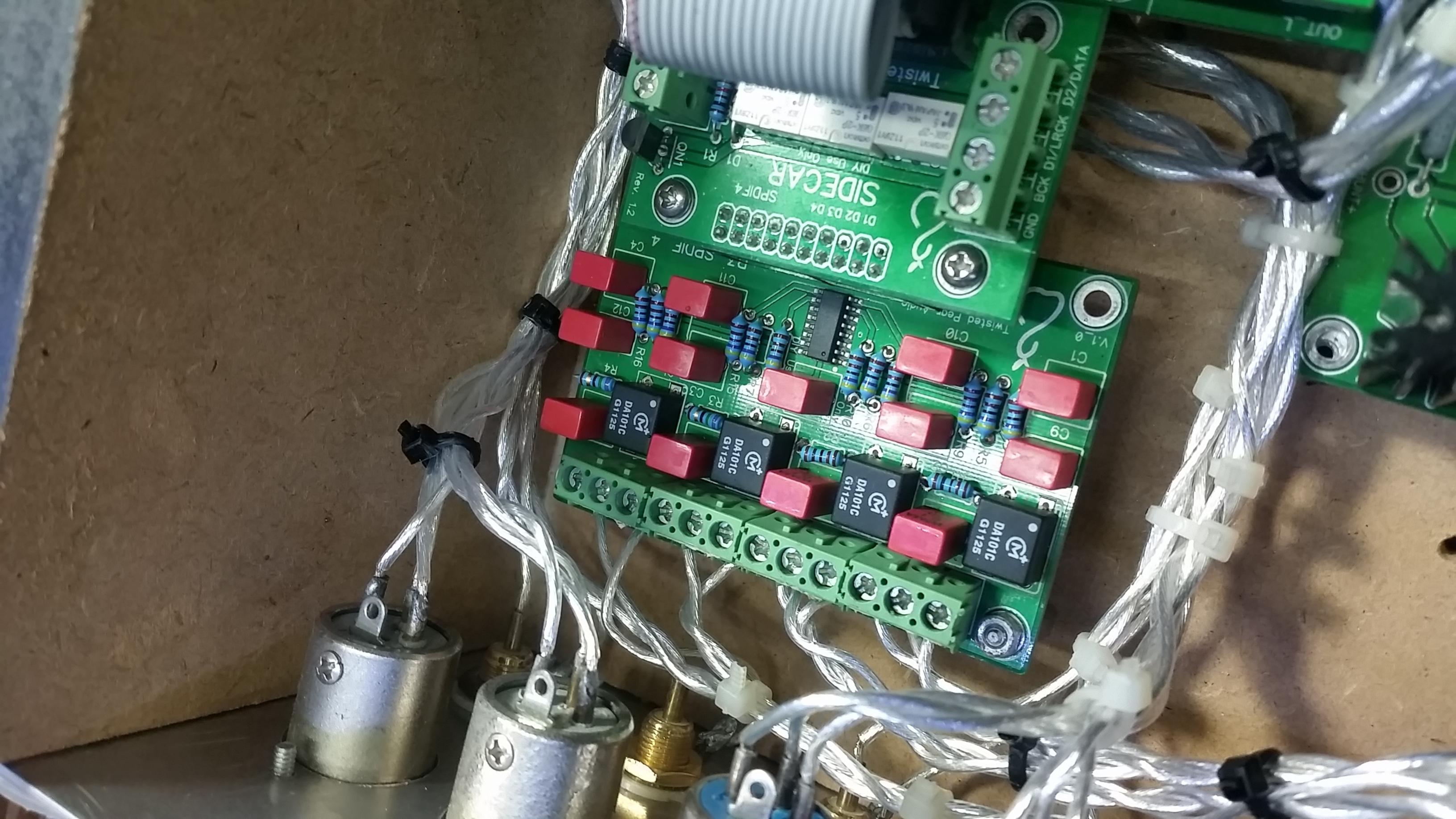

Do you have a picture of of the setup - especially around the sidecar and DAC digital signals.
Please see the pictures. The right channel has no sound.
Ignored the bottom IVY, it is not connected to the B-III.
More pictures.
Another question : How does the 'mute' operate? It seems that when no signal is lock on, the mute Led lights up but as soon as a signal is detected, the 'mute' led is off even if you selected another none signal input.
Thanks again.
Thanks again.
Another view of the boards.
Hmm - it might be time to rule out a problem with the IVY-III...
I would test it by removing it from the rest of the circuit and connecting the inputs to GND. Then power it up with +/- 15V as usual and check all of the outputs. They should be very close to 0V. Also check that none of the ICs are getting overly hot. They will be warm - but should not be hot. If one of the OPA1632 is really hot it will need to be replaced (it likely has an internal short from some damage).
You could also swap out the IVY-III and test the one you have not used yet.
Also it appears you have an unused secondary for your 5V supply. I would carefully (observing polarity/phase) parallel the two secondaries to increase the current available to your placid.
