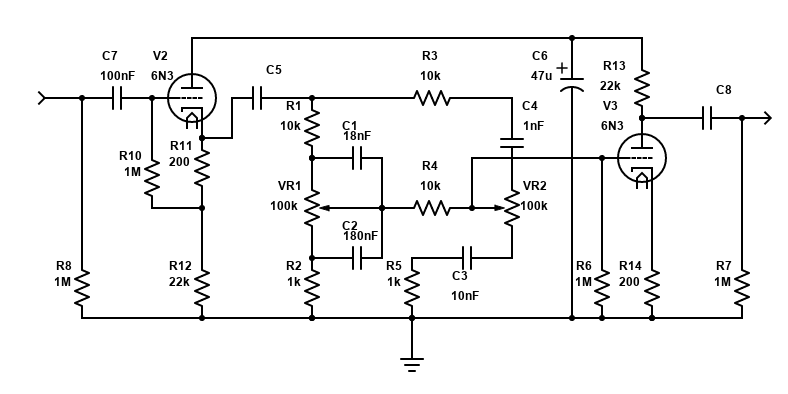

2 gang 100k Log B pot with centre detent unobtainable?

A Baxandall tone network works fine with Linear. A James does not.
The design is James... So apparently I need a log pot that's 30% at half way, rather than the usual 10%
Right now, it's built with linear and works for it's intended purpose - the fact is adds a "loudness" profile is actually a "feature" for the guy I built it for, but for myself I want a flatter response at centre.
I think I have some suitable pots, but they don't have a centre detent.
I have centre detent but they are linear. I've read about making a linear pot log by tying a resistor from pin 2 to 3 of about 1/4 the pot value. Anyone think that would work?
The MN taper pot works well for a balance control but not for a James. If it has a centre detent I might just grab a couple for balance though.
Why?
With due respect, if that happens, then top/bottom caps and resistors or Bass control capacitors are poorly chosen.
They also need to follow the 10:1 impedance ratio.
If you reached final values "by ear" , ok, you (or Customer) like them that way, but only by chance will meet the classic design.

With respect, using Duncans Tone Stack Calculator, the James topology uses Log B pots which are described as having 30% at 1/2 way in the software. It looks like James but it has an extra 10k resistor (R3). B+ is not marked but it's 250V, and the tubes are 6N1. C5 is 100nF
The circuit I built is attached...

Ok. I think the Log B and Log A are backwards in my head or the help file I saw referenced online - my "help" doesn't work... I set the controls to linear and it's flat when the pot is at the 10% mark. JMF was right, I just need a "normal" audio pot and I found it.

.....using Duncans Tone Stack Calculator, ...
I tried to find that before, and failed. After a nap, I found it in a few minutes.
"Linear uses a linear track where the resistance is in proportion to rotation of the potentiometer. Log A has 30% of the full value at half-way position, and Log B has 10% of the full value at half-way position."
I don't think Bax is "more pro". Excellent results are possible. More than 20dB "boost" (yes, an un-cut) makes little sense with <6dB/oct slopes. It tends to interact in the midrange but not a lot of dB. It is asymmetrical boost/cut but why must they be the same? And can't the user find a best fit? The "flaw" is the poor tolerance of tapered pots. In mono I have tinkered the passive parts to get flat at centered. Doing that in stereo is more than 4X harder. A Bax even with 20% *tolerance* (not taper) pots tends to wind up within a dB at "center". Which is never quite mechanical center, so if you truly need "flat" you switch-out.
Thanks for that, PRR. I knew I must have it wrong...
