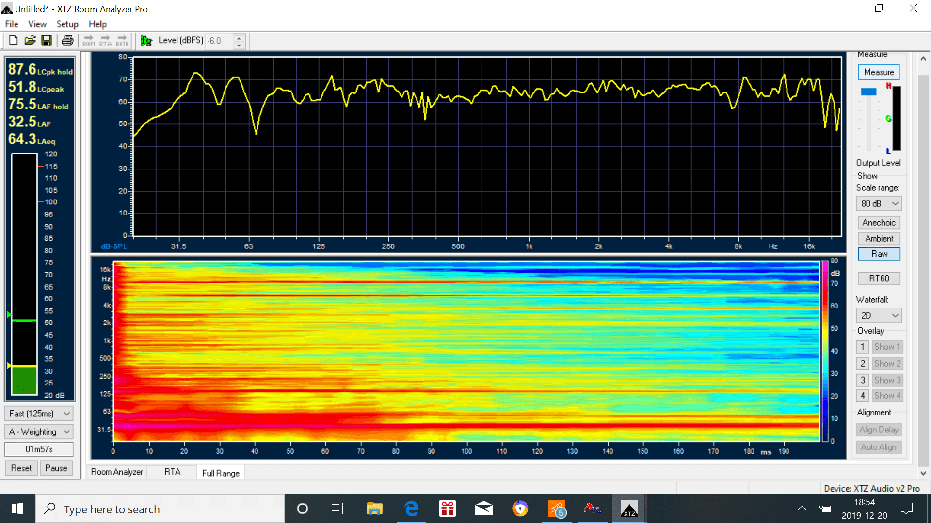

Yeah, this was a problem and why in recent decades accepted that they would need to be strictly 1 WL long conical WGs for 'FR', co/tri-ax for best overall performance.Above graph was knocked down 12db, x-over at 350Hz. I tried to boost treble above 7kHz, but the driver was not able to push through the horn. Bare driver, yes!

are you suuuuure....A mere 2.5cm path difference will result in large cancellation at ~7kHz

No, it's "normal" driver. There's no dip around 7-8kHz, no cancelation as always are mentioned without phase plug?Indeed! A custom driver?

Well that's what physics would tell you (assuming there is no phase plug or some-such to alter path lengths). Just for fun, I tried it several years ago and got exactly the response one would have expected. That said, subjectively it didn't sound bad. Without a direct comparison to actual flat response the ear/brain is surprisingly tolerant.are you suuuuure....
I only tested it in the horn and on unfiltered 1m wide baffle in room. There are plans to make a wave guide + try it on a flat baffle with a 12 inch😱) But the measurements from HobbyHifi promised a good result...Hello,
