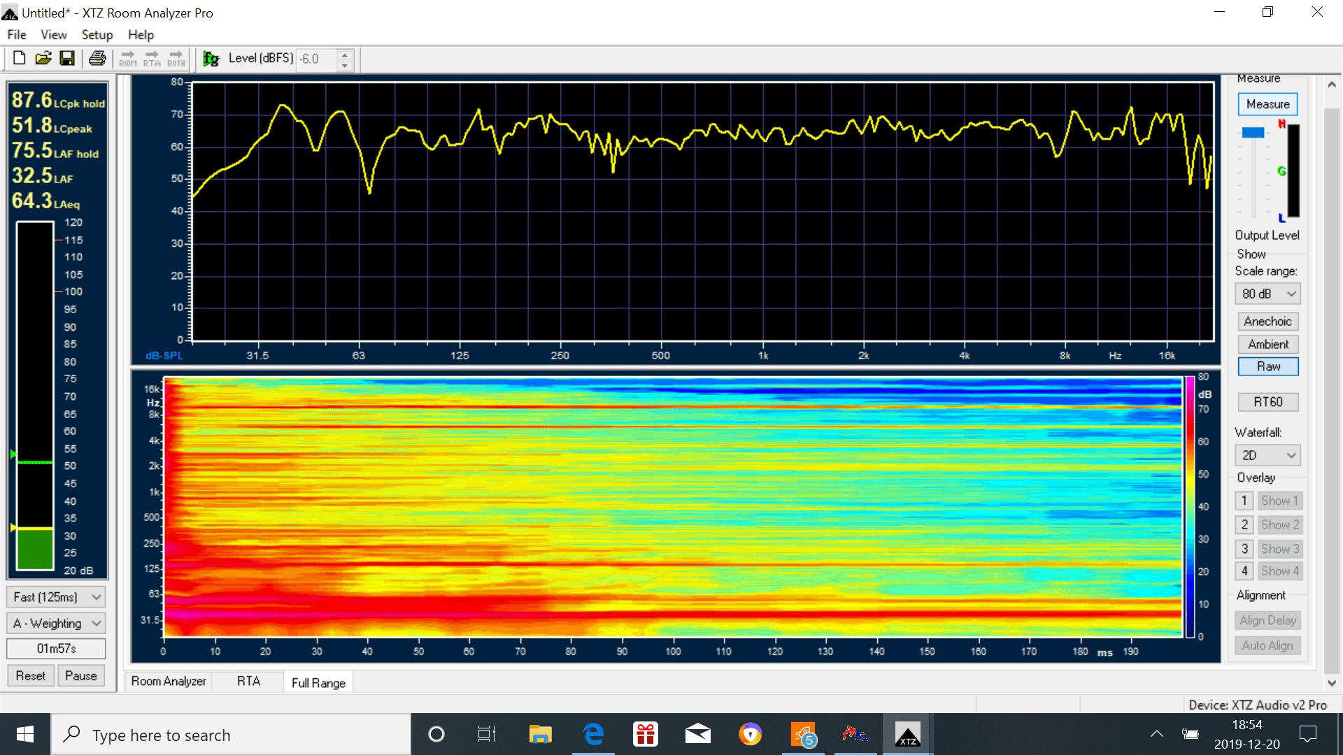

Above graph was knocked down 12db, x-over at 350Hz. I tried to boost treble above 7kHz, but the driver was not able to push through the horn. Bare driver, yes!
