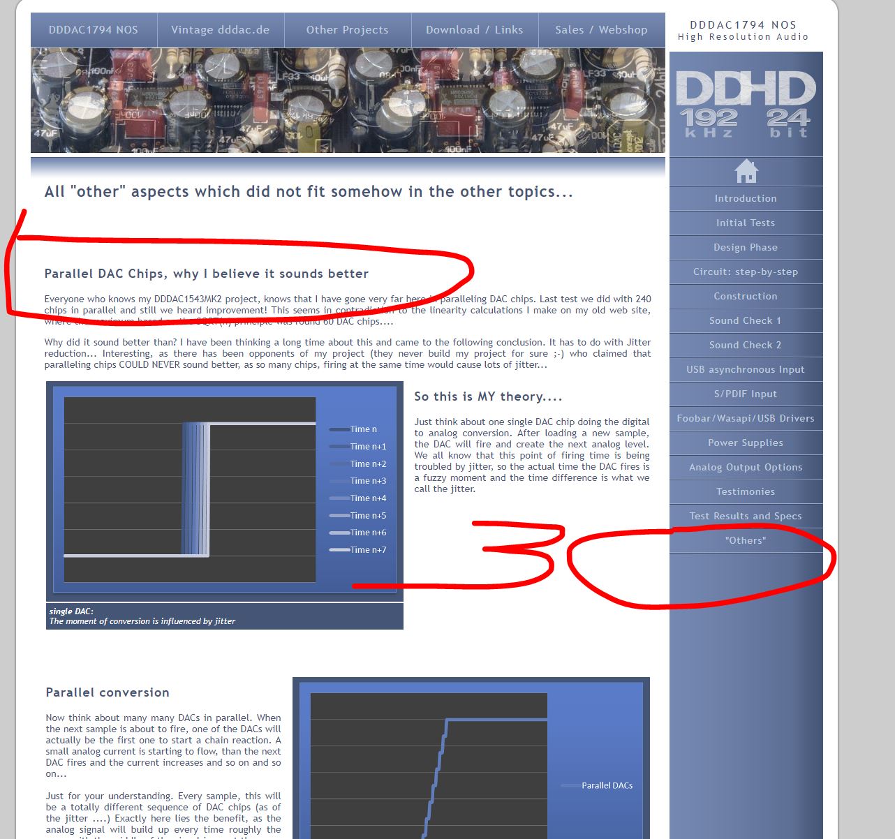

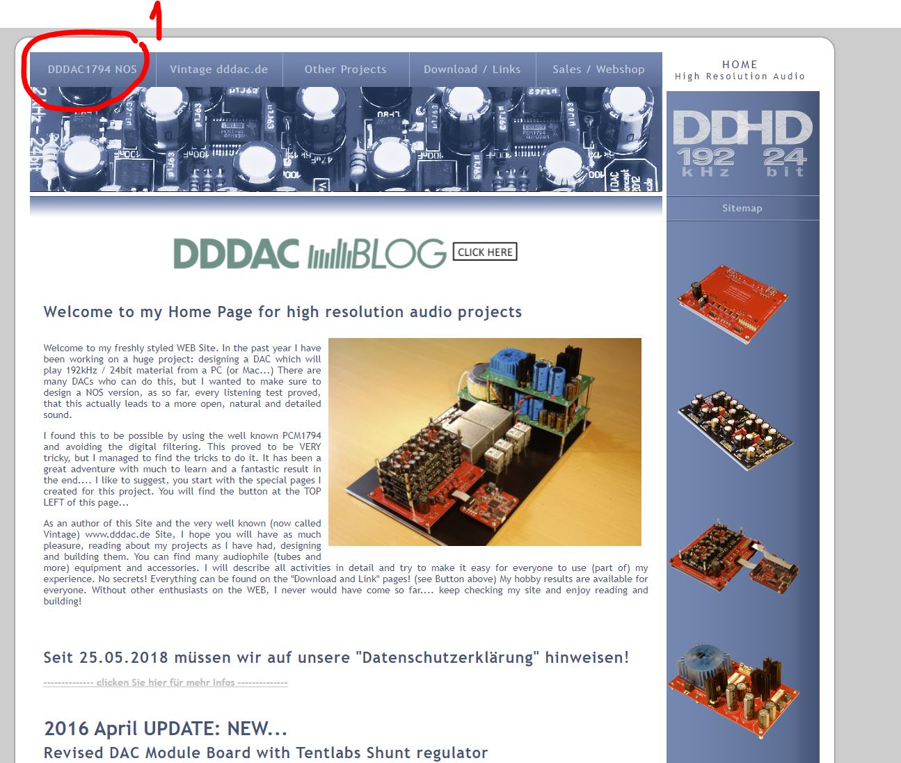

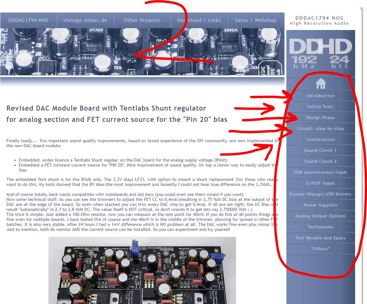

read my website on the DDDAC1794 and you will have all background on mono mode, and what parallel DACs really bring. The S/N ration is of no importance by the way...
www.dddac.com
are you kidding me Serge? The site is full with detailed technical information and I explain all design steps in detail. Also my idea of why paralleling dac chips is beneficial... You must follow the links and there is also a site map
ok I made a step 1 to 3 help screenshots below.... hope it will work for you now?
Doede
