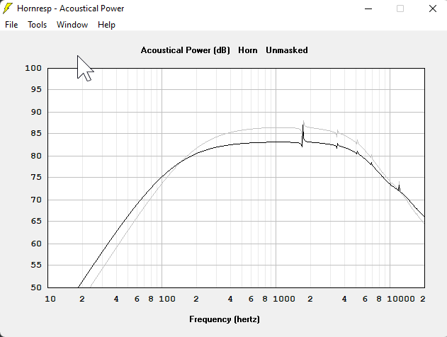

I was a bit suspicious that the Audible Physics driver really has an efficiency of 87dB, since it's so small, but I plugged the specs into Hornresp and it checks out. The attached sim shows the response of the Dayton ND64-16 versus the AP.

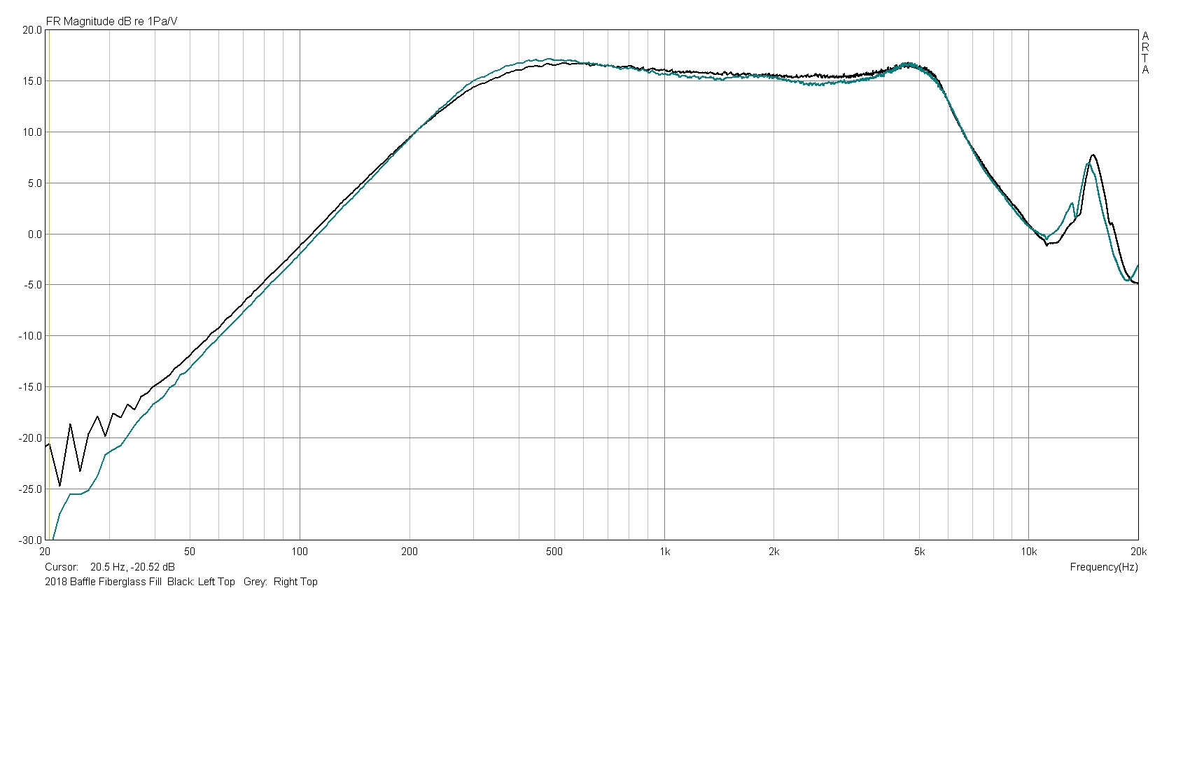

The SPL per watt on Aurasound whisper is lower than you desire, so maybe use two of them. Stacked vertically, two would give you the constrained vertical dispersion you want.
They are very low distortion and have a very flat response if you use the correct enclosure. They run down to 500Hz just fine with good Xmax. I hot glue a 1.5" ID pipe 6 inches long or more tightly stuffed with fiberglass to the back and get excellent results. Without the pipe enclosure they have a peak in the response around 1,500 Hz. https://www.parts-express.com/Aurasound-NSW2-326-8AT-Whisper-2-Extended-Range-Driver-296-252 I attached the response I measured from two drivers mounted in a baffle. I don't know of a driver that has a flatter response than these. At listening levels I have measured the distortion, and it is down 50 dB. Linkwitz used this driver in the Pluto design. It looks like I had a low pass filter connected when I made this measurement, as the driver has extended high end response above 15 kHz. You will quickly find that 2" drivers with a higher SPL per watt achieved that sensitivity by having a near zero Xmax. So the distortion of these higher SPL drivers will be high at the low end of their frequency range.
