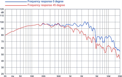

usually a 2*10" or 2*12" will outperform a 1*15" design. E.G
15FH520: 98dB/1W, AES power = 600W, 126dB
10HP1020: 96dB, AES power = 700w, 124dB
but then 2*10HP1020 = 124dB+6dB = 130dB
Furthermore the 2*10" design will be able to cope with a higher crossover frequency while mentaining wide horizontal dispersion. A higher crossover frequency is a good thing for the compresion driver! (PA levels with an 800Hz crossover need a large expensive compresion driver, 3-4" dome/large anular ring).

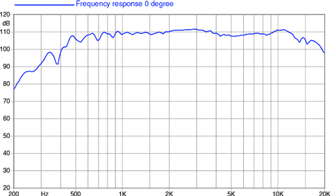

Compresion driver datasheets are not the most informative things in the world as they typicaly only include measurments on one horn which strongly influences the frequency response. For example the HF146 is measured on a horn with collapsing HF directivity, this concentrates more power on axis making the high end of the response look more efficient. HF146 has a 2.65" diameter polymer dome so I would expect low frequency perfomance between a small format and a large format compresion driver and a 'smooth' sound due to the good damping of breakup but the sound to deteriorate at high power levels due to polymer softening. Here is the voice coil reveiw: https://audioxpress.com/article/tes...ession-driver-coupled-with-lth142-60-o50-horn
from faital I like the look of the HF1440: https://faitalpro.com/en/products/HF_Drivers/product_details/index.php?id=502020185 its an anular ring driver so the phase plug isn't as limiting for excursion as a dome driver however it has less surface area, even smoother though.

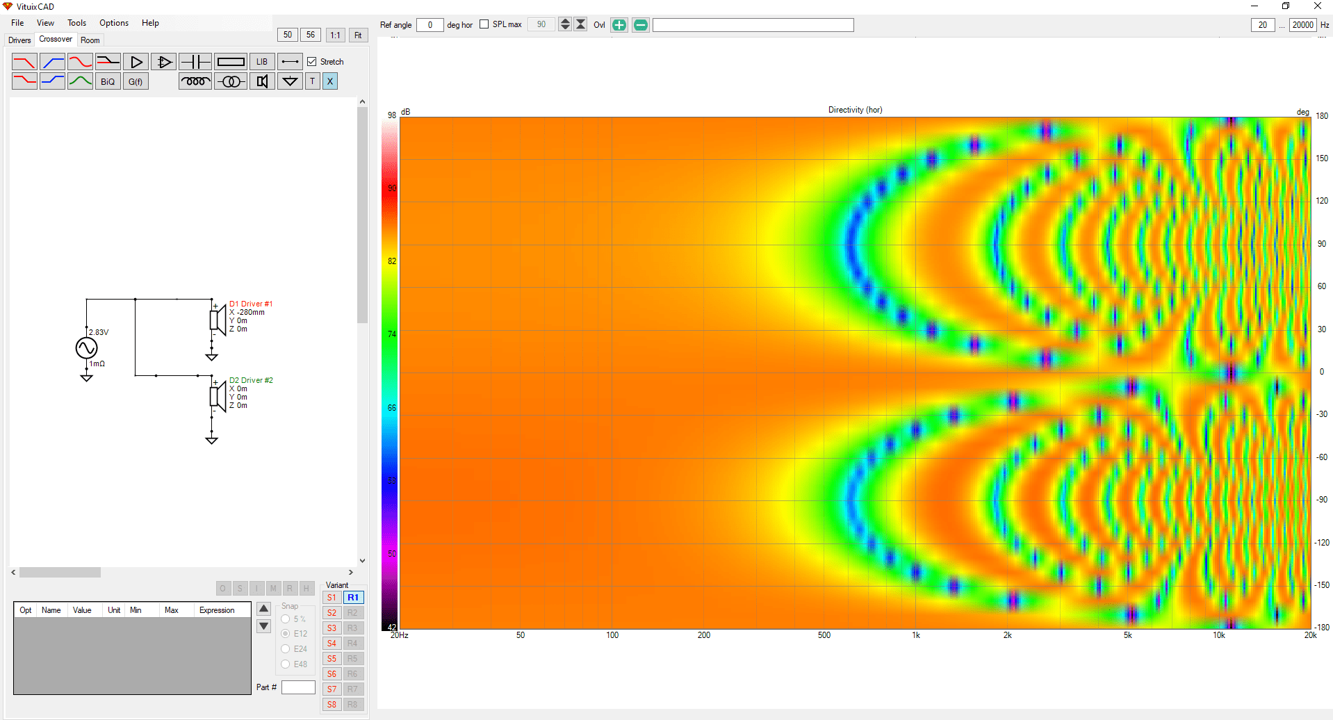

You would expect some narrowing of the vertical radiation pattern from a dual 10" config near the crossover frequency. This could be advantageous though to increase the direct to reverberant ratio in reflective rooms. You can model this in virtuaxcad.

easy to model the effect of spaced drivers. a double 10" config looks to be about 60 degree vertical at 750 Hz and 40 degree at 1050 Hz. Crossing at 1050Hz to a 90x40 1.4" throat waveguide would work. Perhaps this: https://www.rcf.it/en/products/prod...tlet_ProductDownloadsPortlet_profileId=241603 HF94
